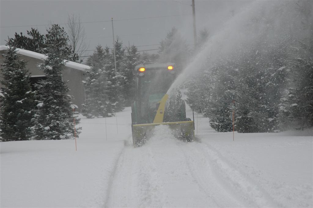

I finally got a chance to try out the tractor after the dealer fixed the roof seal. Wow, what a difference! After a 15 minute warm up at 1,500 rpm I ran it up to 2,700 and started to blow snow, within 5 minutes I had my jacket off and was turning the heat down. I am now a very happy camper.

Good picture. Looks like your blowing the snow in the next county.
