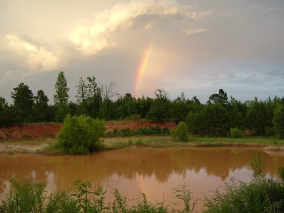

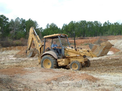

   / Ponds? #32
Did you say three "DAYS" to dig out all that dirt? Your website says three "years." My big pond is similar in size and it took me a month to dig mine with my backhoe. Hauling the dirt off took most of the time.

I'm not being clear again.
It was three years for the whole pond. Only digging in dry weather, and between breakdowns.
Three days work with the frontend loader to haul off the dirt from one afternoon's digging with the backhoe. Two wheel drive backhoe with front bucket full in swamp bottom makes slow going. Often would have to wait several days for the spoil to drain before I could work with it at all.

I understand. The digging part is the easy part. Moving all that material is what hurts. Especially when it's wet! You did a great job on the pond and I admire your determination!!!!
Muddy colored water might also be caused by the electrical charge of the water. I forget now if it's positive or negative, but the eclectrical charge will suspend dust particles in your water and it could take years to clear up. The article I read in Pond Boss Magazine said to use "gypsum."
Gypsum is what sheetrock is made of and can be bought in bulk powder form at fertalizer suppliers and some feed stores. They recomended starting out with one ton per surface acre. You must use the powdered stuff, but scrap pieces of sheetrock also work, and mix it into your pond.
Throwing it out the back of an outboard boat with the motor running mixes it all up really good. Or so the article said.
I'm waiting for spring, then I'm going to do it the hard way. Put it on a raft and mix it in while swimming around.

<font color="blue"> scrap pieces of sheetrock also work, </font>
I read in pond lit that drywall has fibers that get in fish gills and isn't good. Said only to use ag gypsum to clear ponds. I think it raises PH also if I remember correctly.
