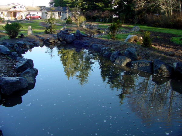

Sparkkky,
I did a job for a neighbor a couple summers ago. It started out as a small favor and ended up being 2 ponds with a 150' stream (with a fork) connecting them. Both ponds are small, and I do have a BH, but most of the work was done with the FEL. It was in hard clay and would have been impossible without a toothbar. For rough excavation, the FEL seems to work fine. I use my BH for the more precise work. I was able to create the exact shapes that the landscaper was calling for with the BH. It would have been possible with the FEL, but not quite as clean and precise a shape. I have attached a photo of the upper pond. I have a few more photos if your interested. They have landscaped this whole area since these pictures were taken and it really is beautiful.
Greg
