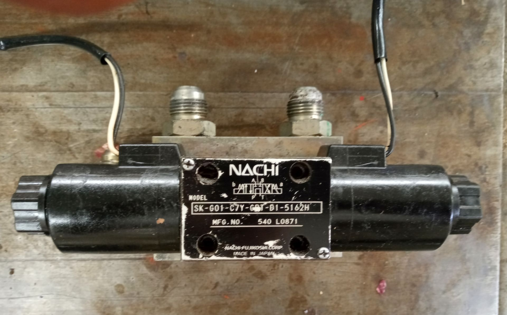

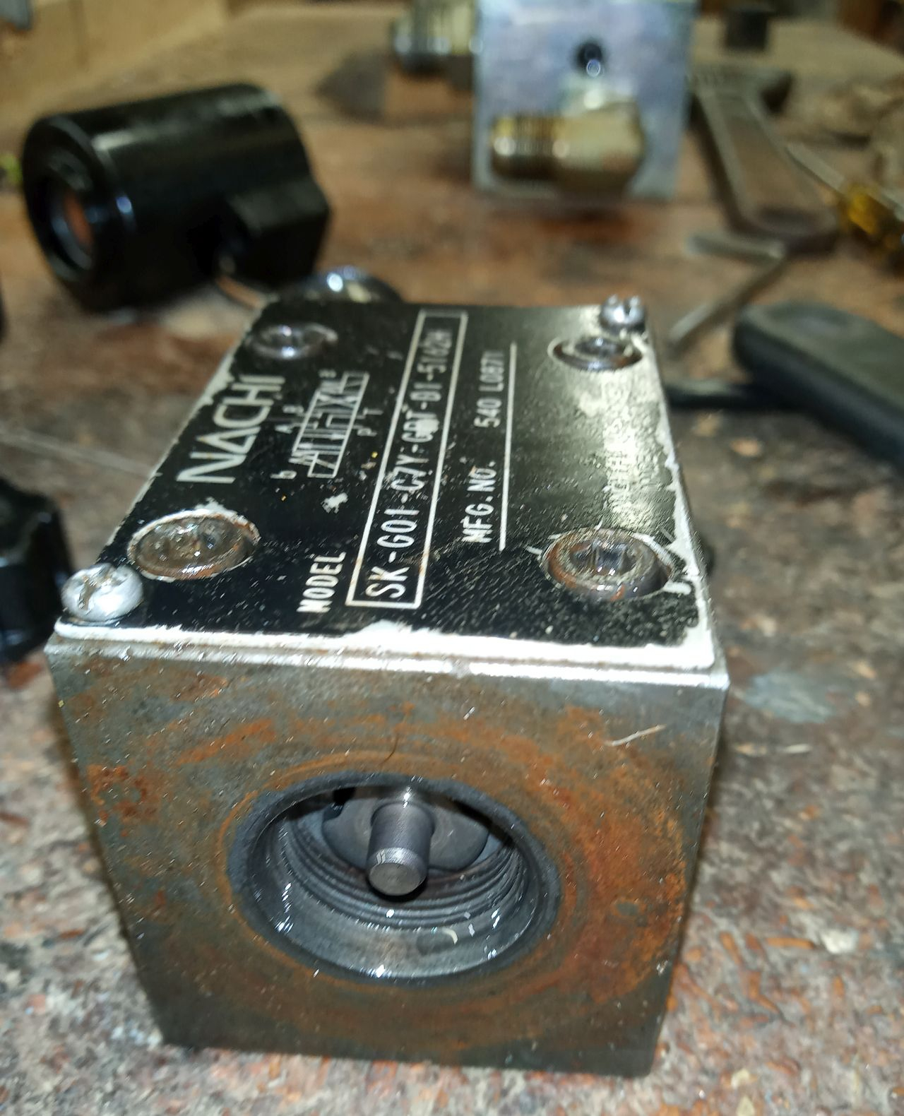

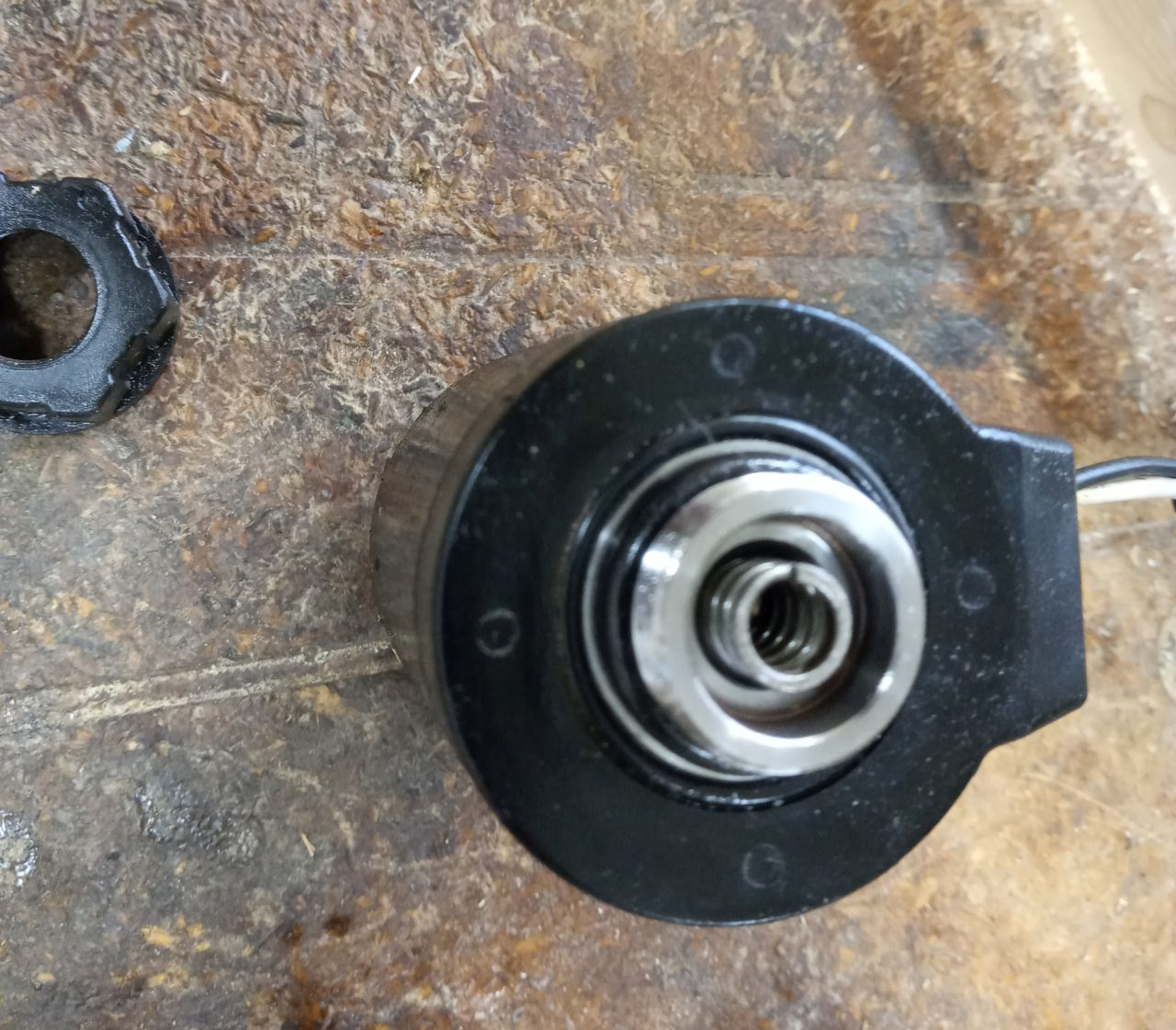

TLB's work well with a grapple as they have some weight to counterbalance the load Really needed to get the diverter valve off my tractor so I can get the Grapple working. I'm too old to remove it myself. Fitting were stuck. Ordered new valve. Lots of brush and stumps to clear.
  • L39FrontDiverter (Schmatic Assy with Nachi P-SK-G01-C7Y-GPT-D1-5162H).pdf

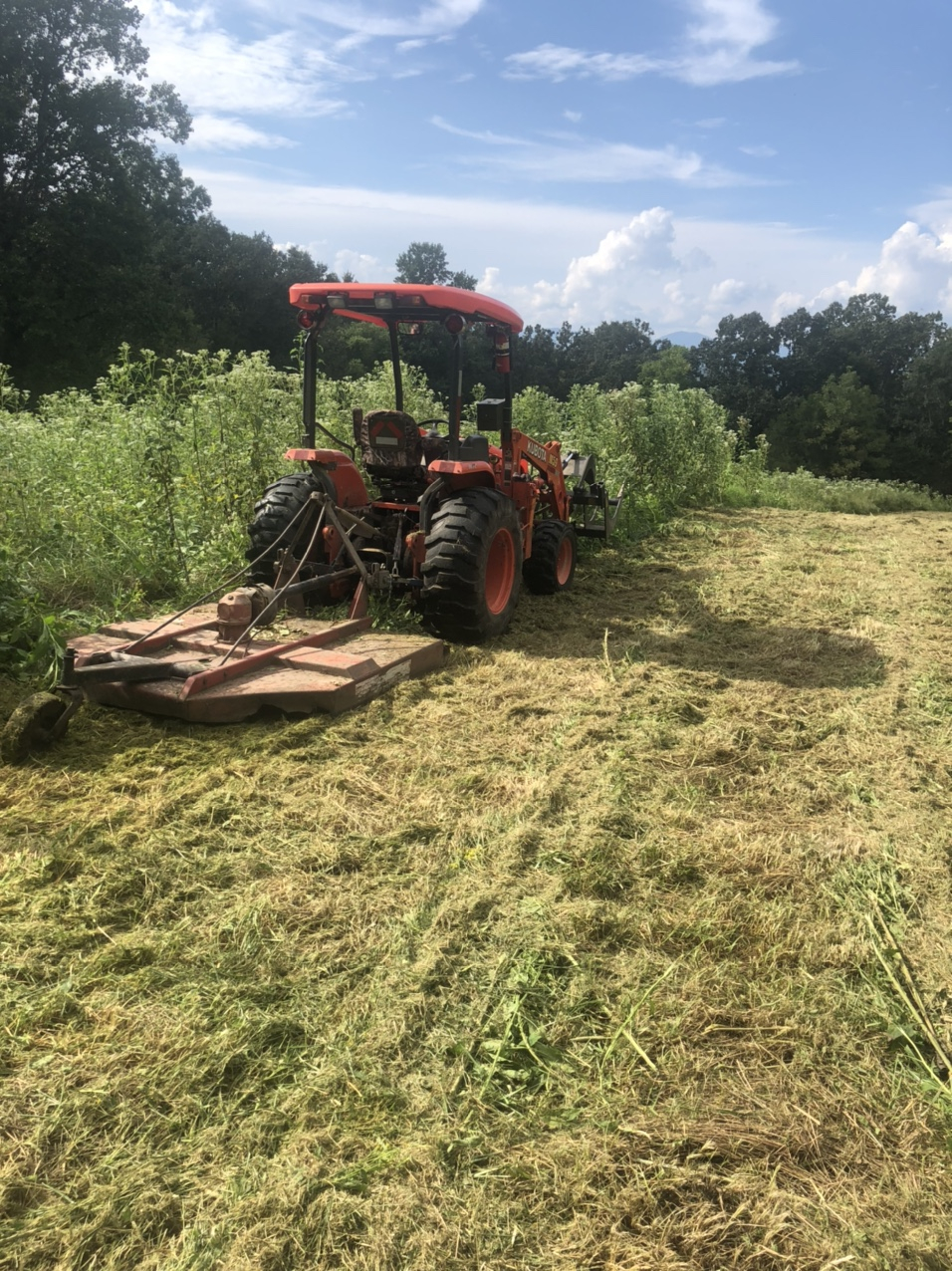

Been doing the usual annual fall bush hogging with the M59. Have used many different tractors over a span of almost 50 years on the same now fallowed pasture. Lots of rain and hot weather this year has thick growth. Was worried about how well an HST tractor could handle this task compared to the larger gear tractors of the past. With the many ups, downs, side hills, trees, dips and bumps it’s exceeded my expectations. Especially in high hazards, tight, steep banks and terraces. Having the optimum speed and power easily controlled while negotiating obstacles improves cutting performance and safety. Hate to use age as a crutch but it’s just kinder on us older folks. Don’t have big flat fields. Bunch of hilly small tree lined patches and meadows. Four post ROPS does a good job of protection from branches. Biggest con is it does like more fuel.
Added an override pto clutch this year. Needed a little length for the rototiller drive shaft. The added length from the tractor side also makes connecting the pto easier. With the bush hog hear it clicking when disengaging the pto or reducing rpm’s.
The hawks watch me mow, snagging meals from the freshly cut field. Turkeys like the bounty of bugs and seeds. Owls happy. Coyotes singing approval at 4am this morning. Once the leaves fall watch herds of deer graze on the grass from the house.
