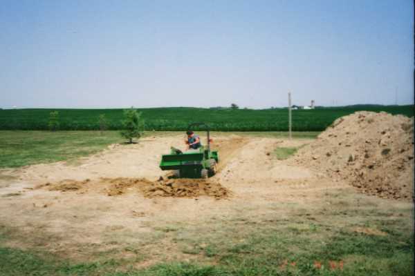

Update

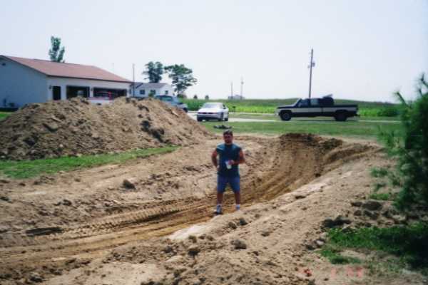

Getting close

Might need to adjust the runoff tile a little lower!

Steve, I'm impressed... Looks like you are putting in a good effort and it's paying off. I do have a question... What is your soil like? I have all hardpan here and while I may have a bit larger tractor, it looks to me like your soil may be a bit more agreeable to your efforts.
   / Pond
#19
Thanks EagleEye.
My dirt is mostly clay. It had not rained in over a month so it would crumble decent. I would use the BB with the scarifers all the way down and box tilted forward to be able to get a load. When I first started that would take way to much bite and stop my tractor. But, after the first six inches or so it was a lot tougher. Without the scarifers down it would hardly get any dirt loose at all.

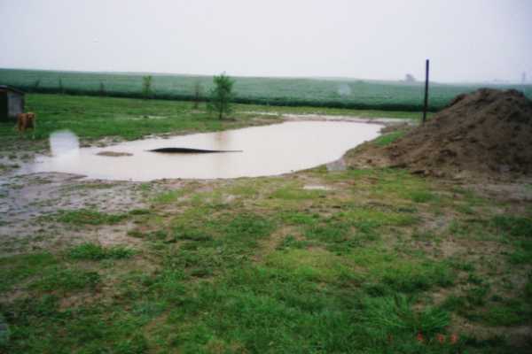

We got over 5 inches of rain from Saturday to Monday. Sure did fill it up!
