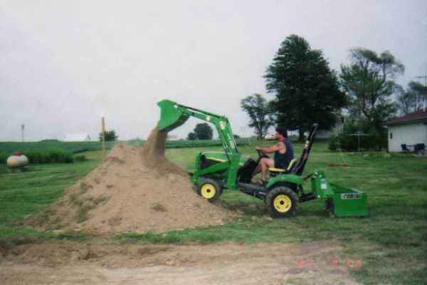

After reading Eagle 1's post in owning/operating under FEL uses I decided to start my own pond using my 2210 with FEL and BB. Worked for about two hours last night and thought I did well. I did take some pics, but, no digital camera.
I probably moved enough dirt to fill a single axle dump truck. Mine will be slightly bigger than Eagle's, probably be 15x30. I hope it will hold water! I will have two field tiles running into, along with some field runoff, and one running out for overflow. The area was always wet before we put the tile in for drainage. I also have a extra well out by the barn (120ft away) that I can get a pump for and use for fill if I need to.

Here is a pic. Just a start.

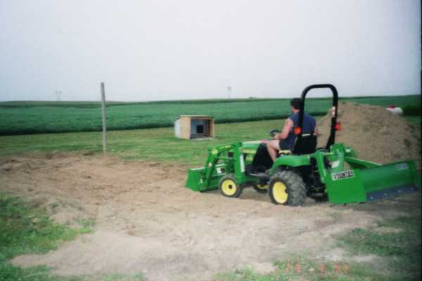

First day.
About two hours.

How deep is that goona be ? You might need an intake snorkel before youre done /forums/images/graemlins/grin.gif Dave
   / Pond #6
That whole pile came out of you digging? WOW! From the pictures you can't even tell if there's any 'depth' to it. Keep'em coming! /forums/images/graemlins/smile.gif

Isn't amazing how much dirt comes out of a "little" hole. Somehow my pile looked like twice as much dirt as the hole should have held. Looks like progress from here.

I think I am done, will have film developed hopefully this weekend and post on Monday. It turned out to be 35ft long and 18 wide. Not as deep as I wanted, but, ought to keep the dogs cool. You can see I have no shade yet.
The depth is only 4 ft.
Patiently waiting on rain! It has been a month or more since it has rained.
As the liner goes we just started a project a work and will be a couple weeks before they are done with the liners. If it hasn't rained will probably throw one in, or if it runs out first /forums/images/graemlins/confused.gif
The clay is really hard and my little tractor sure was grunting coming up out with the BB full!
I bet I had around 10 to 12 hours from start to end.
