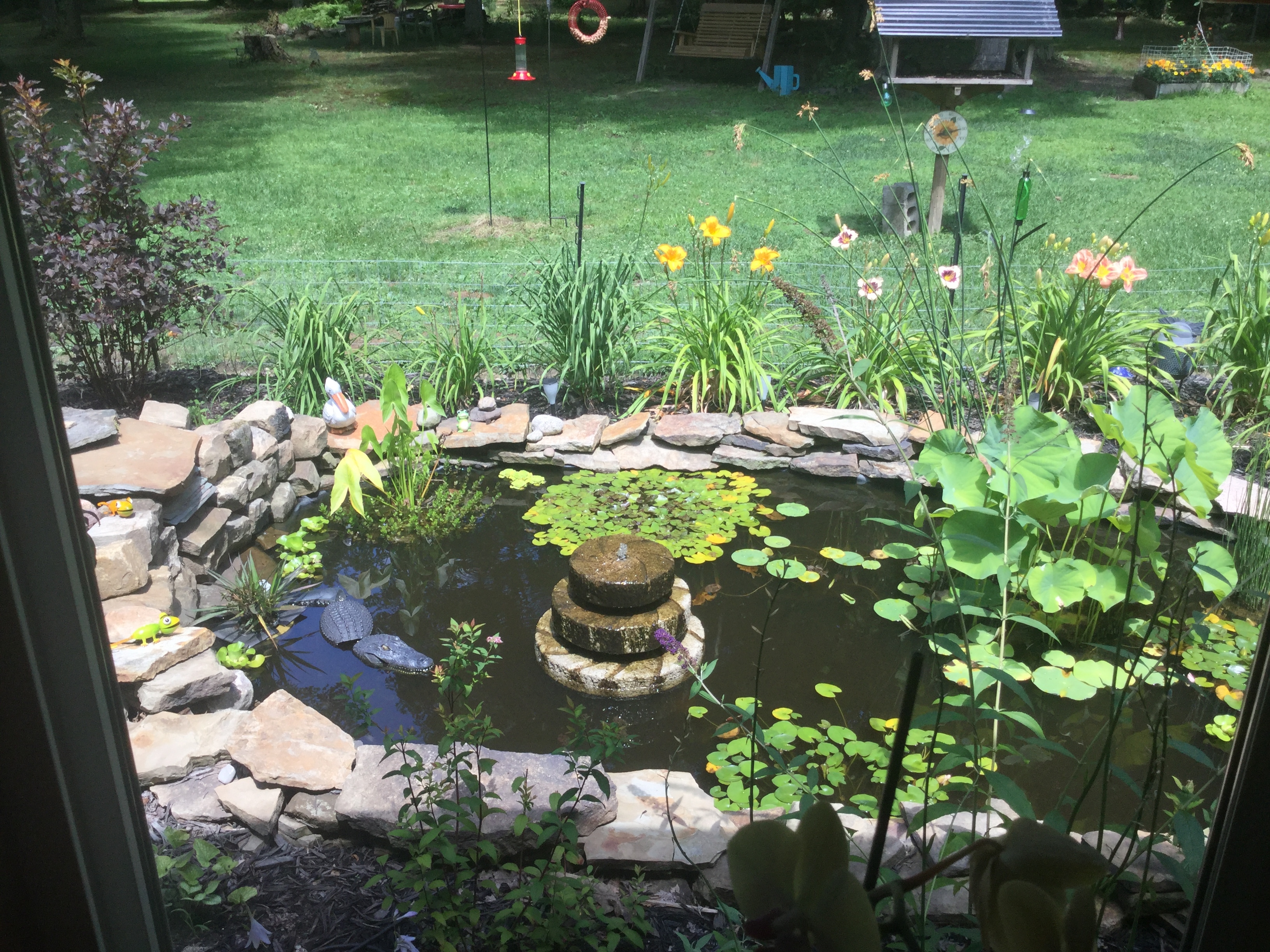

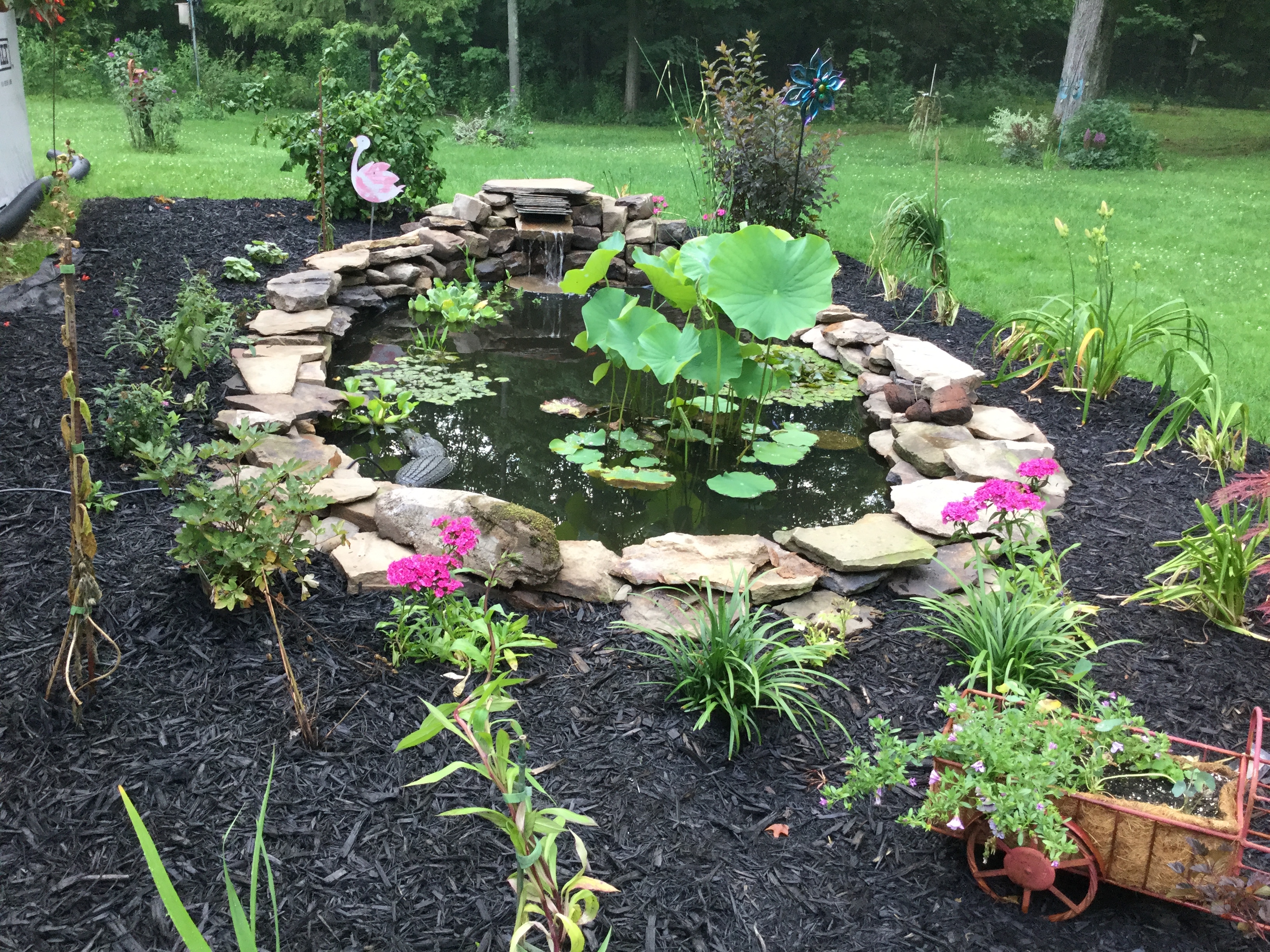

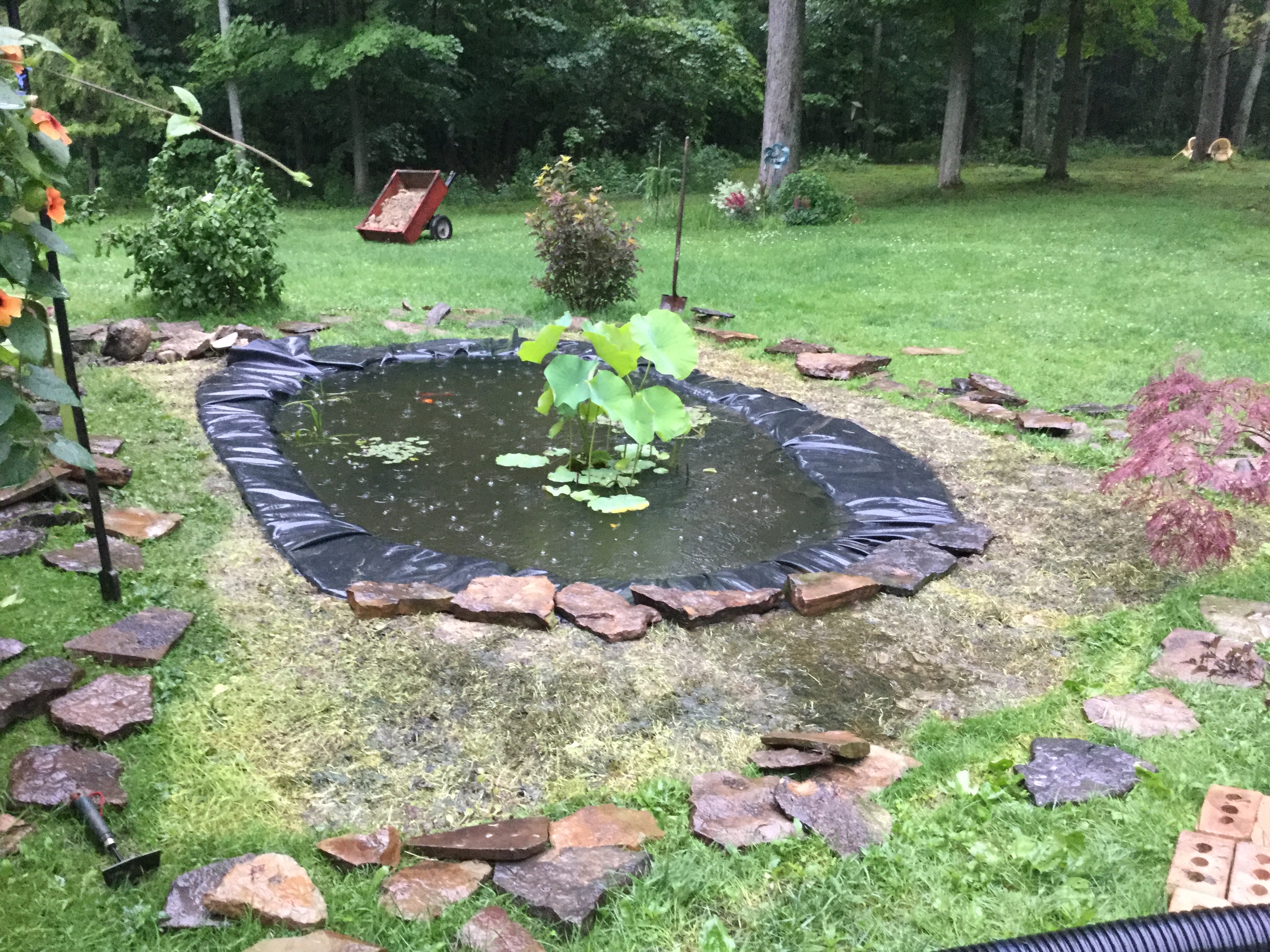

We’ve built 4 different ones between the last couple of houses. We don’t use sand just line the hole with old carpet. tuck the liner in about a foot or so all around the outside and cover with flat stone. Here’s a couple of pictures from our current pond, it’s about 650 gallon.
This what it looks like 8 yrs later We’ve moved the waterfall a couple times and let the gardens grow up around it

nice job...lots of aquatic activity. are those lotus plants in one pic? in contained areas like yours, they add interest. in larger harder to control ponds, they can be very invasive. regards

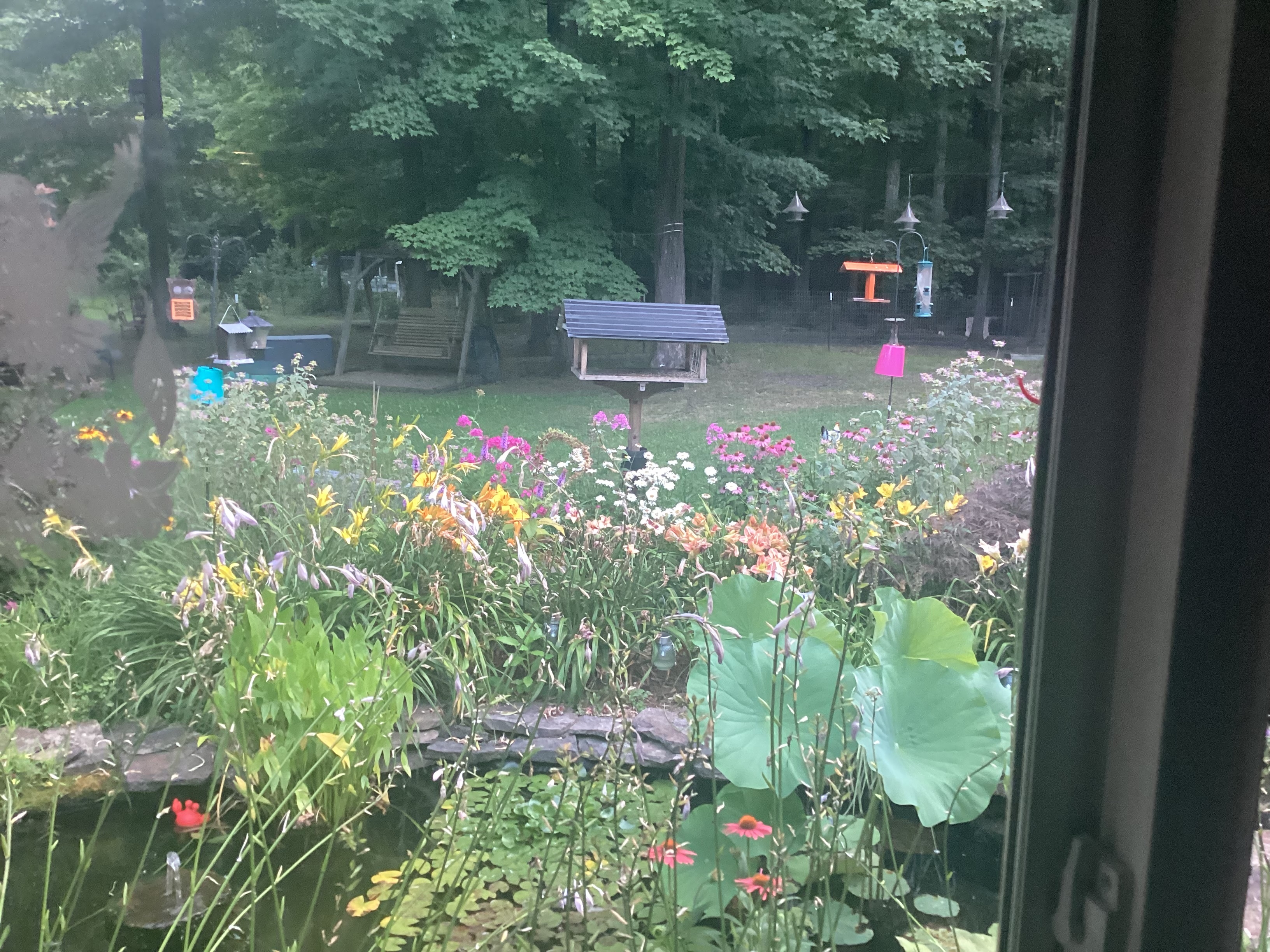

big bubba, Yes it’s a oriental lotus. We’ve had it for 15+ years. It’s in a good sized pot. I’d never plant one without a pot or in a large pond, to easy for them to grow out of control. We have a local lake that is just polluted with american lotus it covers acres water ruining boating and most fishing opportunities.
