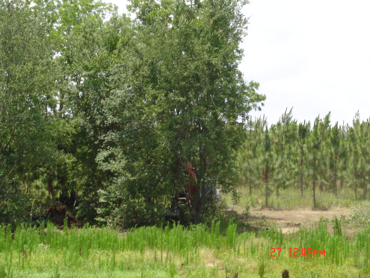

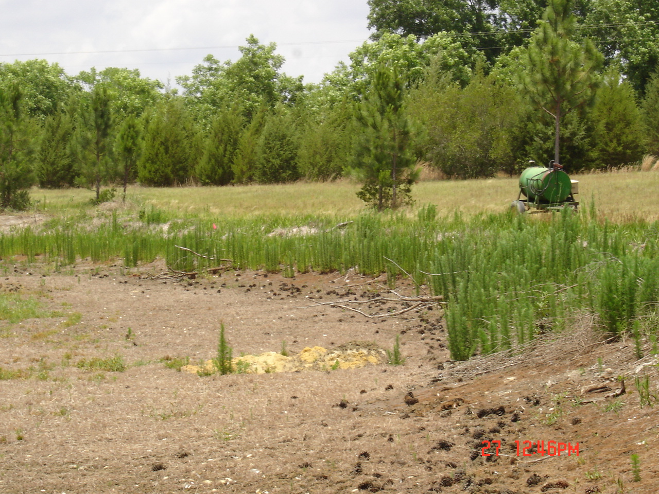

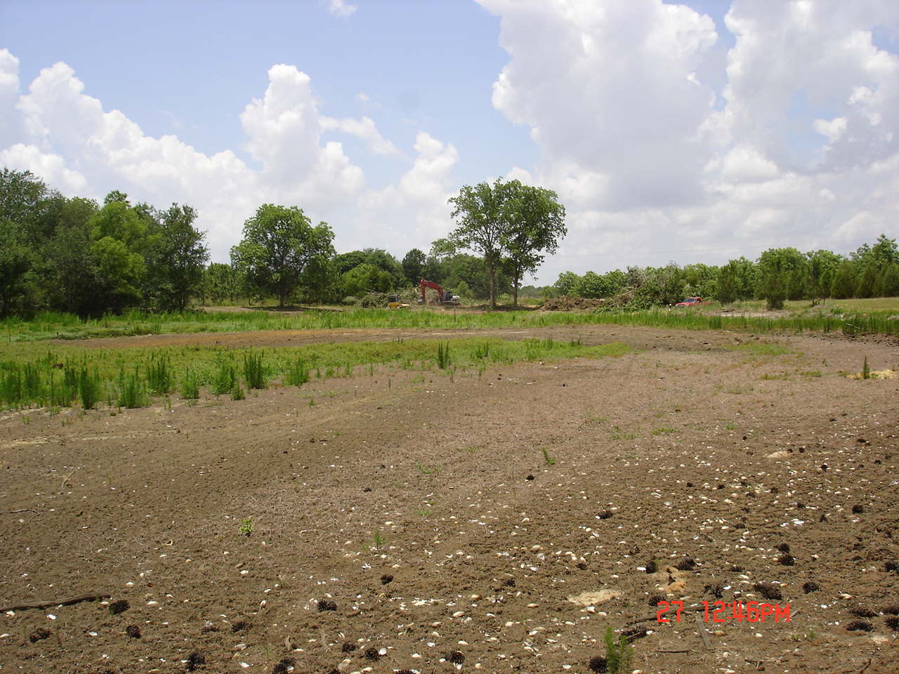

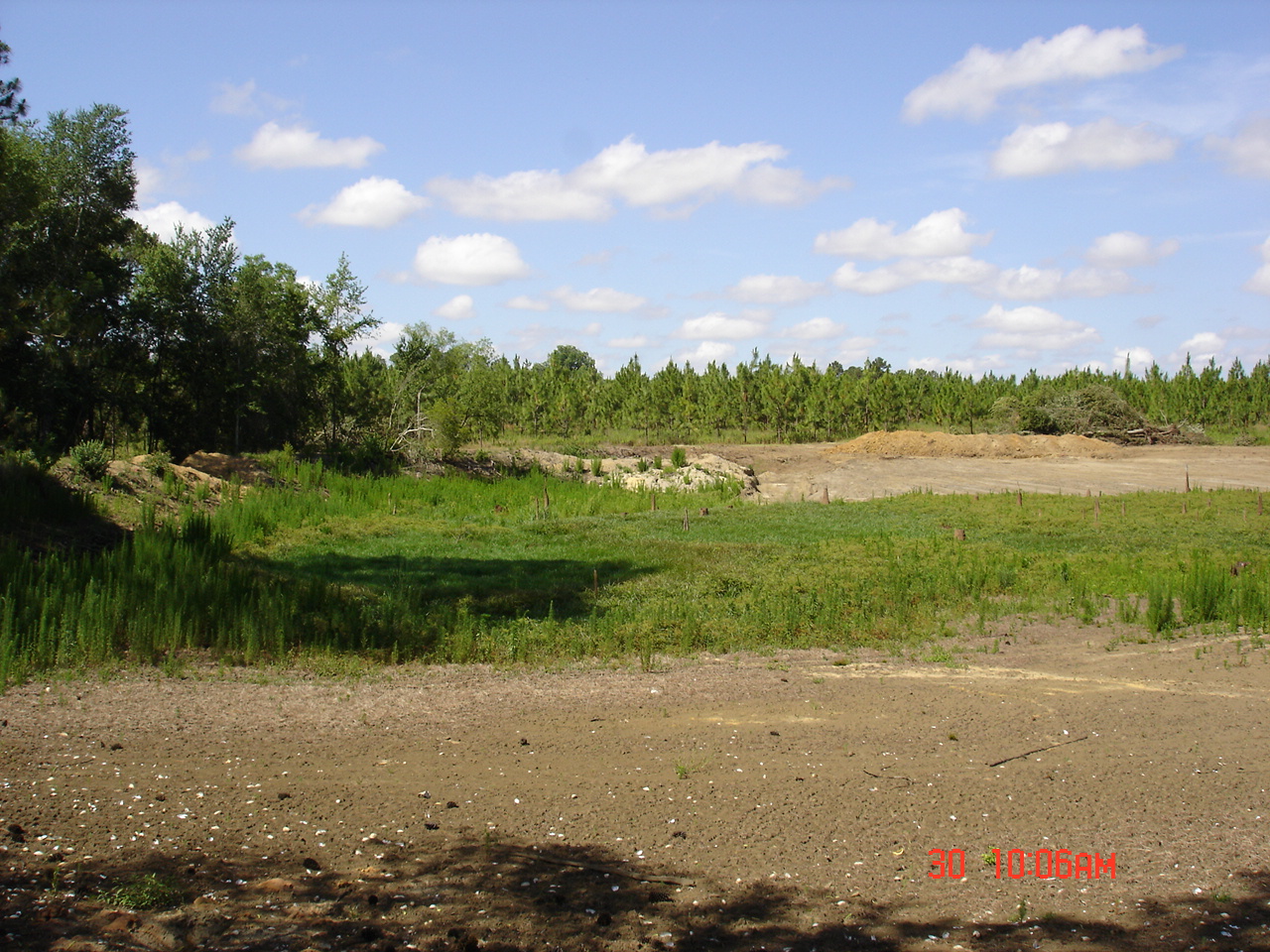

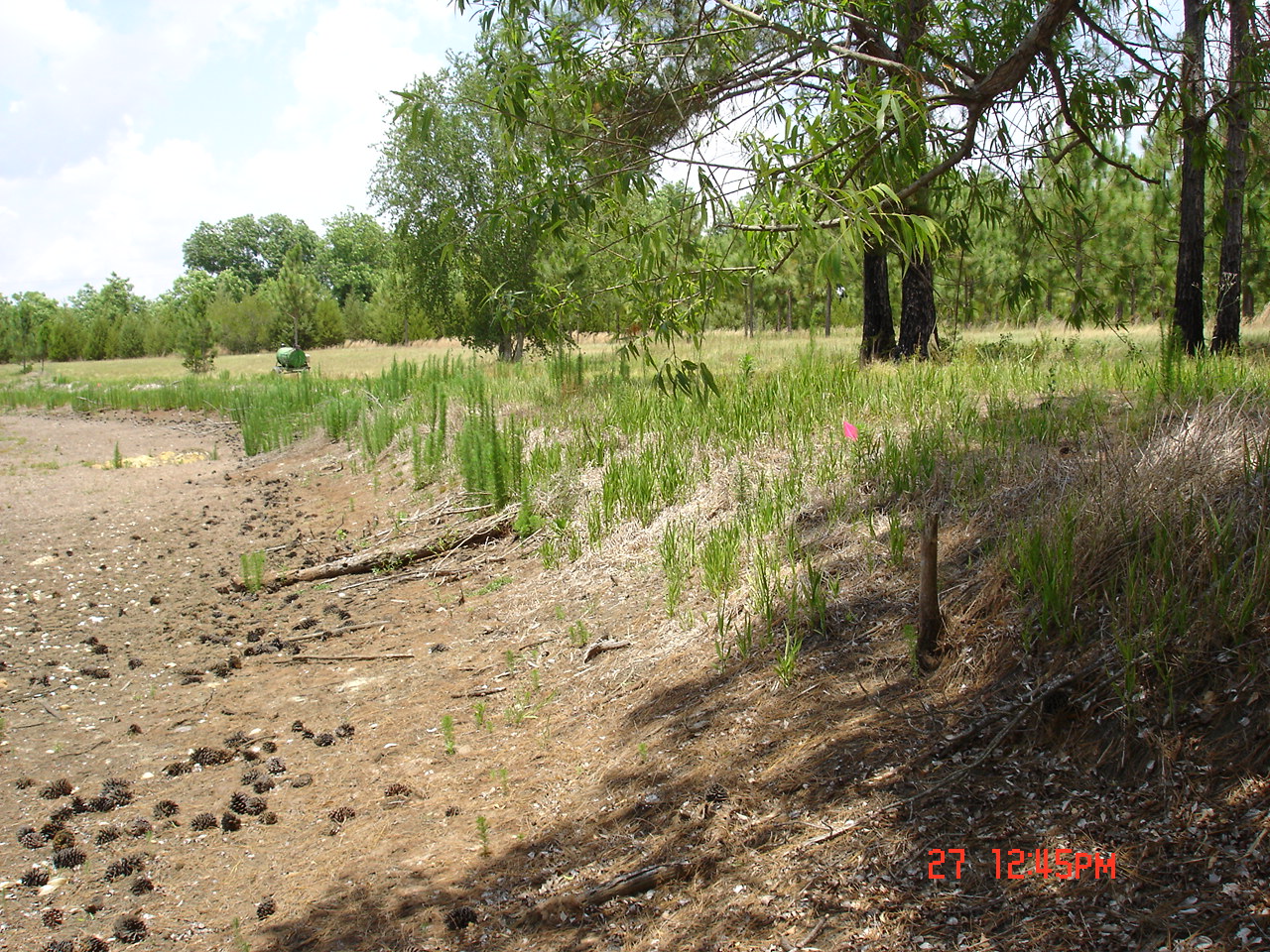

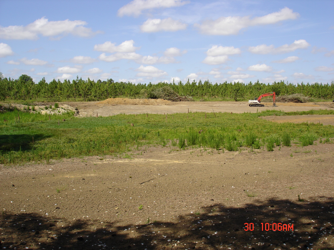

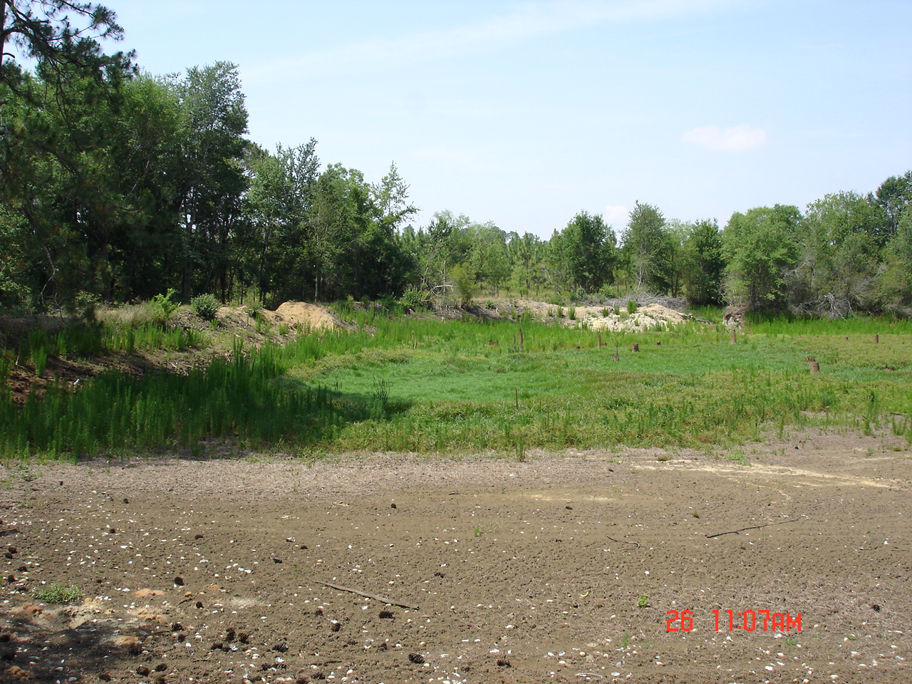

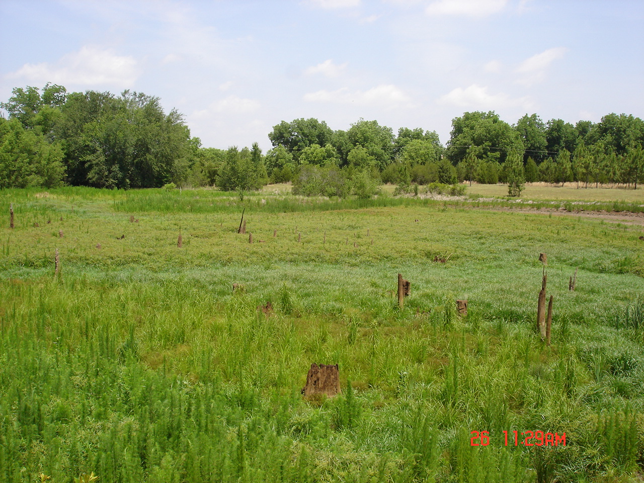

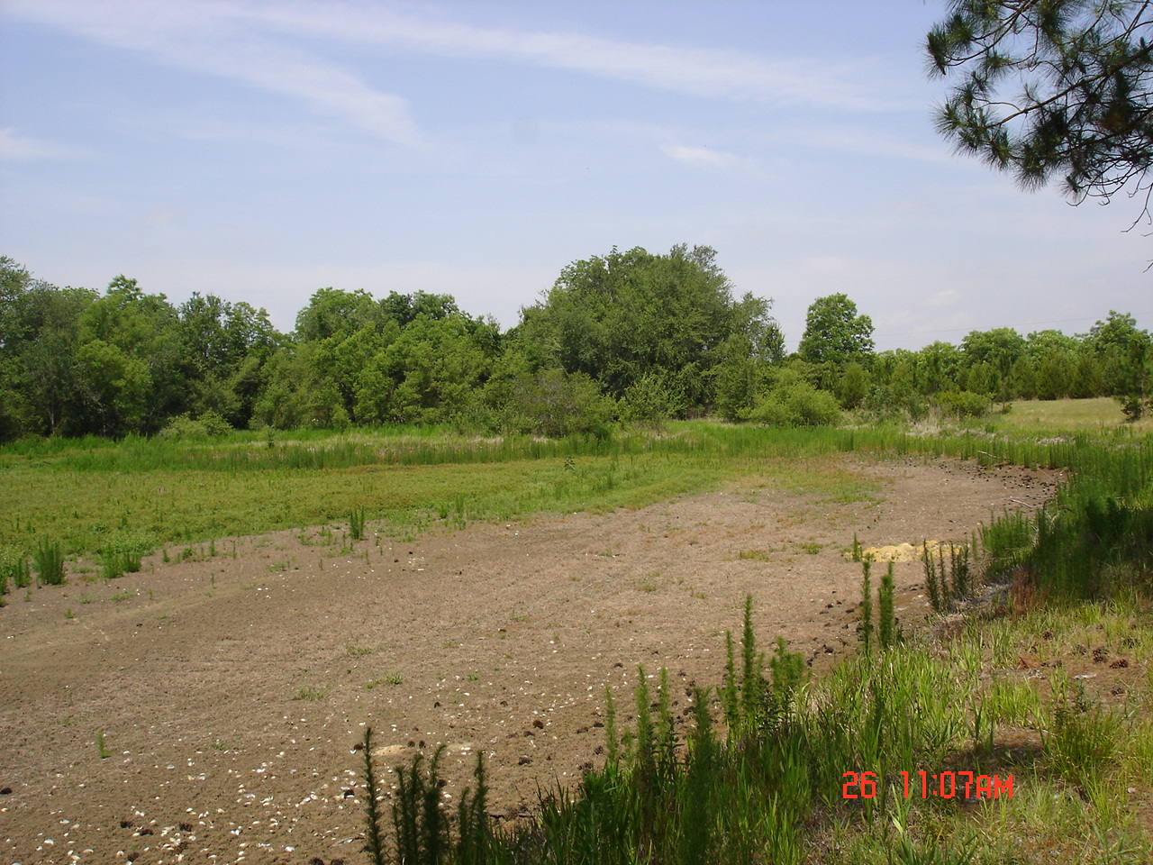

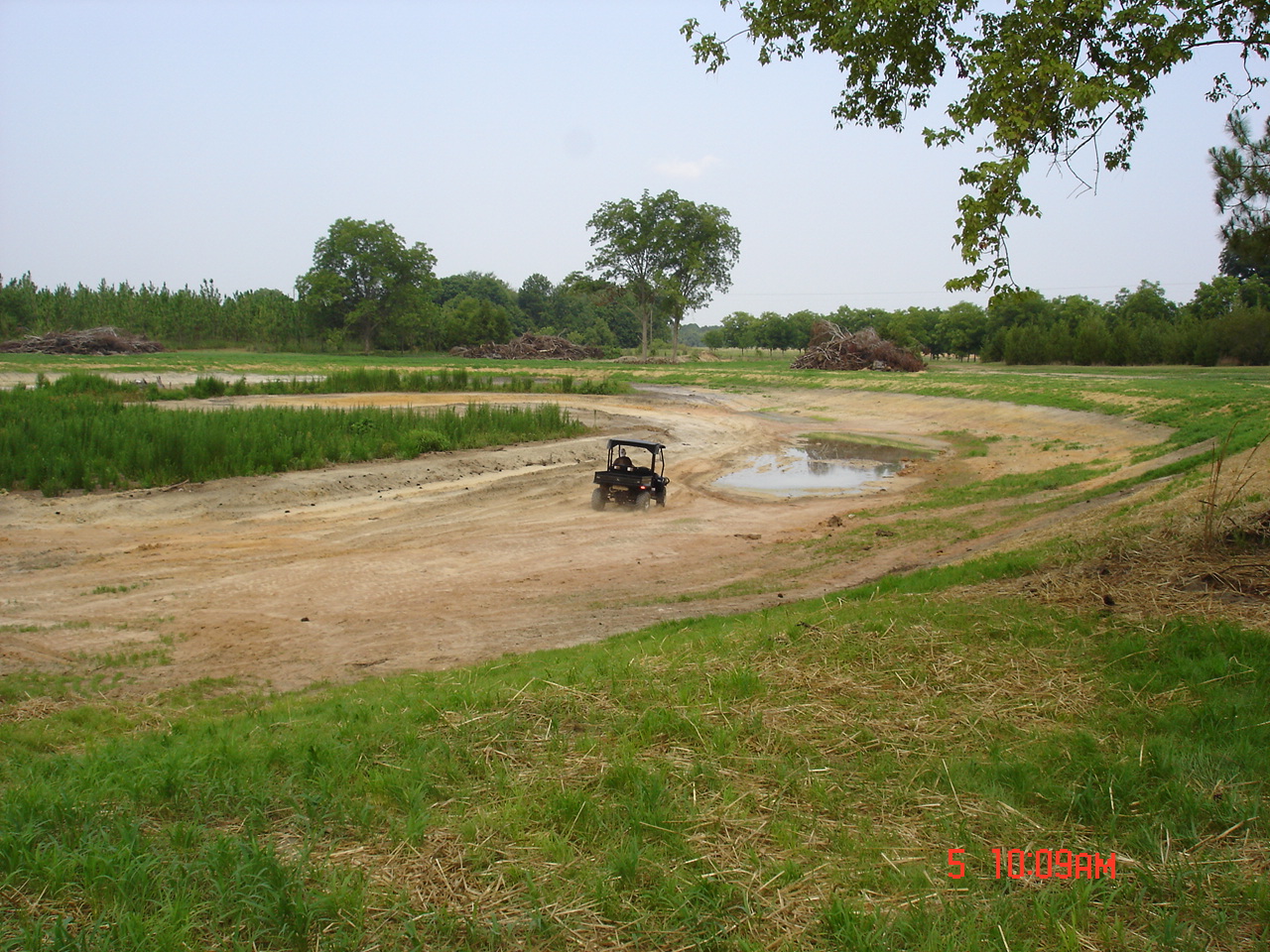

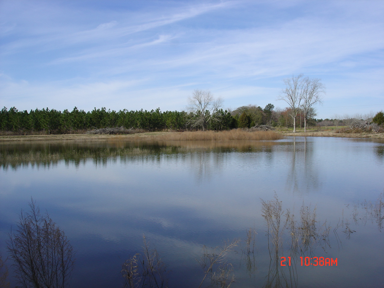

After a long delay, Stan, the pond man, called Wed. afternoon and asked to meet me onsite Thur. to discuss the plan to make sure we where on the same page. I took a few pictures of the dry pond.

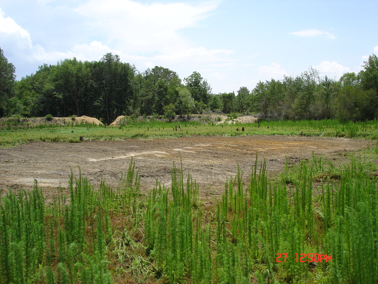

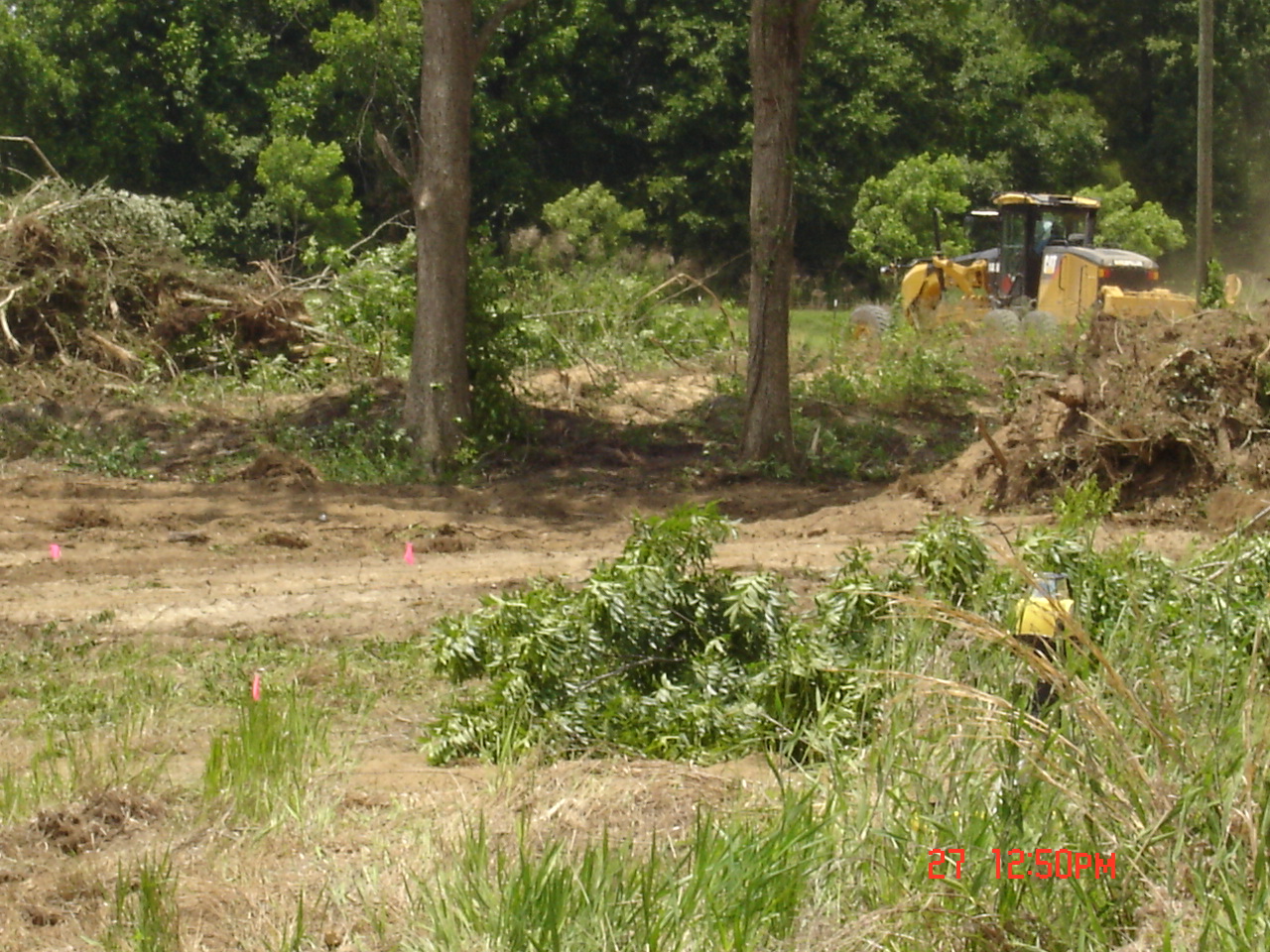

The first picture shows the east bank and the northern end of the pond. It also shows the island but it's hard to see. The east bank will not change. Fill will be added to the right of the bank since that area is lower than the bank and stays wet if and when we have rain.
We're in an extreme drought now. The experts say we're having the driest May on record. I was curious as to why there was a large bare area here. I took a shovel and tried to dig a hole and saw that there was about a half inch of sediment and then pure hard clay.
The second picture shows the dam. It will be de-constructed. The new dam will have a larger footprint and constructed properly, i. e. cored, wider base and top, etc.
The third picture was taken from the dam looking northeast. It also shows the island. Some of the old longleaf pine stumps still have the notches in them from when the turpentine was harvested. The north end was very shallow, swampy, etc. Stan couldn't give us a firm quote until he "uncovered" the north end to see what had to be done.

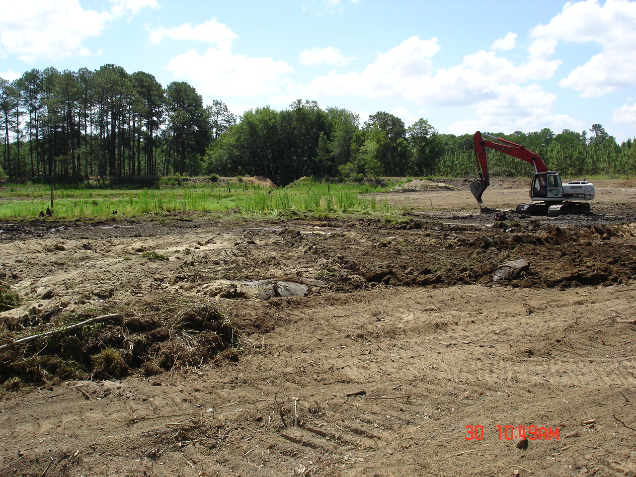

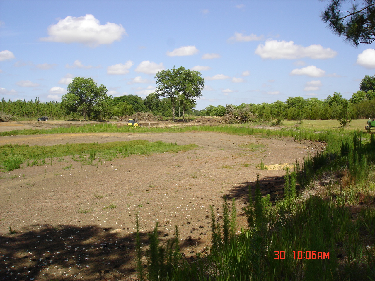

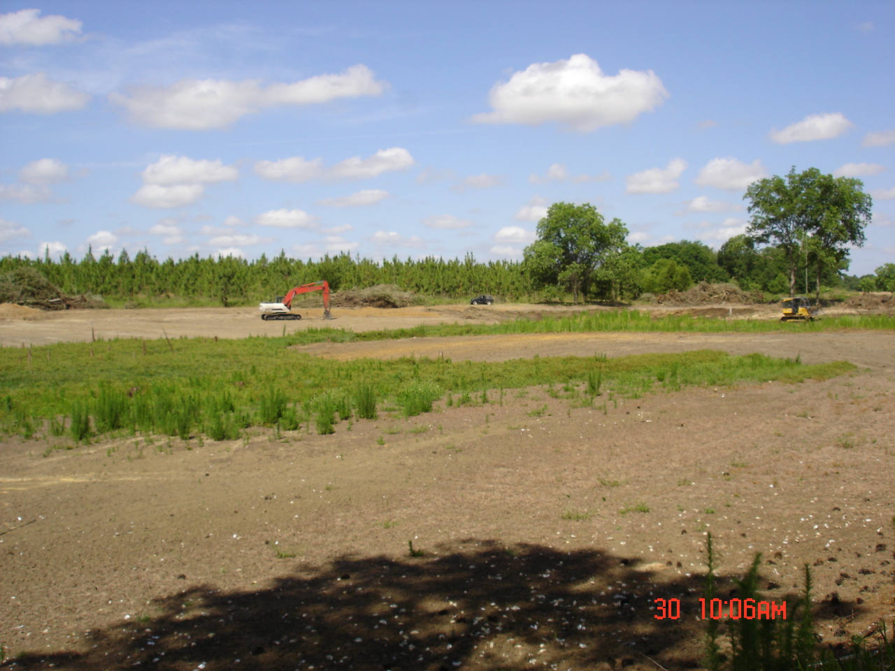

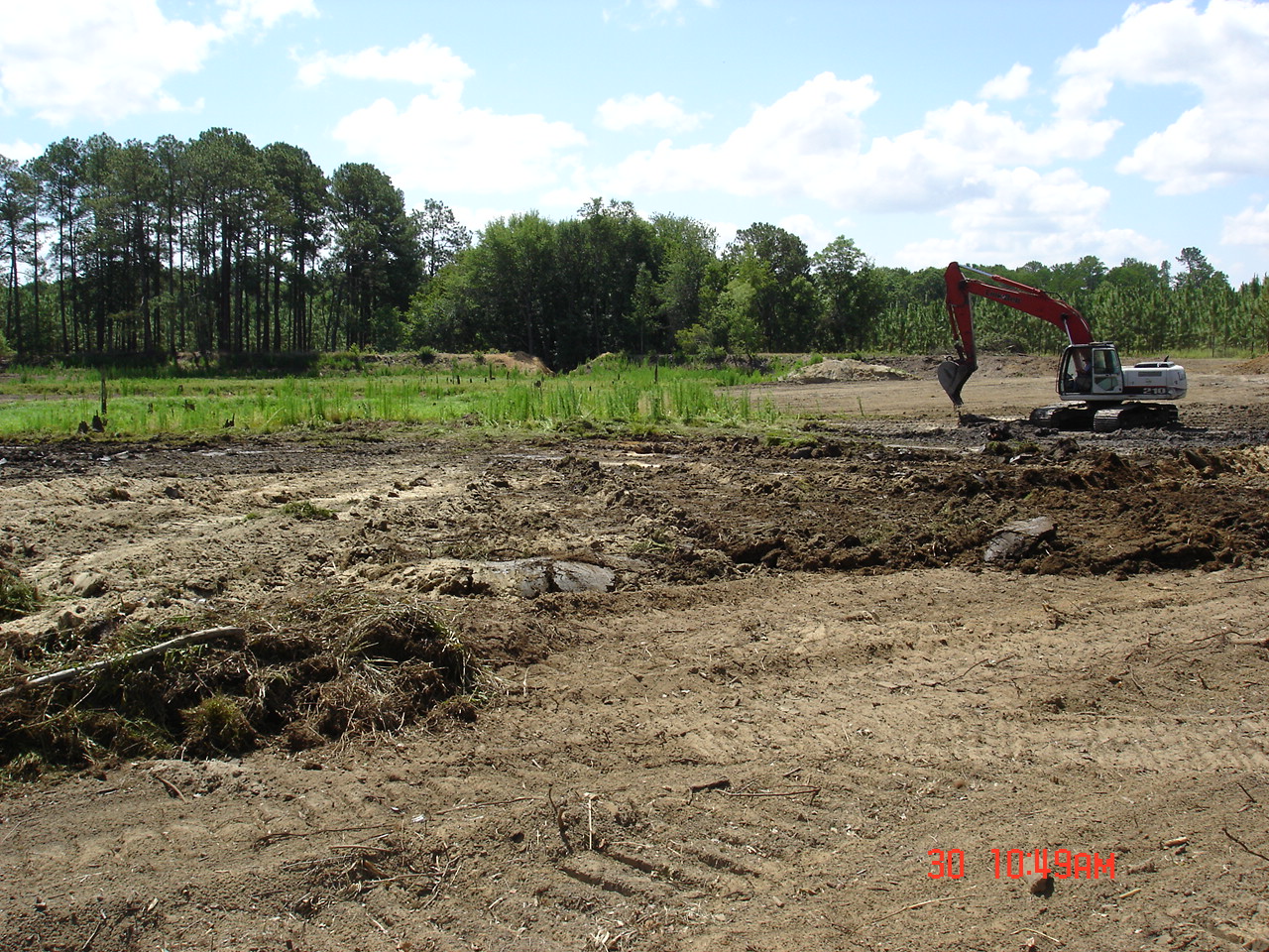

Hi Kevin,
No, I'm not really concerned. There, apparently, was enough acreage that drained to the old pond to bring it up to full level. Also, I saw water running thru the spillway several times in the past. When Stan broke the dam last Sep. he dug 2 test holes below the dam. The holes immediately began to fill with water so there was significant leakage thru/under the dam. Michele and Tony don't plan to move on site for another 5 years. It will be interesting to see how long it will take to fill.

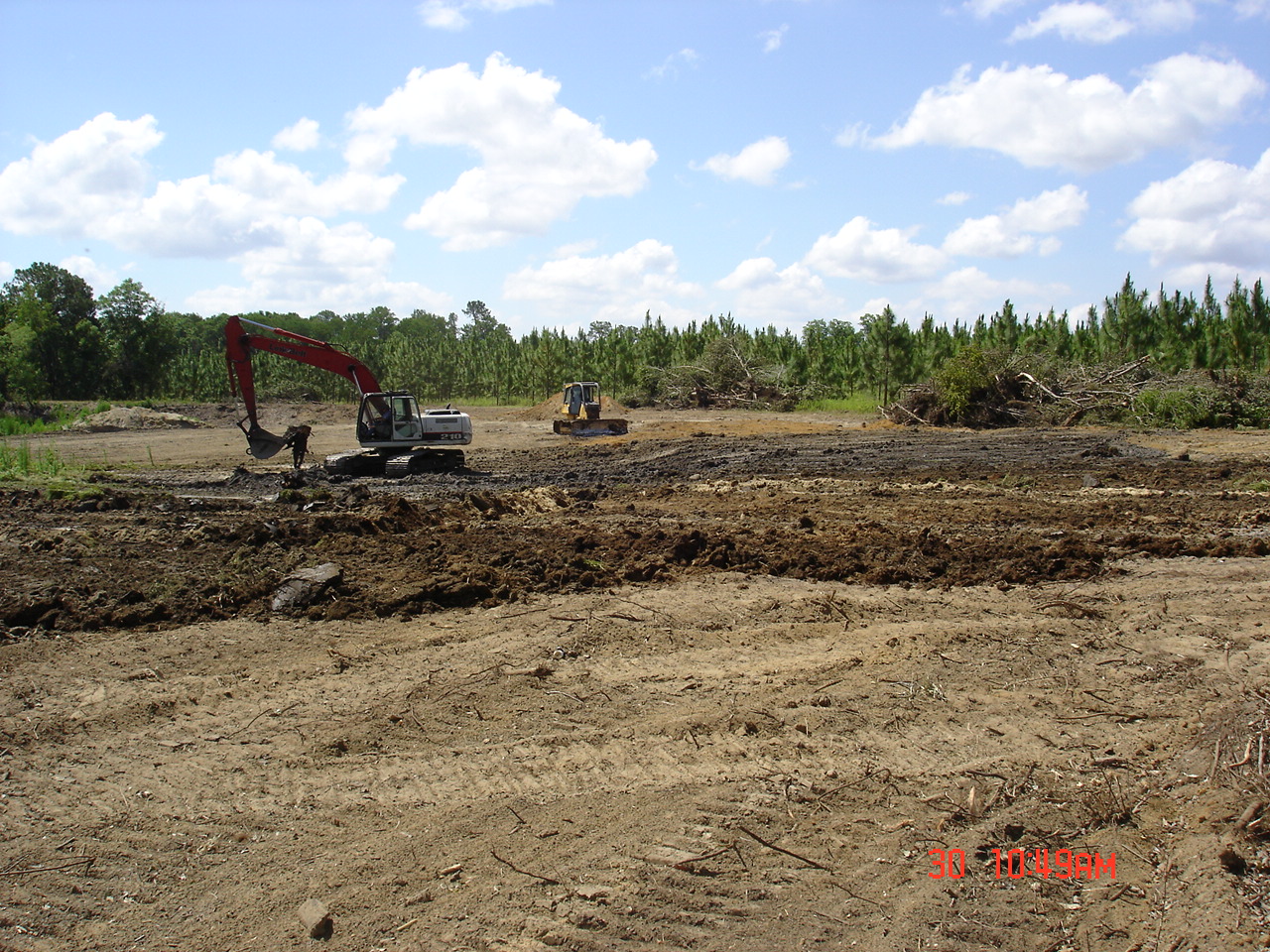

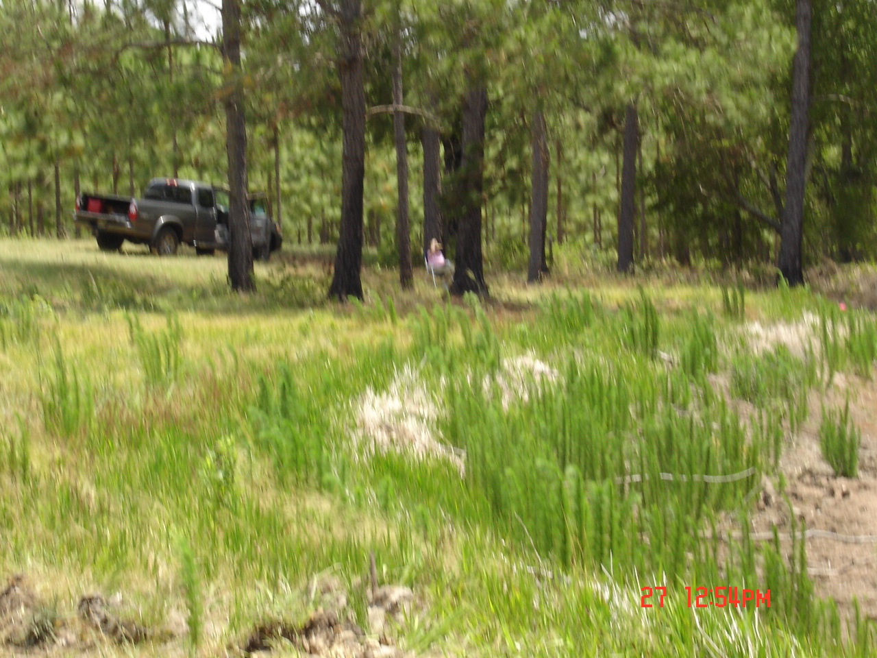

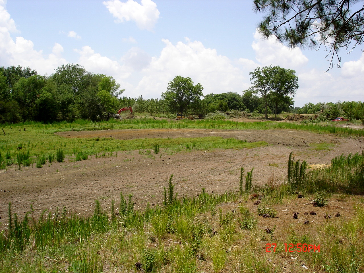

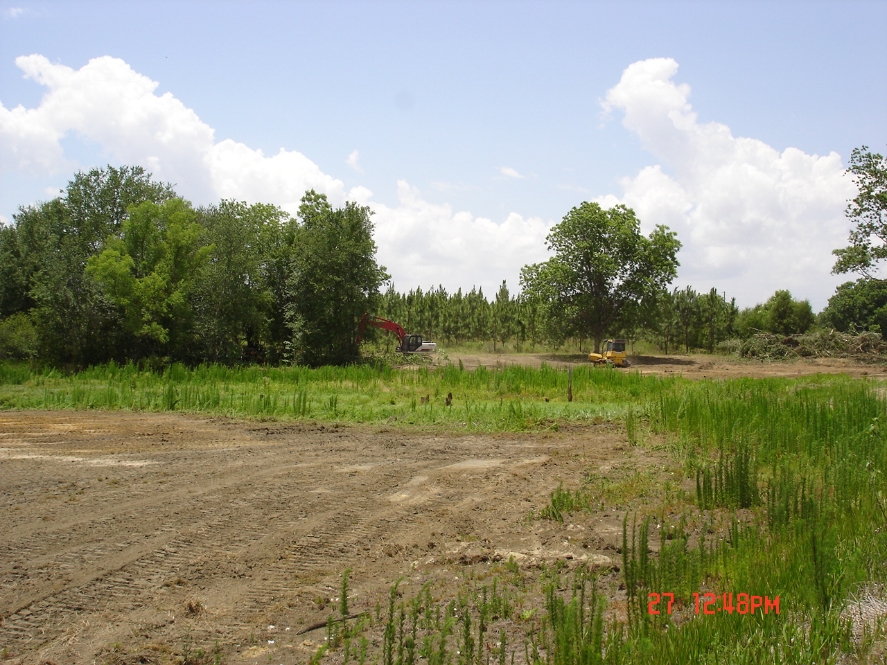

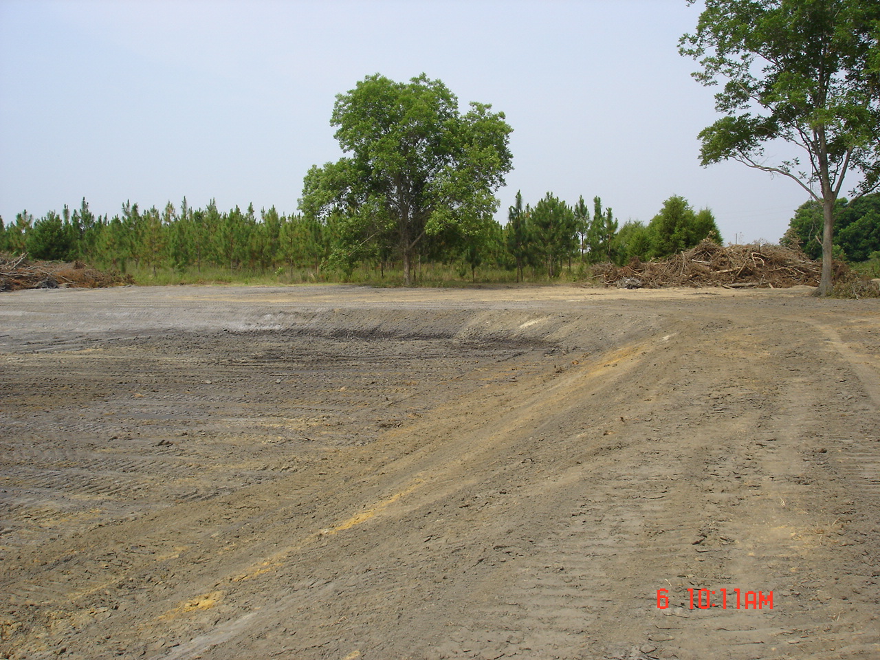

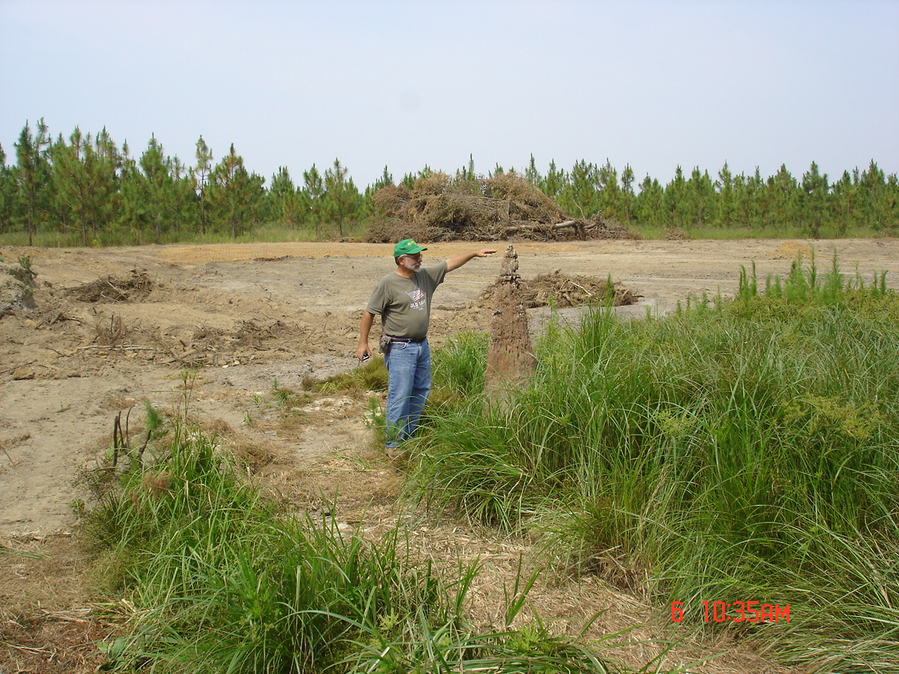

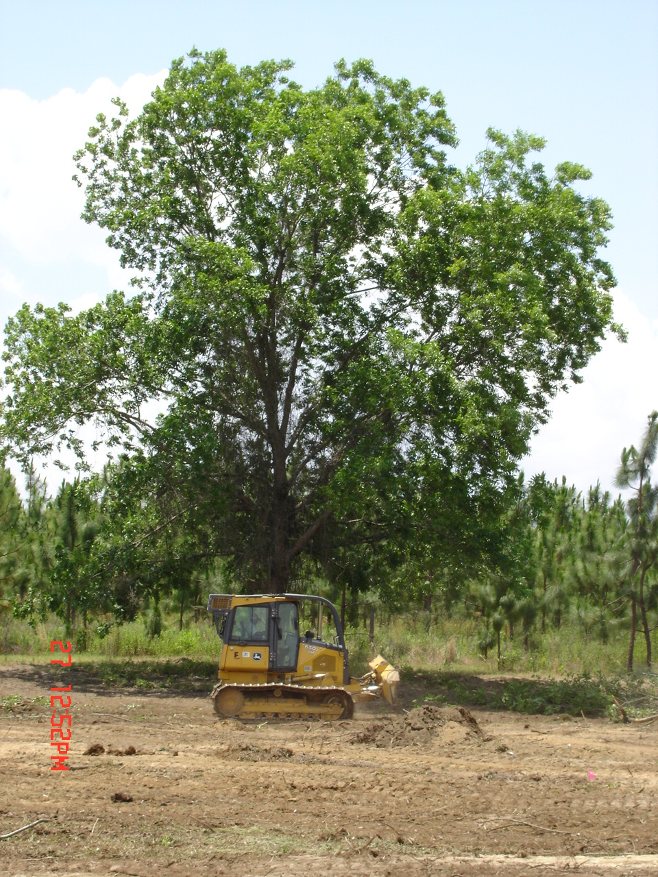

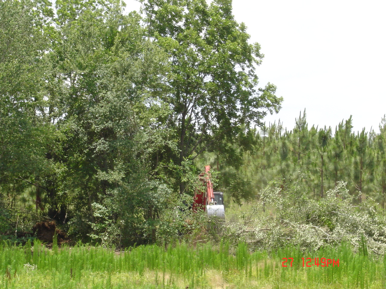

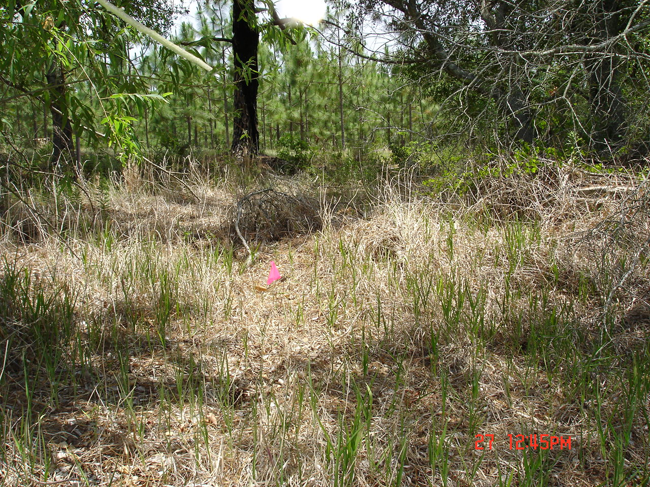

So Friday morning I was at home doing my thing when Stan called. He asked me to come right over since he had the north end and part of the west side cleared. He also had the water line staked on the east, north, and part of the west sides. DW volunteered to go to keep me company.
I'll attached a few pictures to show the progress.

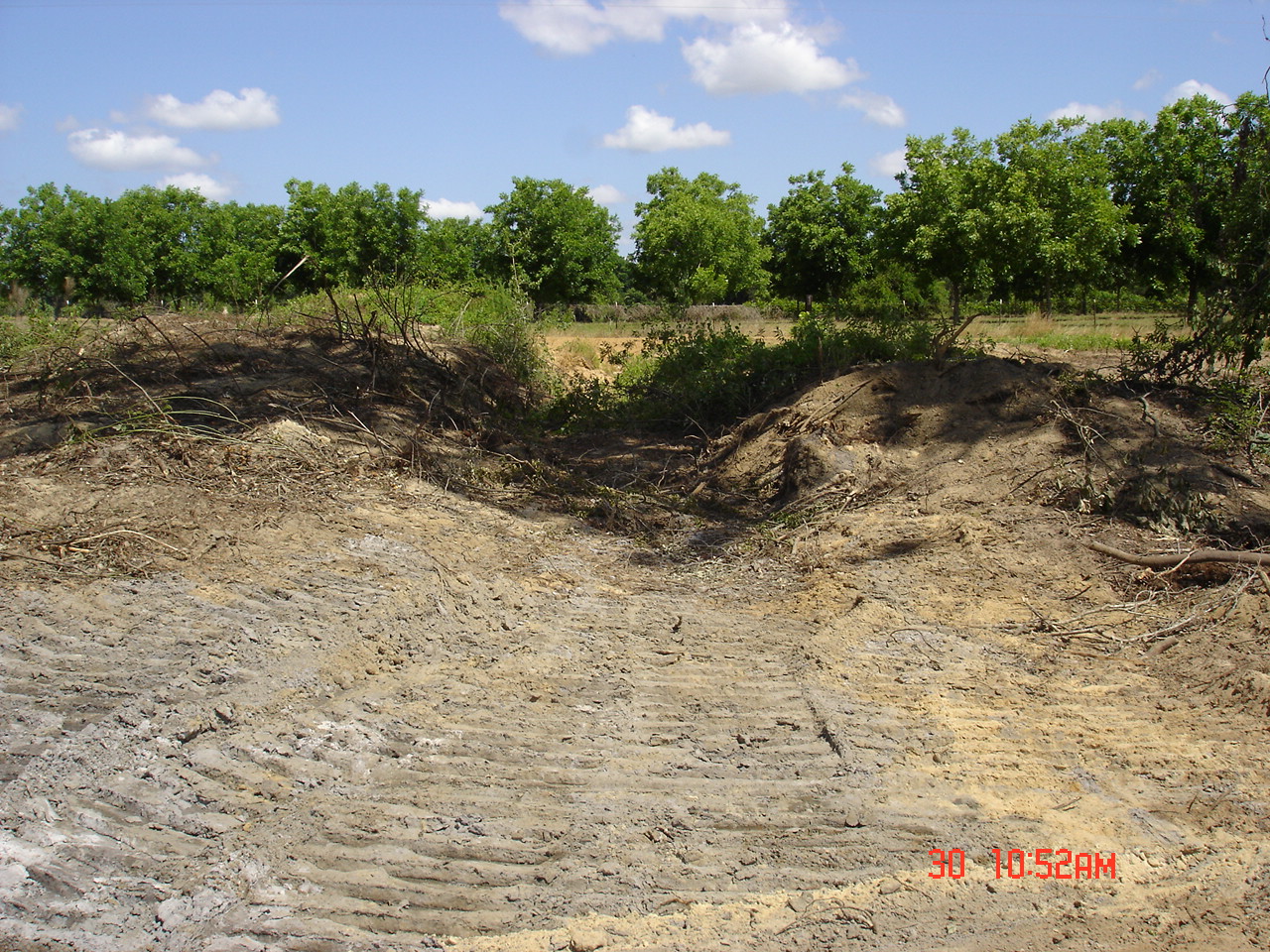

The first is of the old spillway. He said he was going to have to rebuild it. The top of the pink flags will be the high water mark.
The next 2 will show the east side and then a couple of the north, then west. I'll include a couple of action shots and then the site of the former island.
Initially we had told Stan to take out all of the volunteer pecan trees. But he had uncovered 3 pretty ones and since they would not be in the way, he suggested we leave them. I agreed.
The last picture is of DW reading her Kindle.

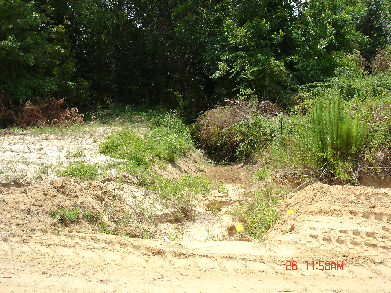

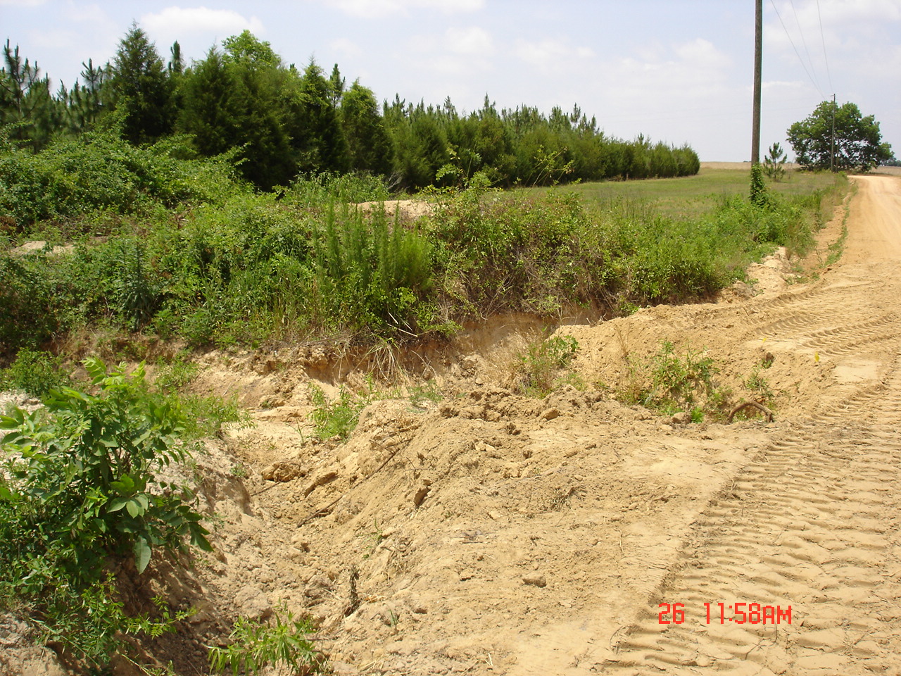

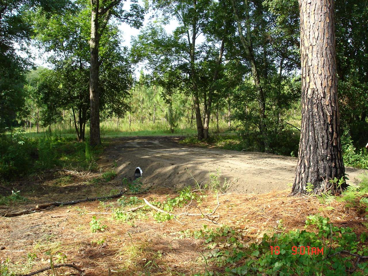

I got ahead of myself in telling the story. On Thur. I took a couple of pictures of an area that has been troublesome for our neighbour, Greg. Property to the west of him drains to his small pond and his pond overflows and drains thru a culvert under the county road to our side.
I have come to believe the county road crew is somewhat road maintence challenged. Every now and they come thru with a grader and, either, fill in the ditches or leave a ridge on both sides of the dirt road. I have never seen a crown. Once in a great while they will come back and dig out the ditch and the process starts over again. In the past they have caught the end of the culvert and ripped of the end when they cleaned out the ditch. Bit by bit, and now the culvert is 3 - 4 feet shorter than it should be. When ever the grader comes thru and is in the "filling-in-the-ditch" mode, the end of the culvert gets covered up, thus the water doesn't drain from Greg's property.
The power company has recently whacked back the overgrowth from their easement and the road crew has recently cleaned out the ditch. A fairly deep ditch, running into the woods on the north end of the pond, was revealed. Also, there are many yards of sand stacked, by the road crew, on the easement and also on into the property.
Stan is going to build up this area, install a 20' x 24" culvert, and a sand trap between the road and culvert. The culvert will allow east field to west field access on the north side of the property.
The first 2 pictures show the culvert and ditch area. While I was there on Fri. the county grader made a couple of passes. :)

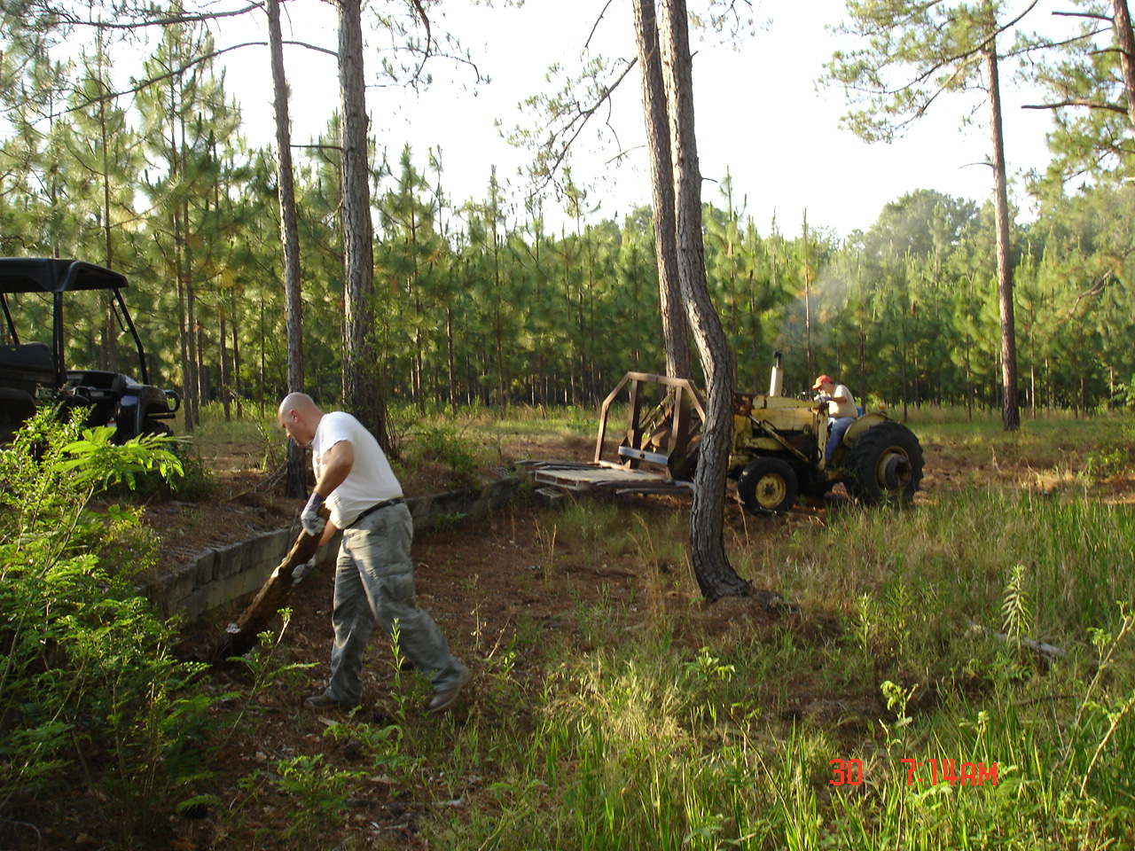

I have another update with pictures. :)

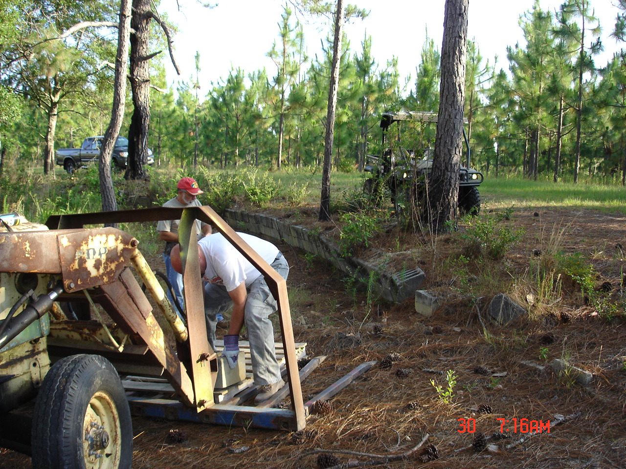

Last Friday, when I was discussing the situation with Stan, he mentioned he was going to change the spillway a bit. The spillway was designed to handle normal and emergency overflow. It was quite elaborate and probably was quite scenic at one time as it was lined with brick, rock, and concrete block. It has a small dam made of block, re-enforced with rebar and concrete.
But the spillway was a source of irritation since going thru it was the main route to the dam. It stayed wet a good bit of the time which also made it difficult to mow. The area between the little dam in the spillway and the pond could not be mowed at all.
Part of the spillway, on the outside of a curve, was line with large, dry-stacked concrete block. I thought it would be a great waste for these blocks to be buried in a hole so decided to salvage them.
Brother Warren (who's no spring chicken, either) volunteered to help and I hired his stepson's wife's twin sister's husband, Scott, to help. :) Scott is a fellow Marine vet who served 4 years active duty and 5 years active reserve. He was called up while in the reserve to "visit" Kuwait and Iraq. He felt like close kin to me.
Shortly after we started, neighbor, Greg, showed up with his Ford with forks. Told us to go ahead and use it and try to pop out the blocks with the forks. He said he might come back to check out the progress. I asked Warren to do the tractoring since he has more experience and, also, he's an Ag engineer (and acts like it, too :laughing:). After Greg showed him the quirks (no brakes, etc.), he left to go do his thing and never came back. Probably a good thing too 'cause, by the time we were done, we each would have given him a hug and a kiss. :eek:
Anyway, here's a couple of pictures of us gettin' it. It took us 4 hours and we salvage 88 block. Also, a few pictures of Stan's progress. The last picture shows the culvert under the road, that I mentioned in an earlier post, area.
I'm going to central fLa. for a few days so won't be able to be "onsite" until next Monday.

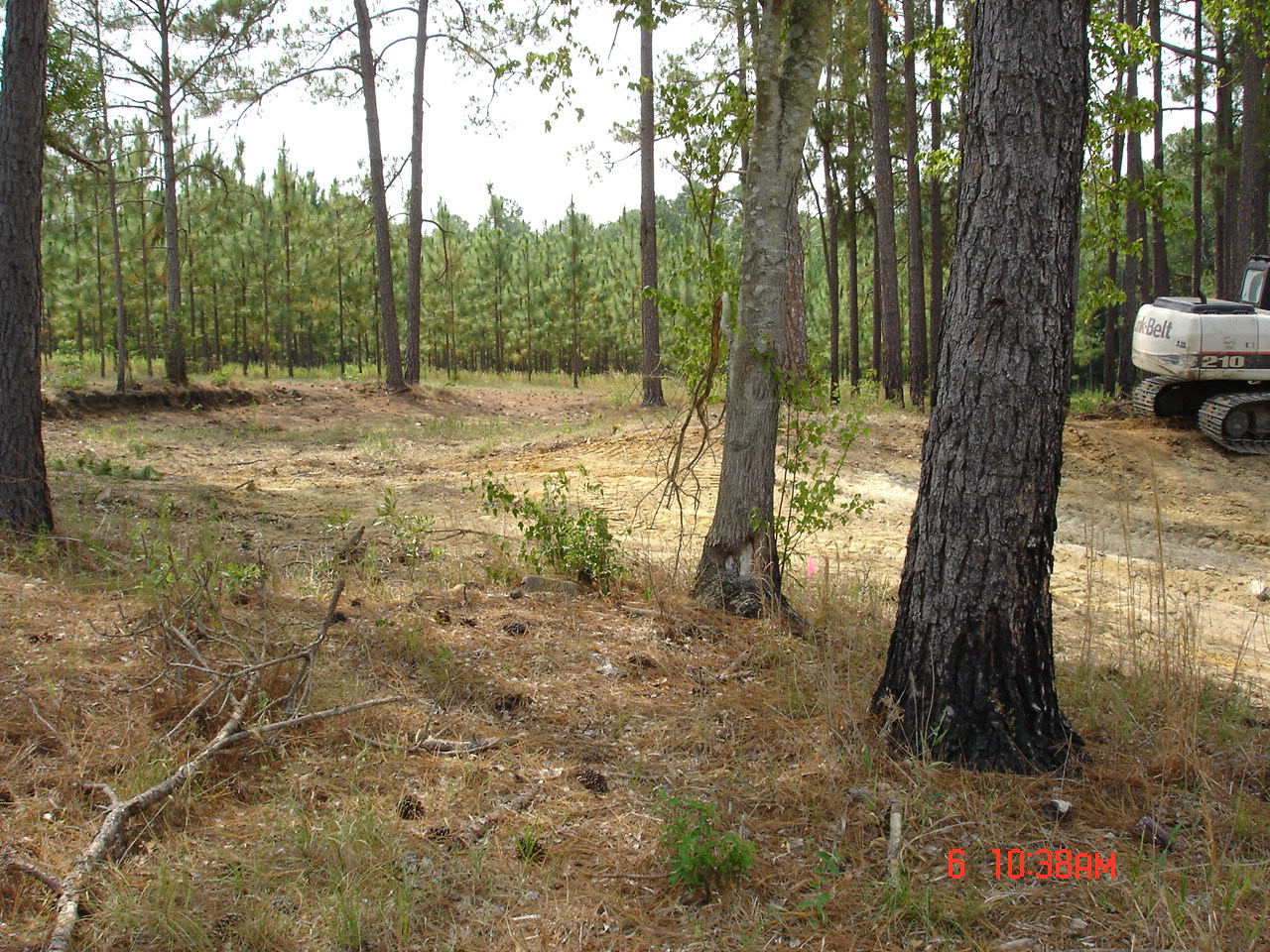

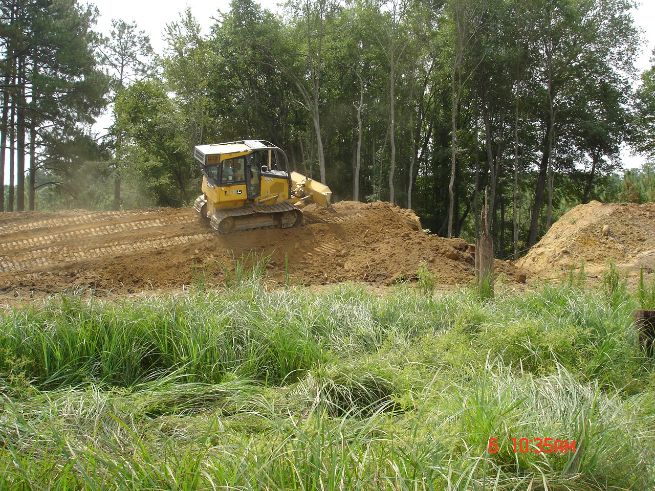

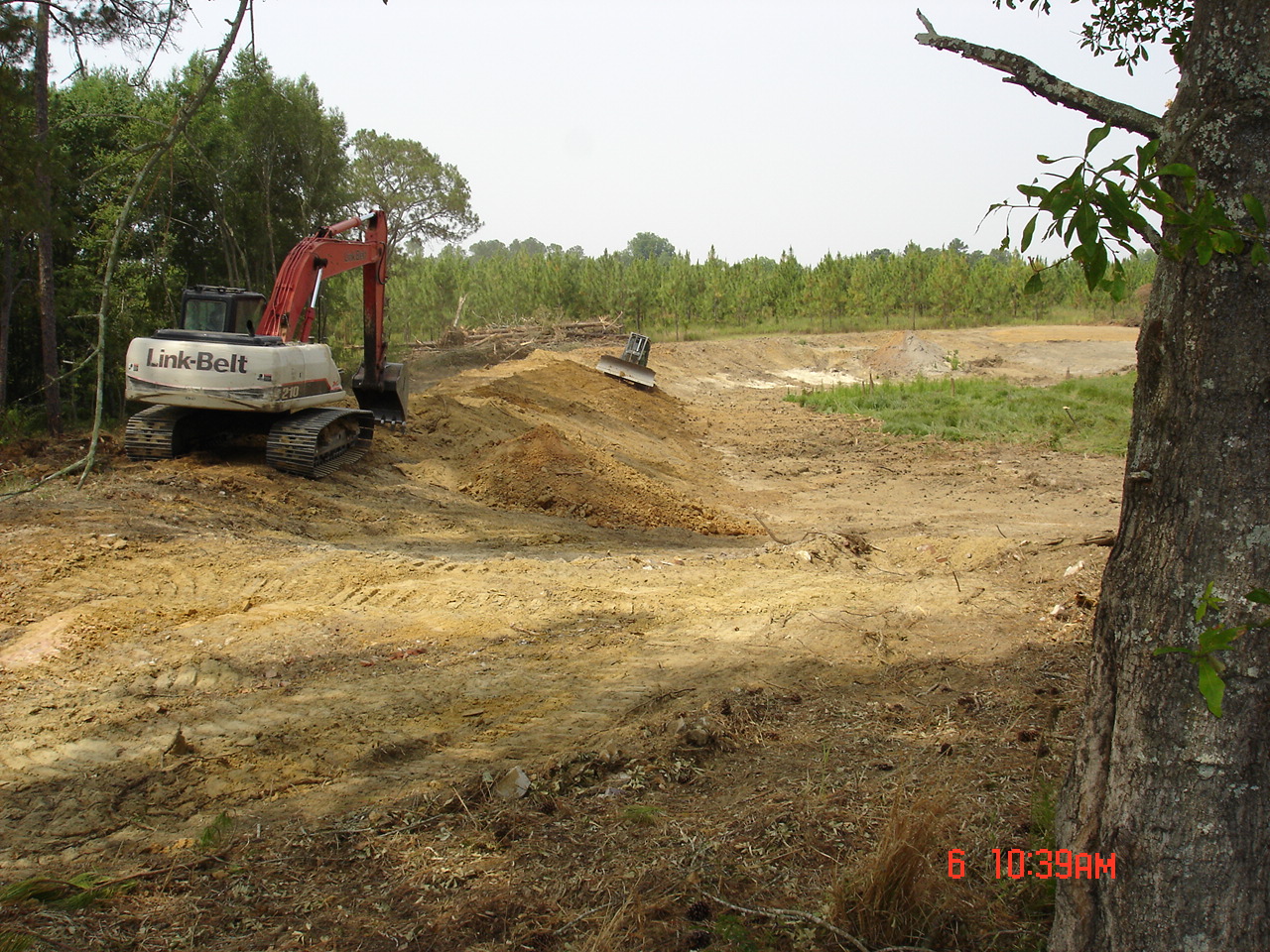

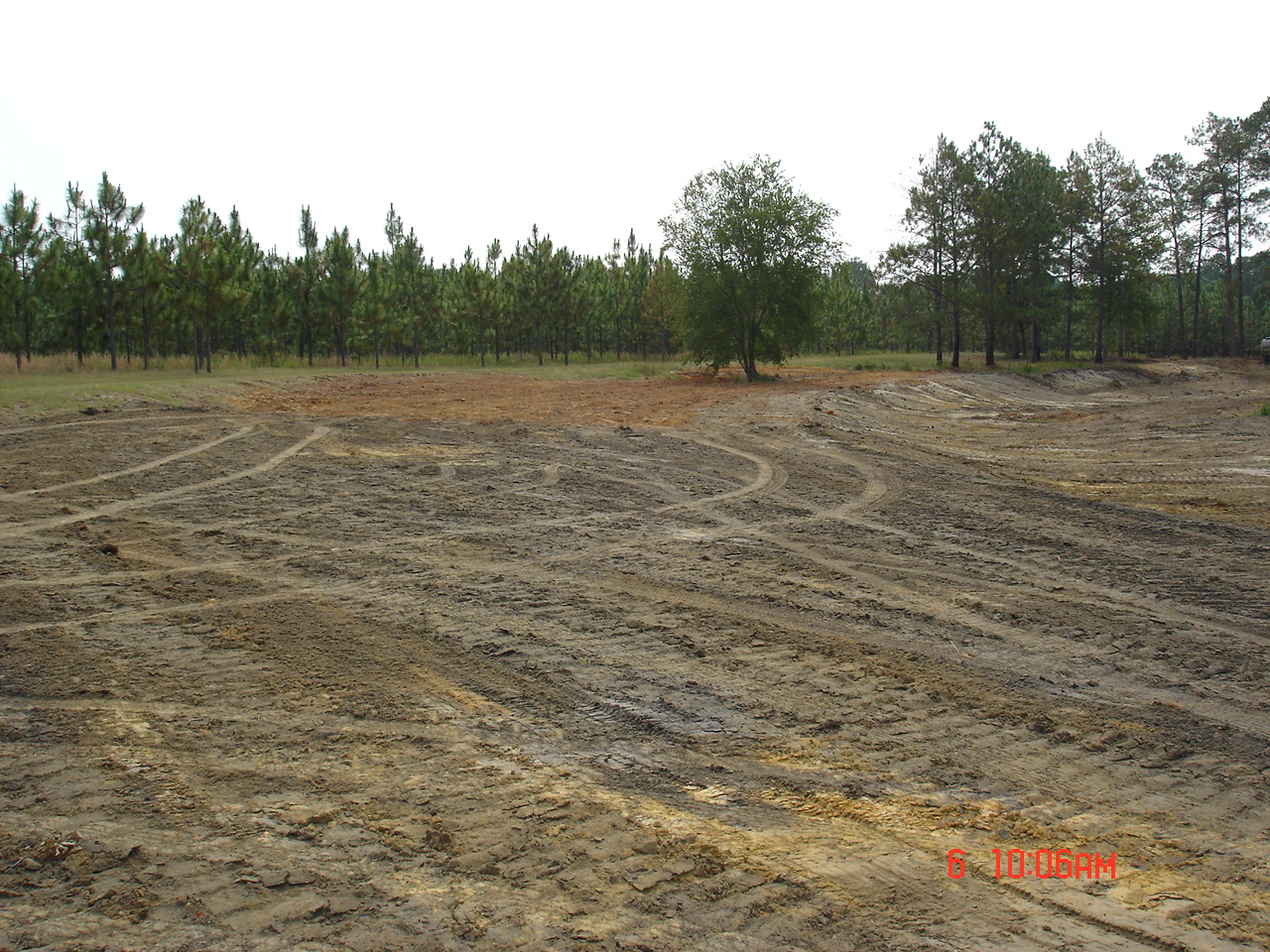

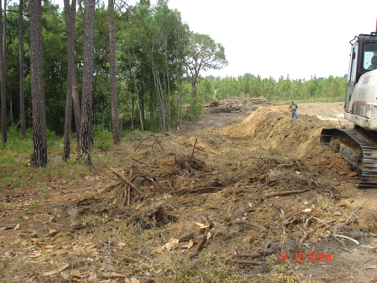

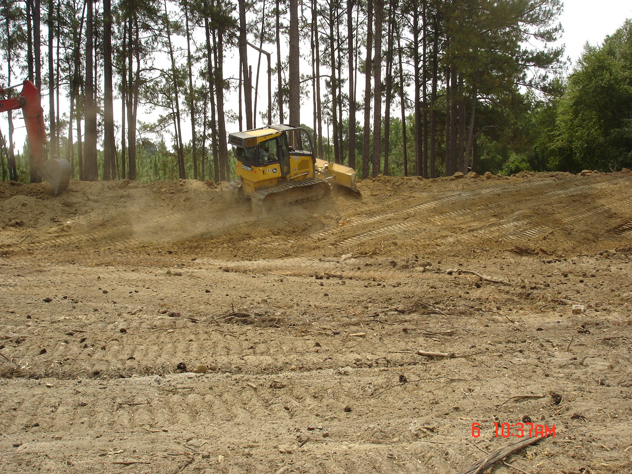

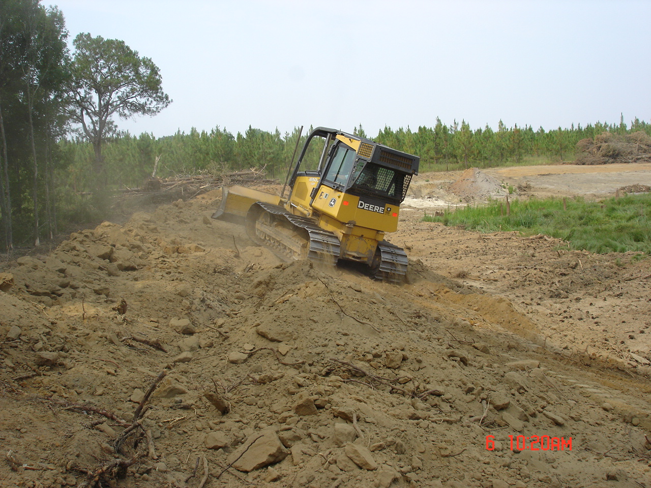

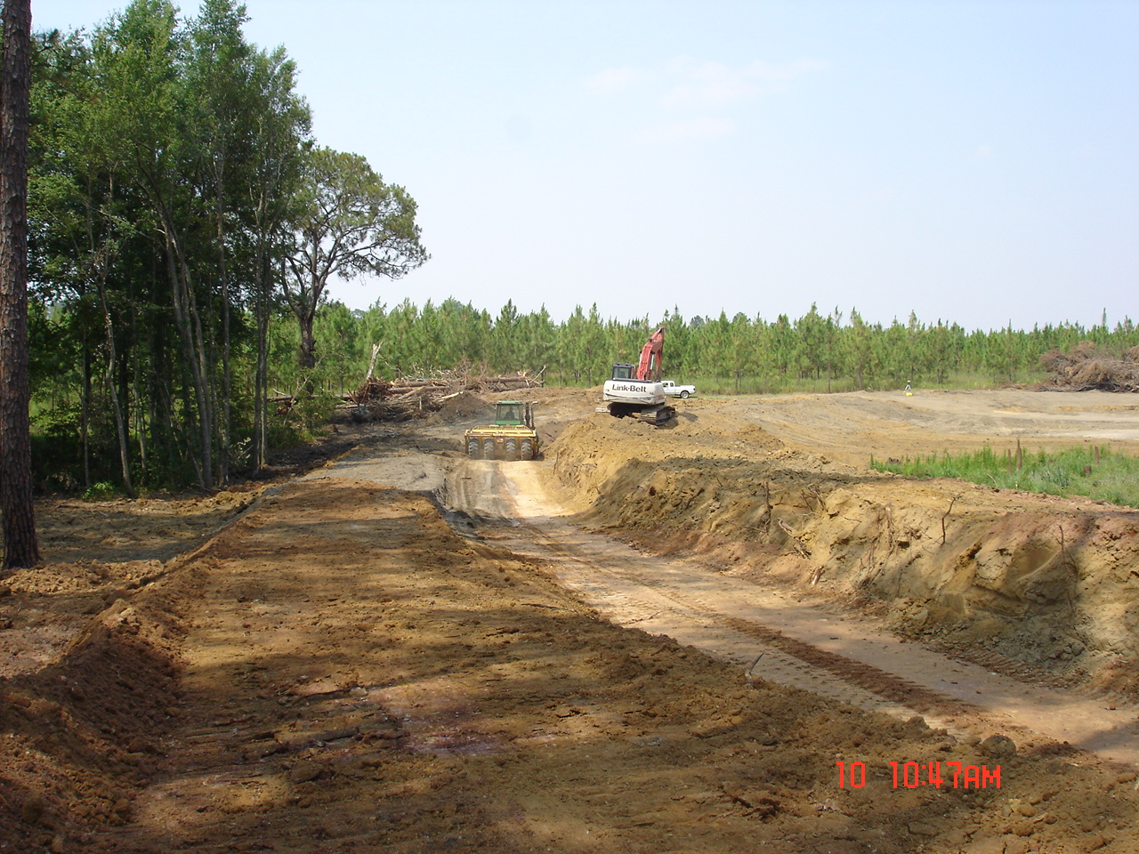

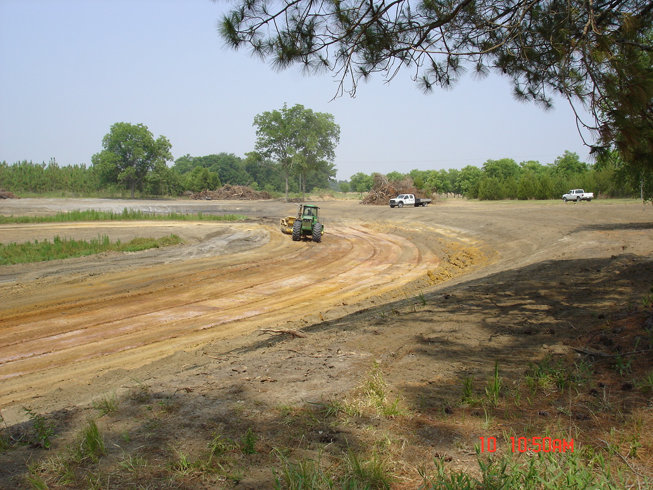

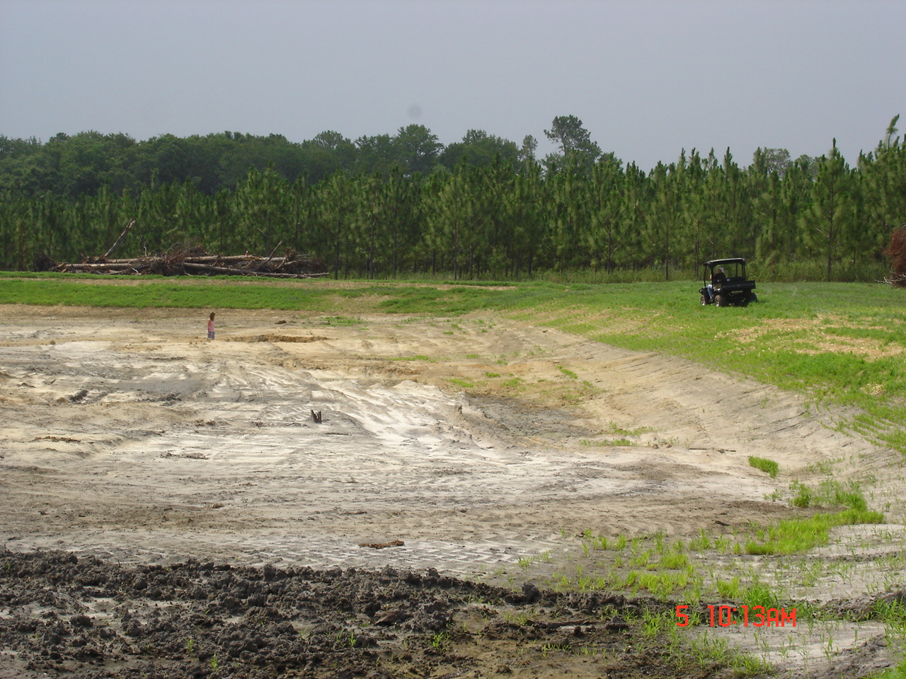

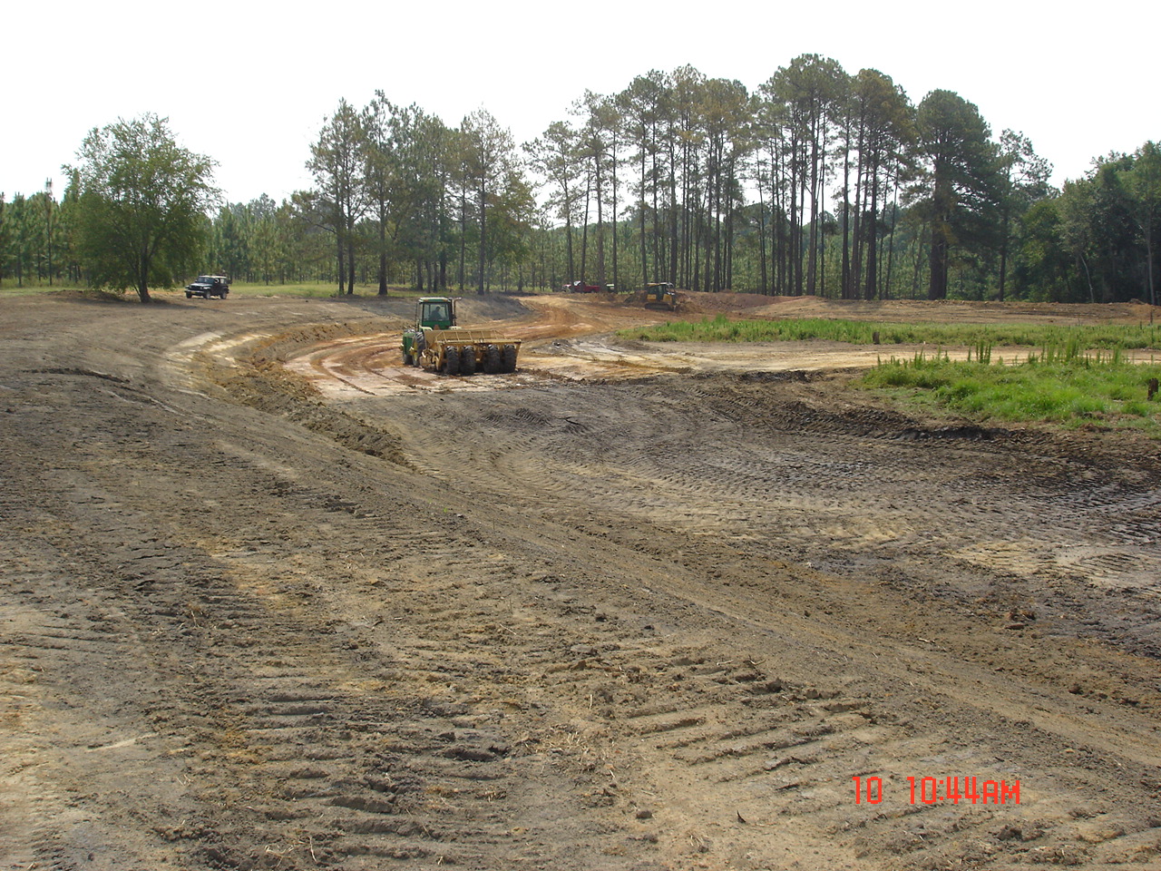

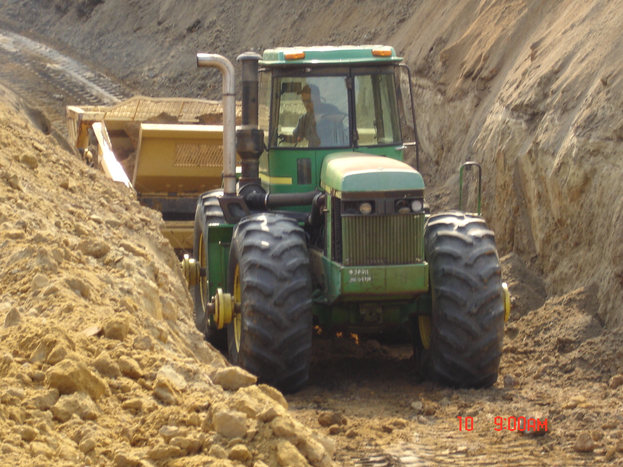

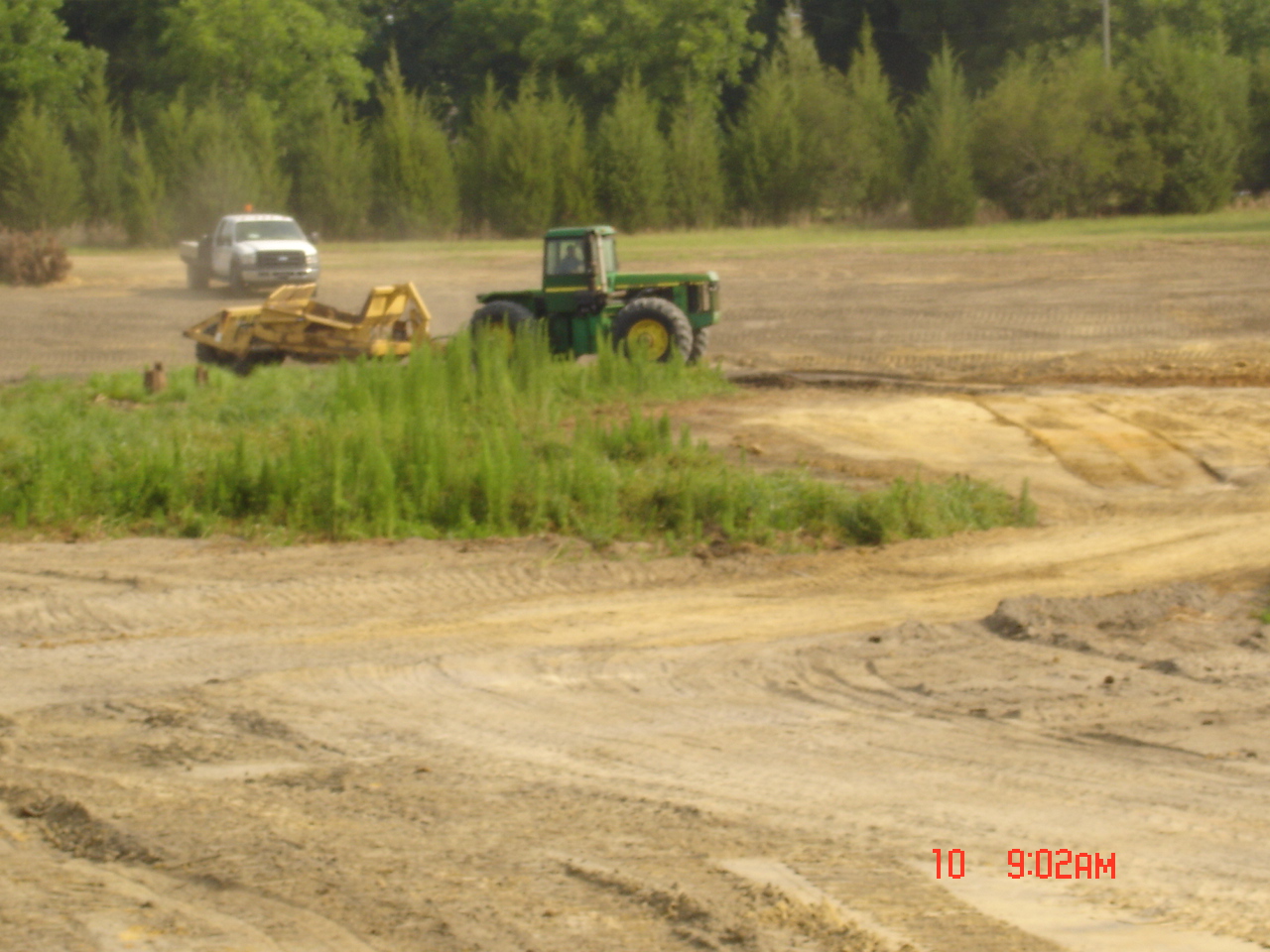

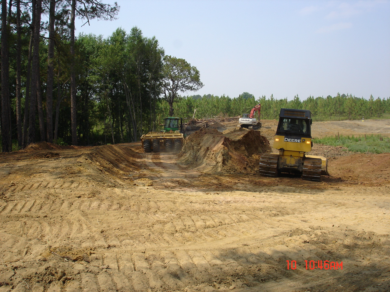

The pond project was completed in June but I'm just now making the time to show the rest of the story.
My brother and I went over there on the 6th to check on the progress. Stan had pretty much completed the final grade on the east, north, and most of the west bank, and was now roughing in the dam.
The first picture is of the east side and shows where Stan filled in the low area with clay. He will cover up the clay with top soil. The 2nd shows part of the north and west.
3rd and 4th shows the back and front sides of the roughed in dam.
The next 3 are some action shots of Stan. That would give me the willies.
A picture of my brother standing next to an old longleaf pine stump and lastly, a picture of the cleaned out spillway.

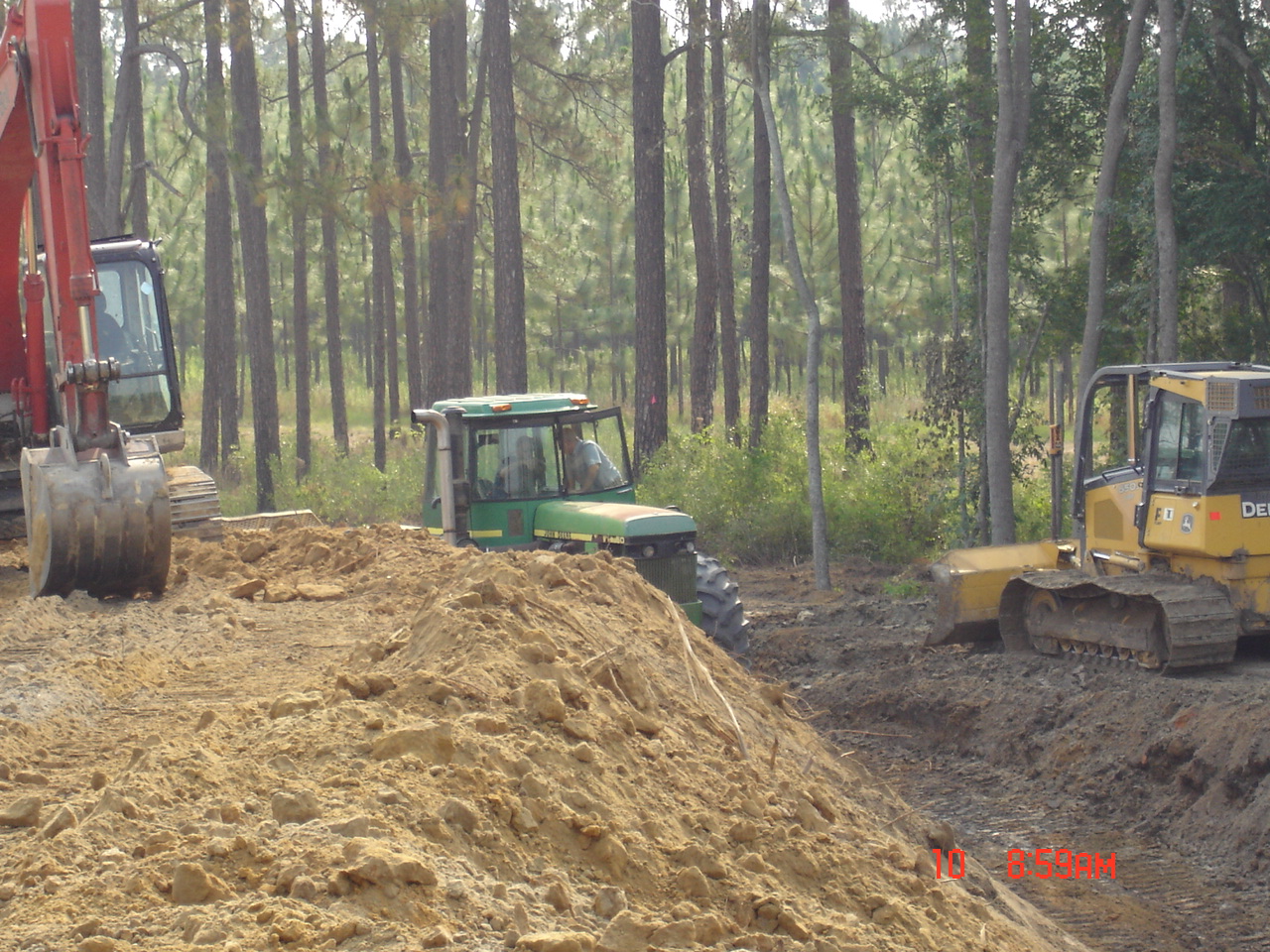

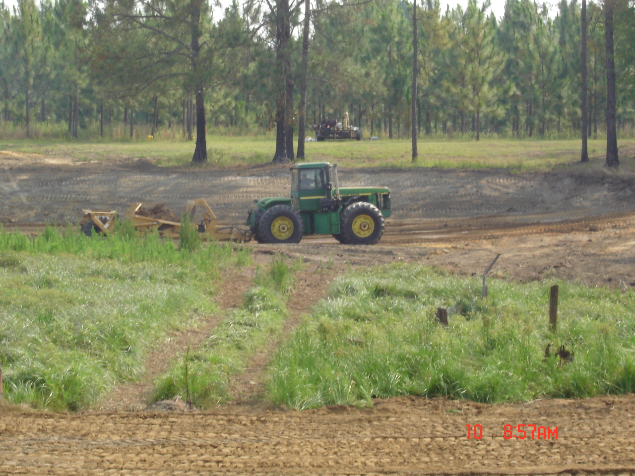

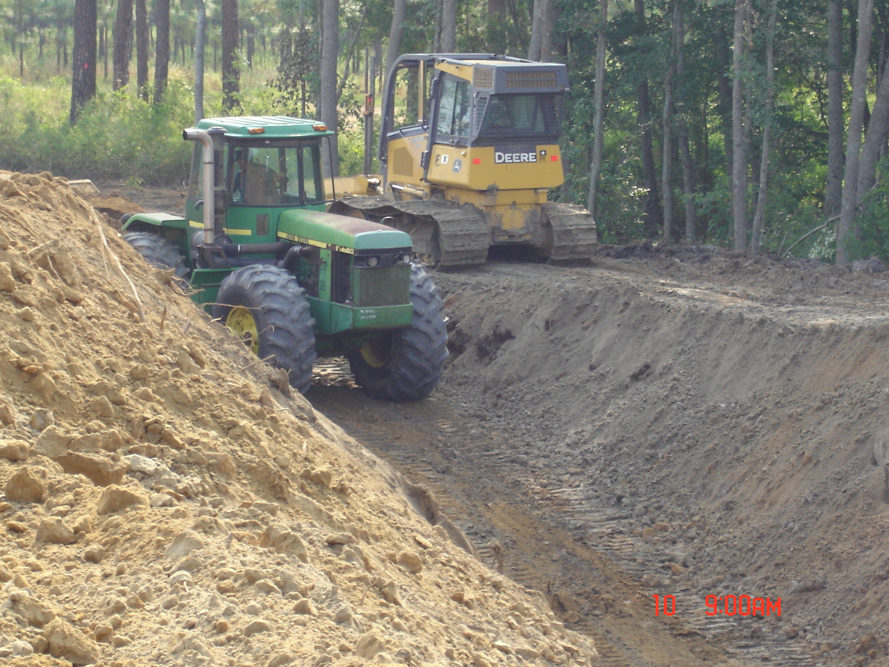

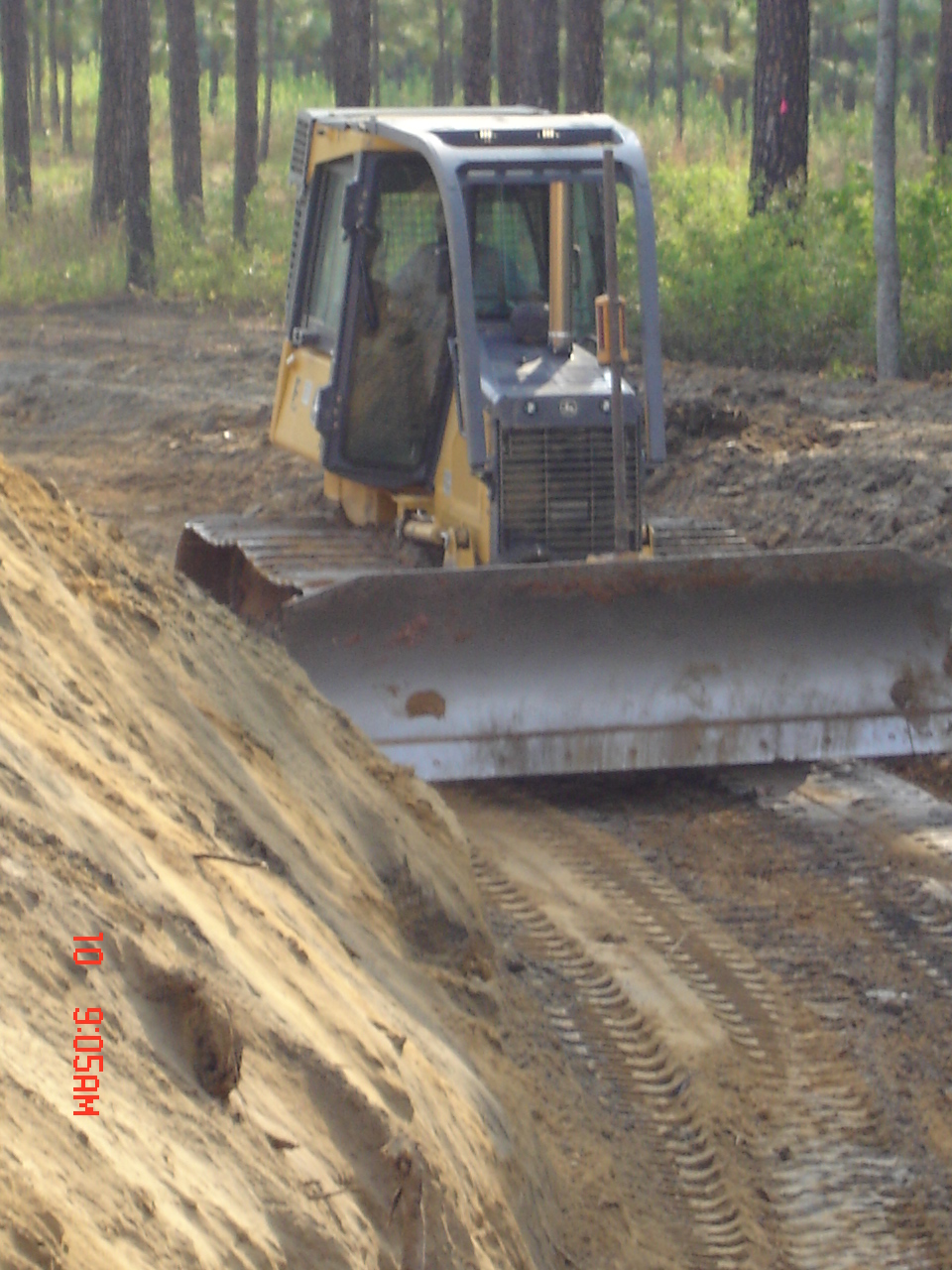

/ Pond re-do Part 2
#11
I'm went back a few days later to see the progress. I took a bunch of pictures during this project and I'm finding it difficult to decide which ones might be interesting to others and not bore anyone.
Anyway, it's the core-the-dam phase of the project. Stan was concerned that the clay may be too dry for it to pack down for the core but it rained just enough for that not to be a problem. He subed out the dirt pan work. I was told the dirt pan's capacity was 14 yards. The east half of the core was built up first, then the west half.
I did not get to see the core at its deepest but the neighbor took his wife on their 4 wheeler thru it and she told him to get her out of there, NOW!
Stan had determine that the clay on the east side of the pond was better than the clay on the west side. The dirt pan operator went round and round for several days building up the core. The 2nd to last picture shows just a bit of the left corner of the dirt pan.

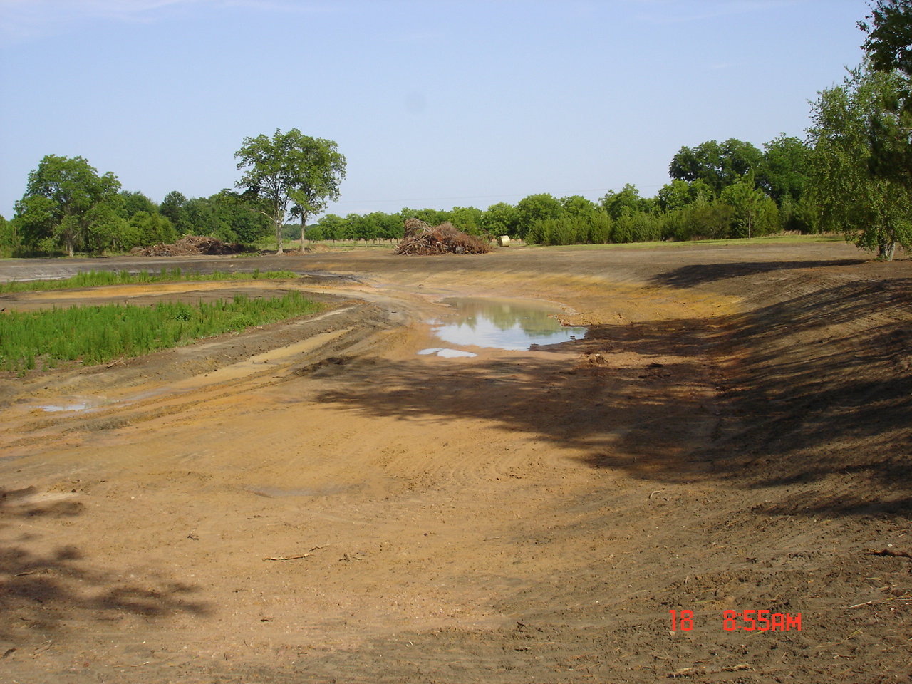

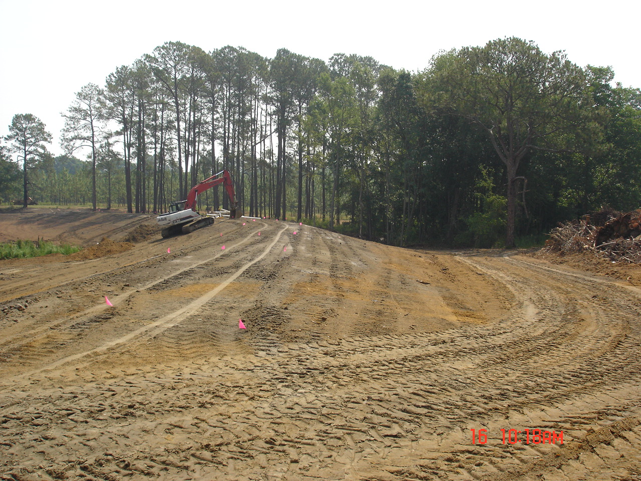

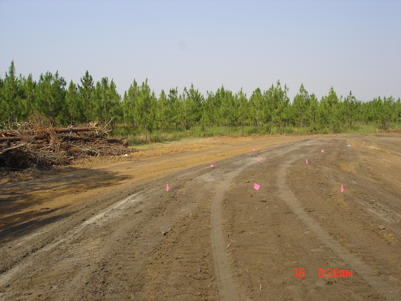

/ Pond re-do Part 2
#12

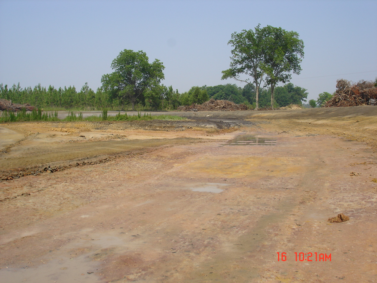

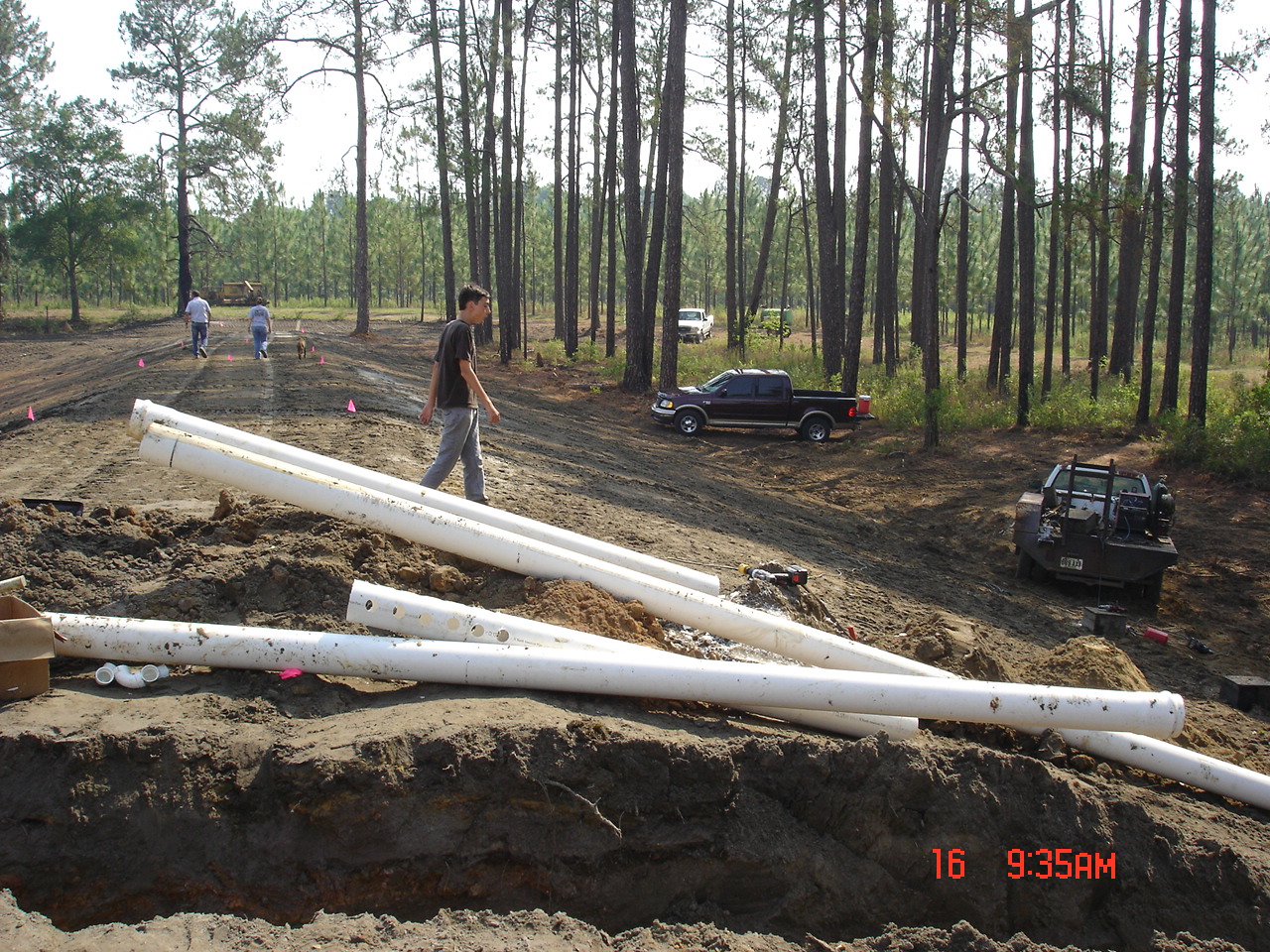

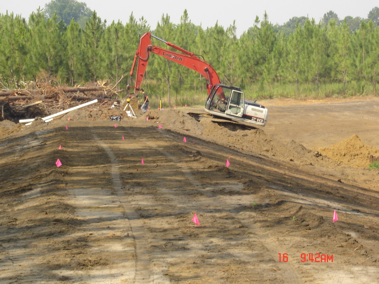

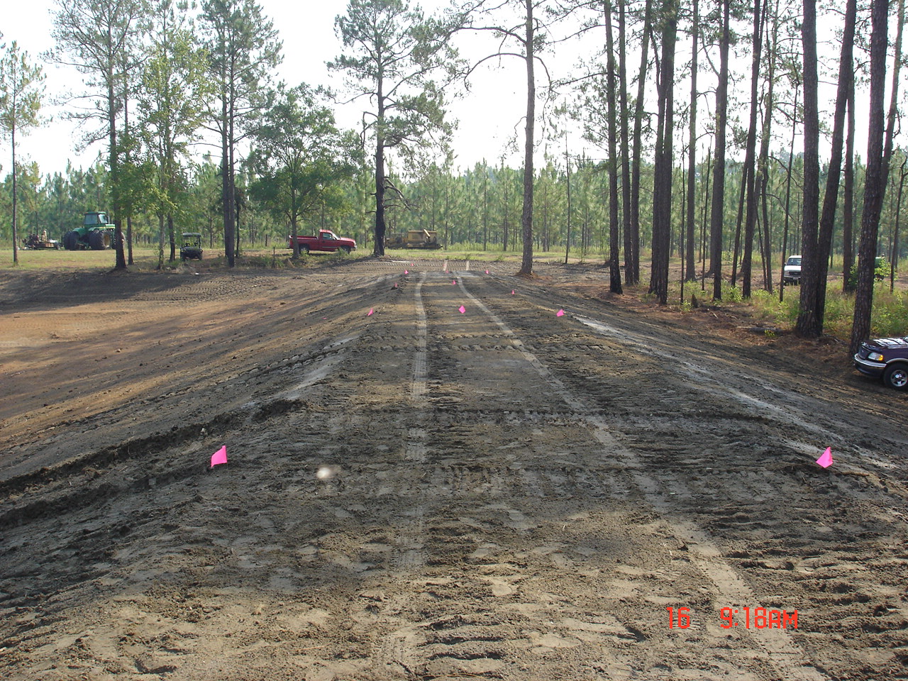

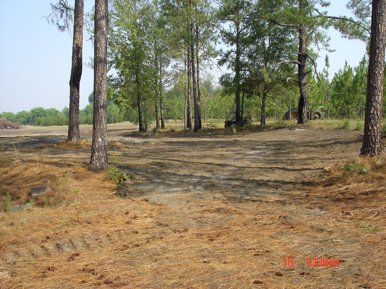

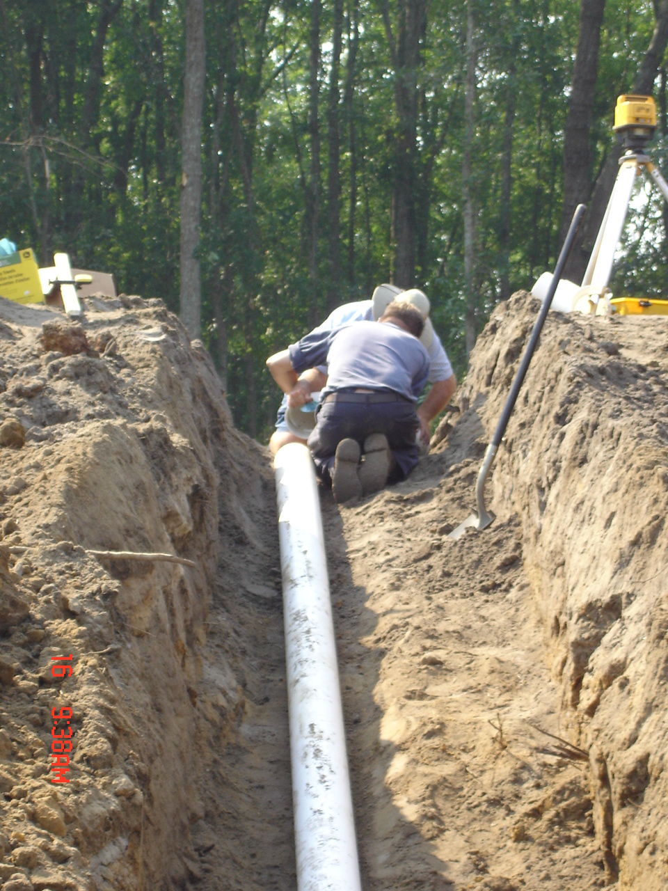

Back 6 days later...

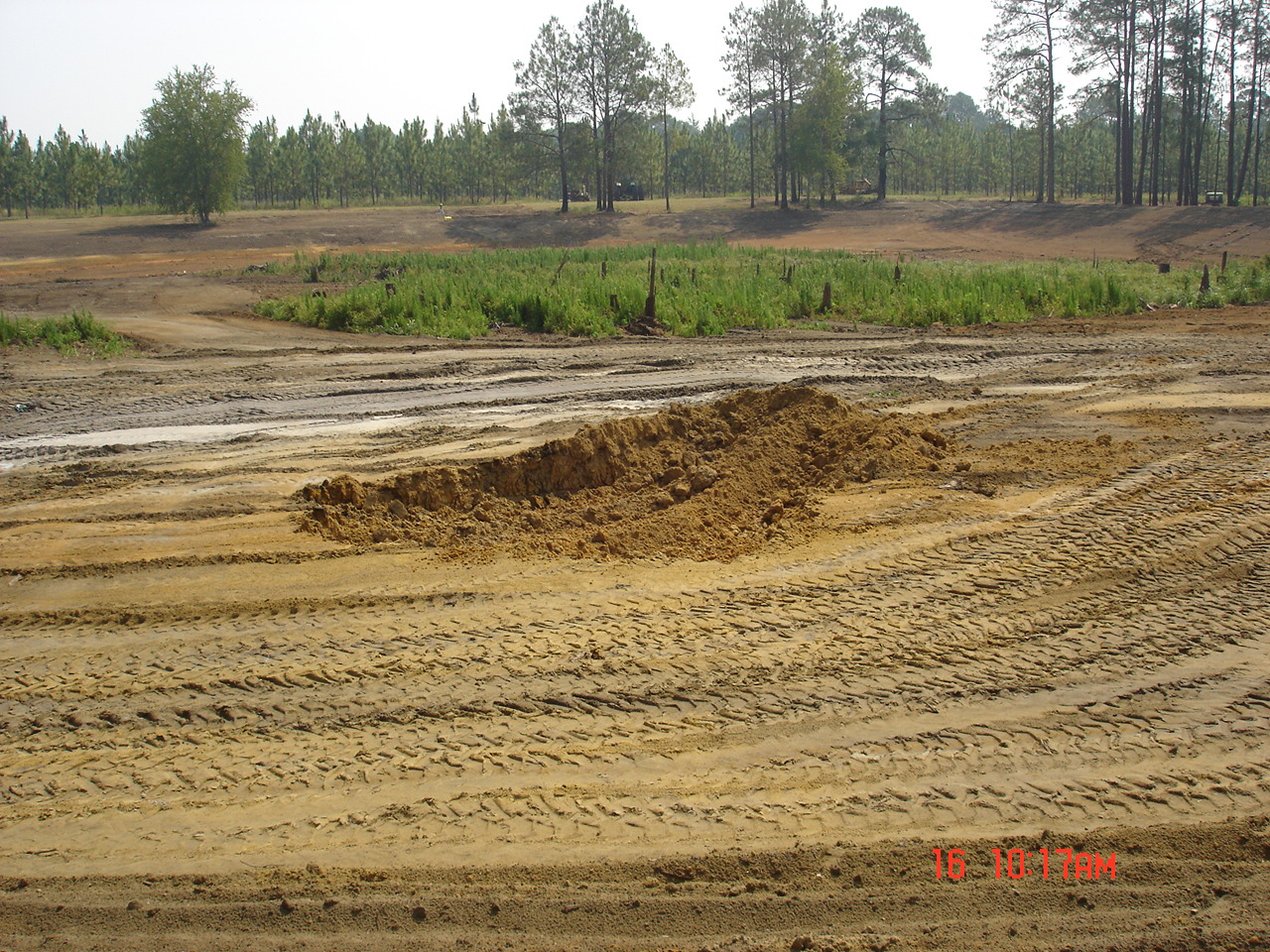

The moving of dirt is, for most part, over. The 1st and 2nd pictures show the east and west ends of the dam.
The next 4 show the siphon/overflow system being installed.
Then a picture of the spillway for emergency overflow, a fish hole, the back side of the dam and we had more rain.

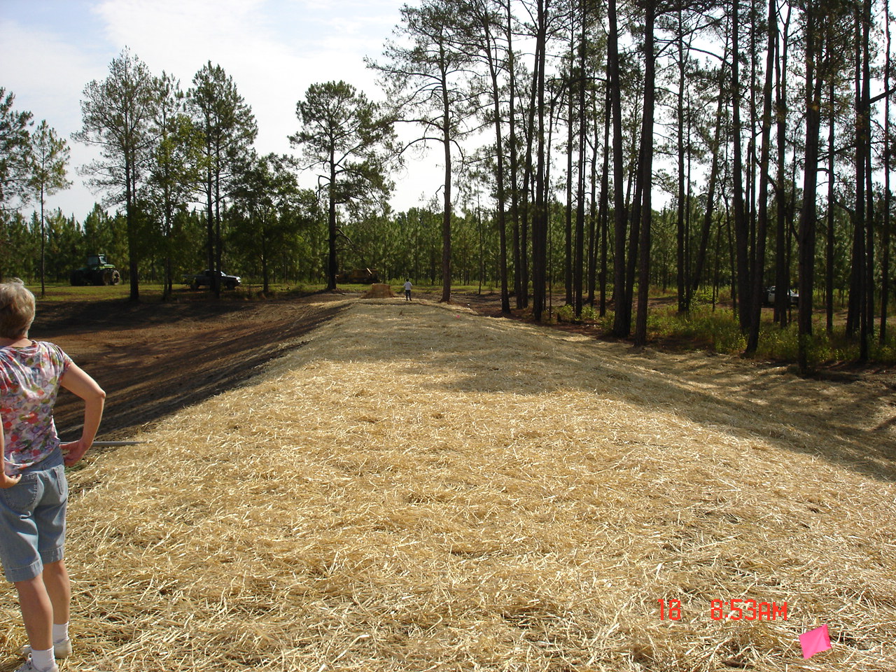

/ Pond re-do Part 2
#13

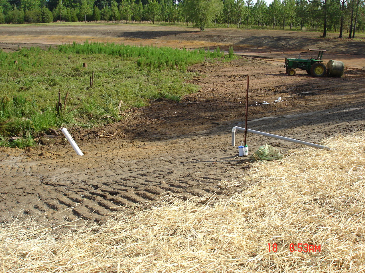

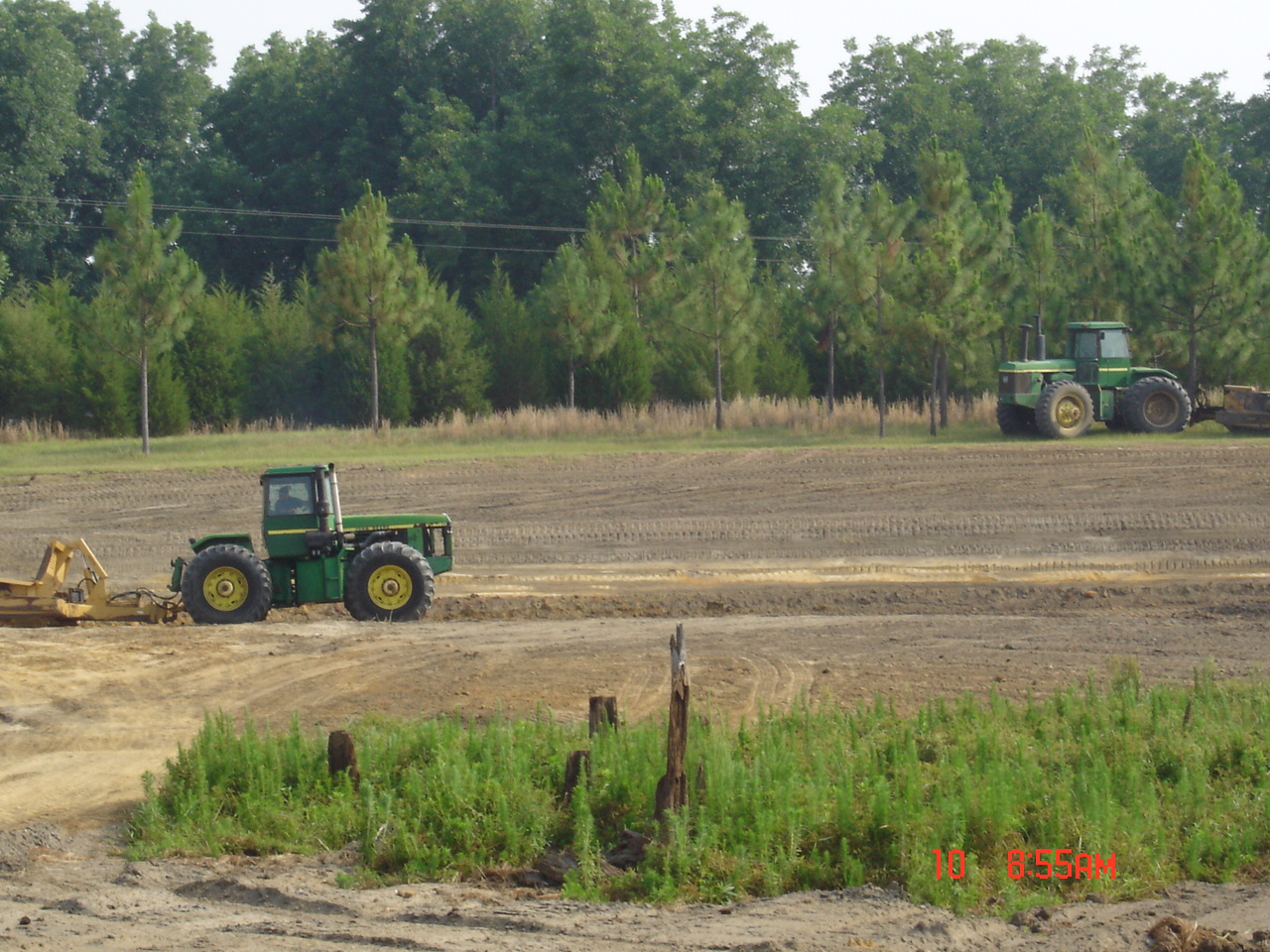

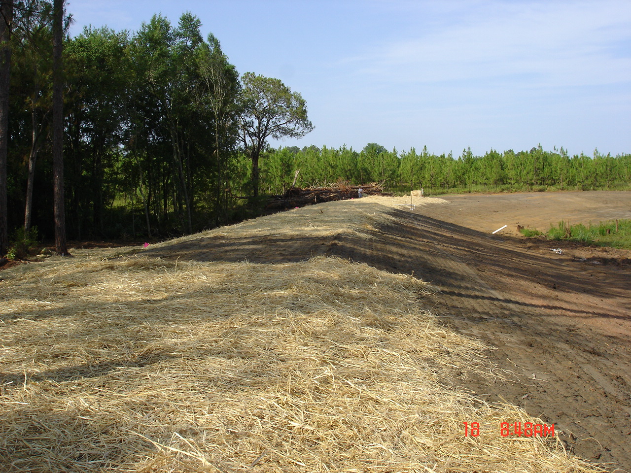

I went back 2 days late on the 18th of June. Straw was being scattered out. 1,000 lbs./acre of lime had been spread in and around the pond. Also, 100 lbs./acre of balanced fertilizer was spread around the pond and brown top millet and common Bermuda had been drilled.
Oh, we had more rain. The last picture shows the new pipe installed below the dam to make it easier to cross over from the east side to the west.

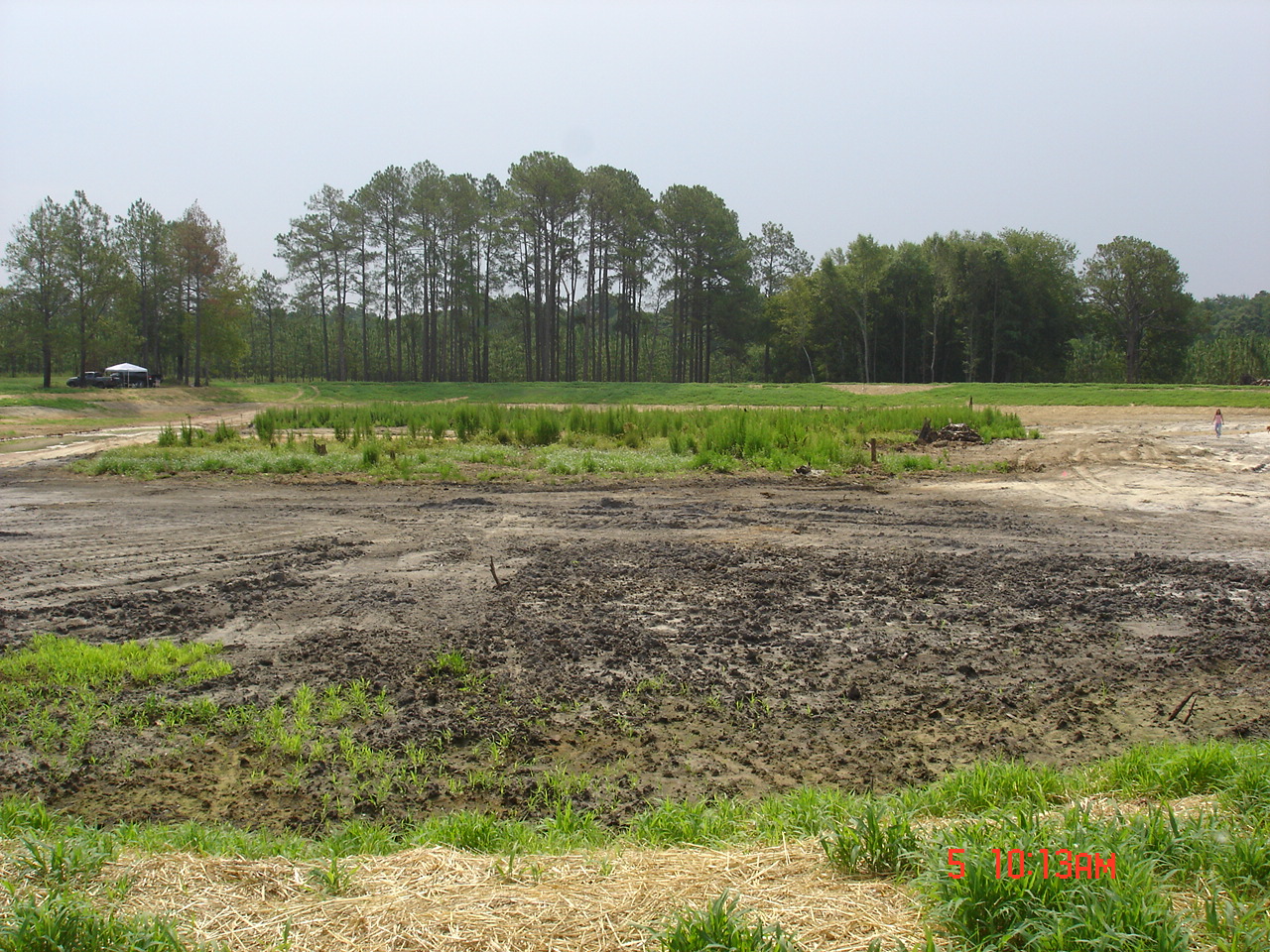

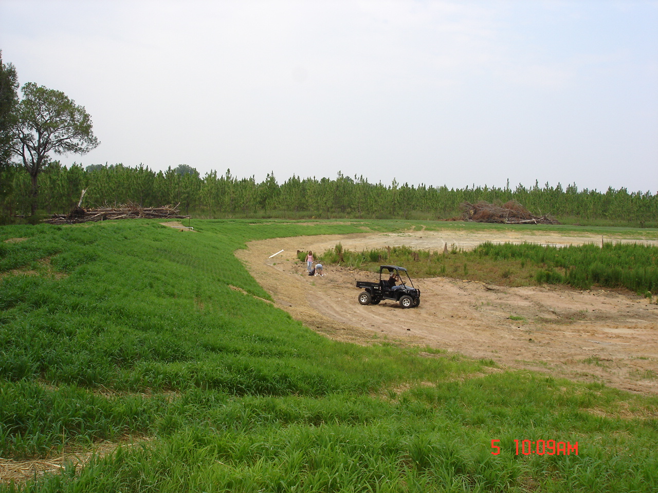

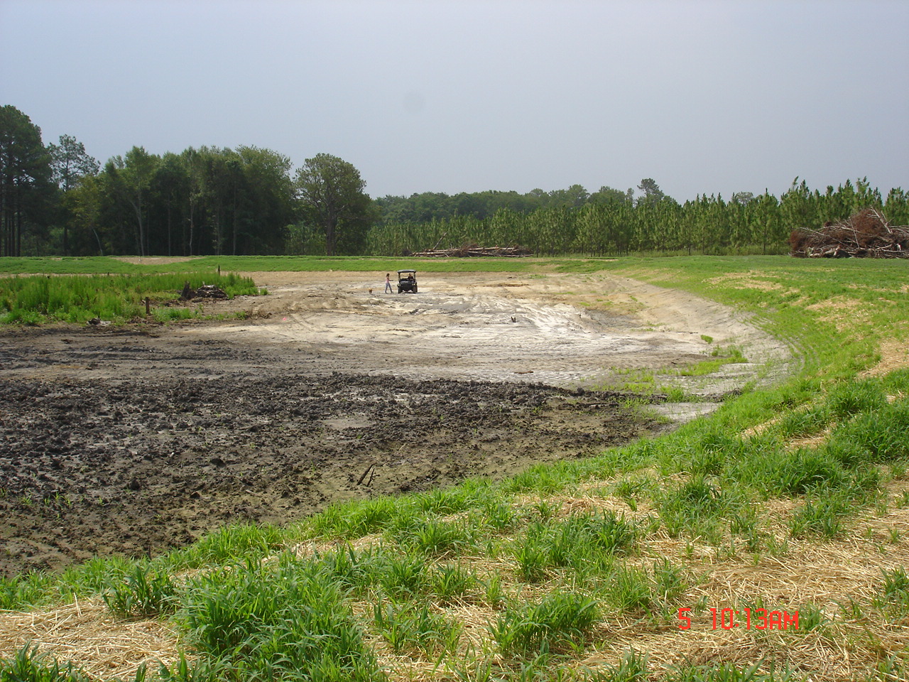

/ Pond re-do Part 2
#18
Thanks to all for the compliments. We were fortunate to have some great folks that helped get this project done: Stan, the pond man, Dale, the NRCS guy, and Greg, the neighbor. Also, lady luck was player, i.e. it didn't rain or it did rain just at the right times.
Kyle, The size of the pond was estimated at 3 acres but it sure looks bigger than that to me. My home is on a 300' x 300' lot and the pond looks to me like at least 2 of my lots could fit in it. But looks can be deceiving especially since my lot is wooded.

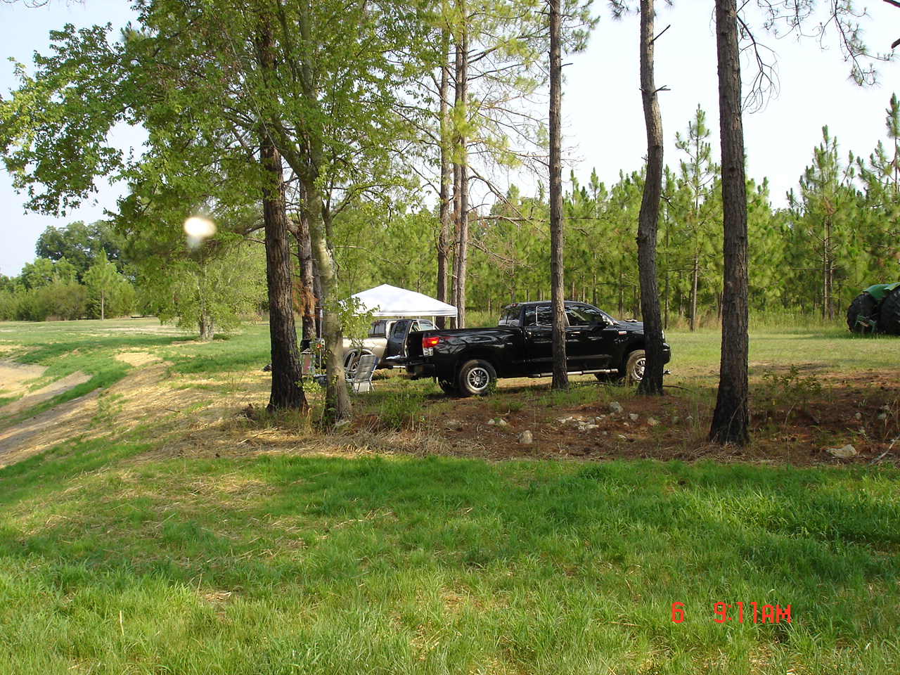

Dau. and SIL drove down 4th of July week for a visit and to check out the new pond. They were pleased with the results and now will try to figure out the best spot for their future home and then where to build the barn.
The millet seem to just leap out of the ground! I've attached a few pictures. :)
I'll upload a couple pictures when the pond is filled.

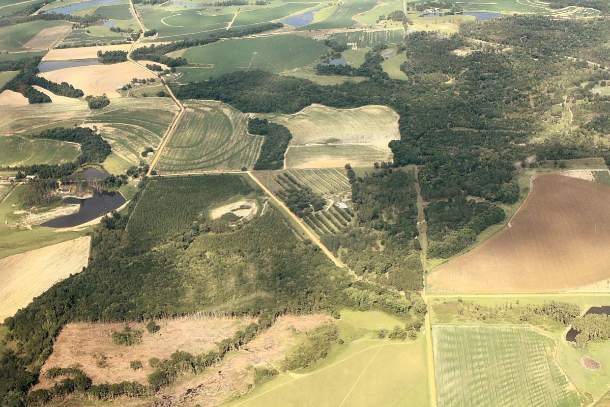

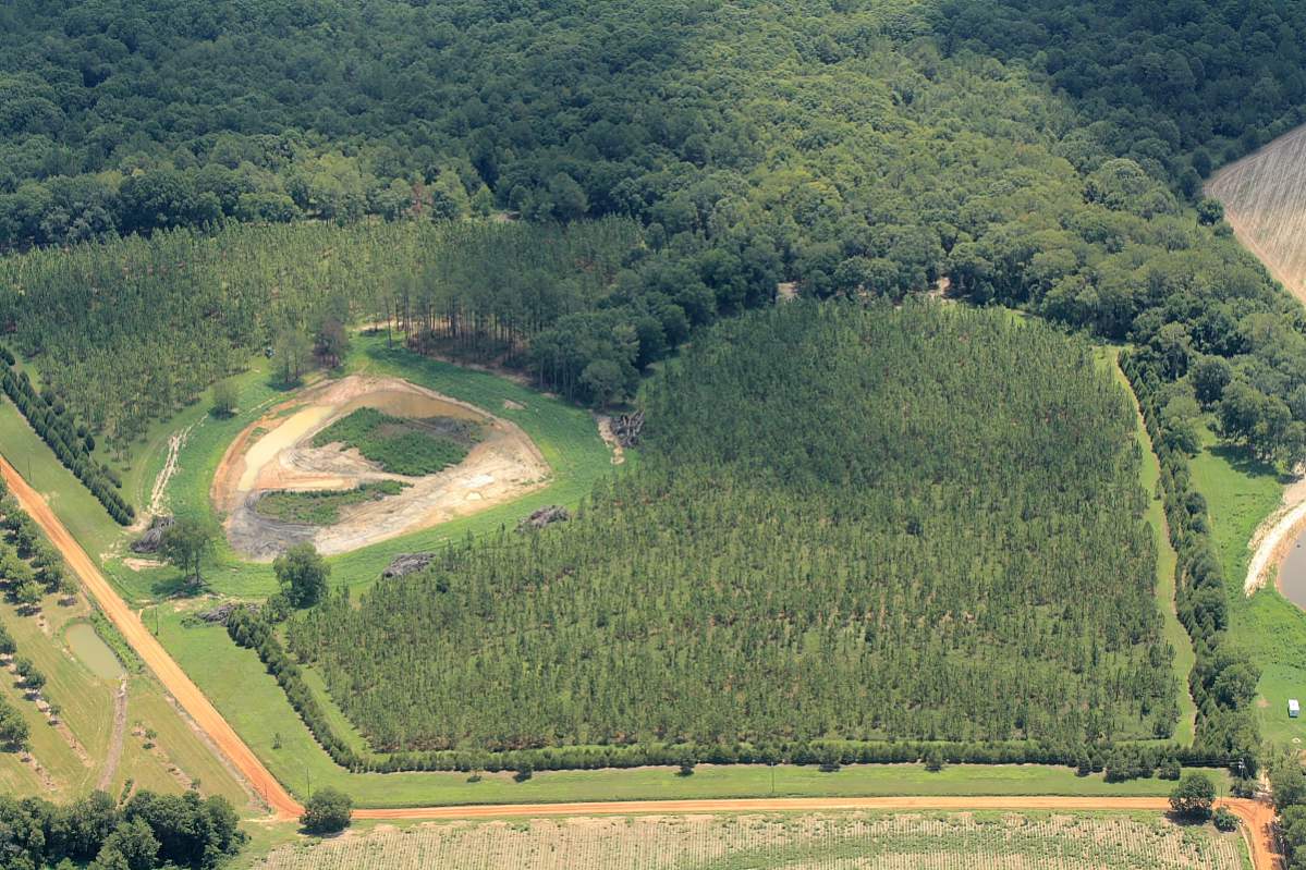

A friend of Michele's just happened to be flying by and took some pictures of the property. There is some water in the new pond. The road at the bottom of the first picture runs almost true north to south. The southern property line is to the right of the mowing lane, row of cedars then a thin row of native trees. It's a straight line on through the hardwood bottoms. The new dam is close to the center of the picture.
The second picture is from the east. The eastern property line is a straight line right at the clear cut area to the road on the right.

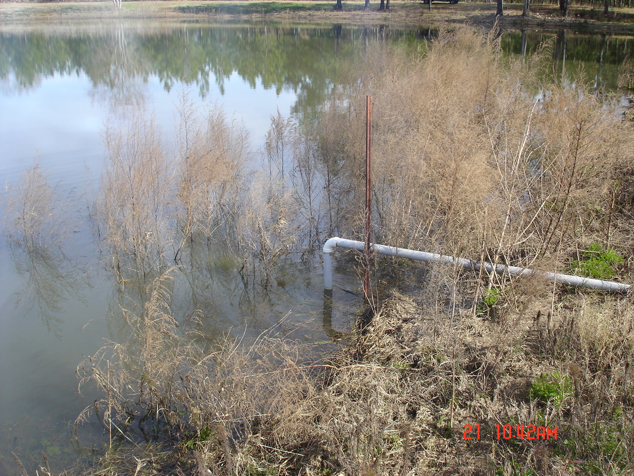

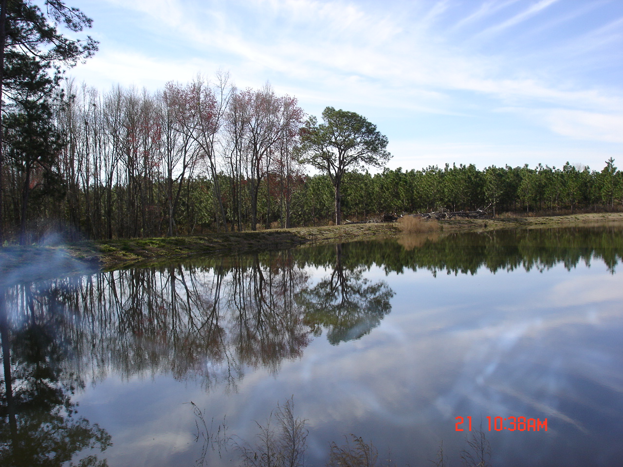

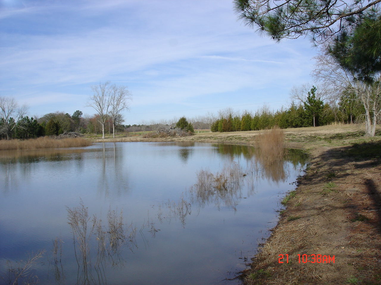

/ Pond re-do Part 2
#20

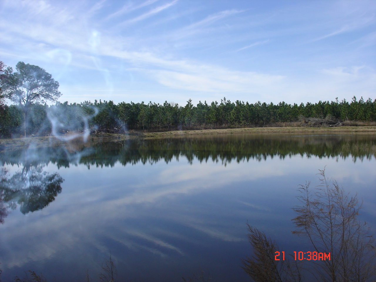

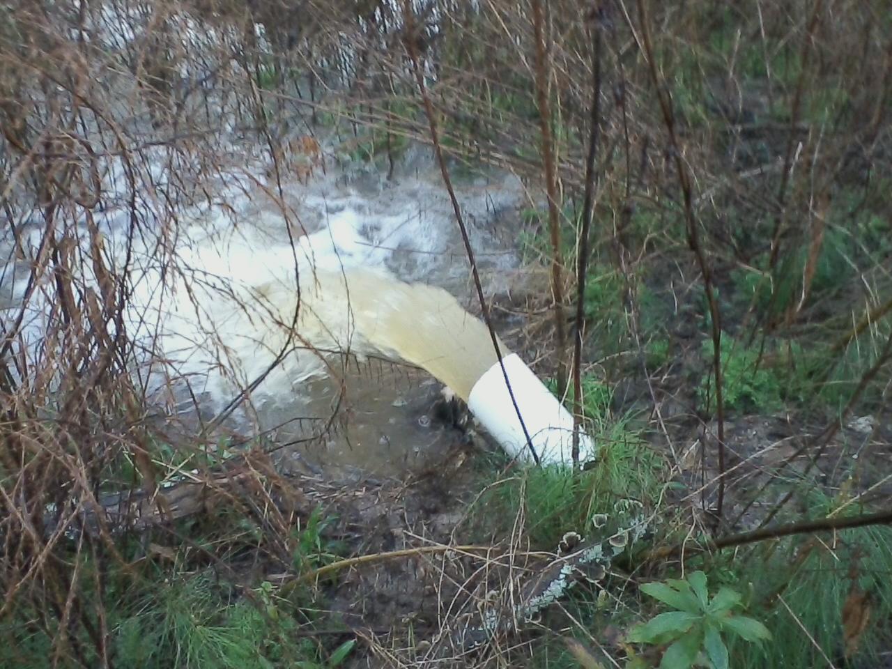

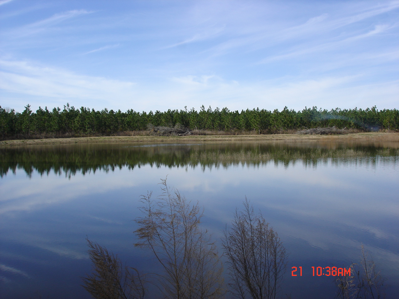

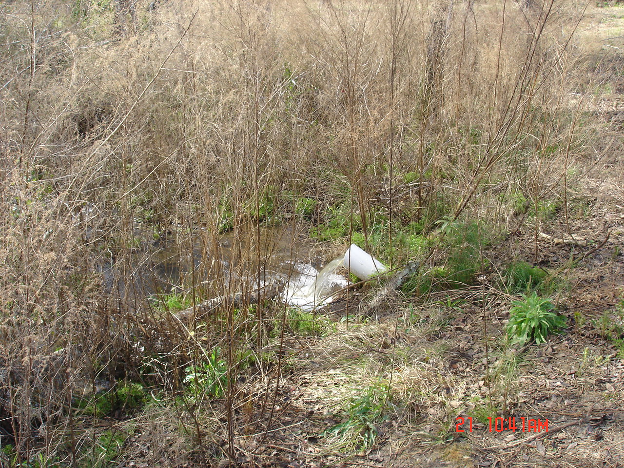

Greg, the neighbor, called Michele last Monday morning and told her the pond was beyond full after the 9 inches of rain we had last week (through Sunday). He sent her a few pictures that he took Monday morning. The following picture shows the water coming out of the overflow pipe.
I went over yesterday to check it out and took a few pictures. The first of 4 pictues is of the east side then working towards the west. The 5th picture was taken close to the west end of the dam. The first picture, from the debri on the bank, shows the high water mark, about a foot above the max, normal level. Water was up in the emergency overflow spillway about 15 feet.
Edit: I messed up loading the 5th picture. The 2nd pic is the one starting on the east side. The 1st on shows the dam from the east side.
Water was still coming out of the overflow pipe and the small pipe was sucking a little air then the water would cover the end of it.
