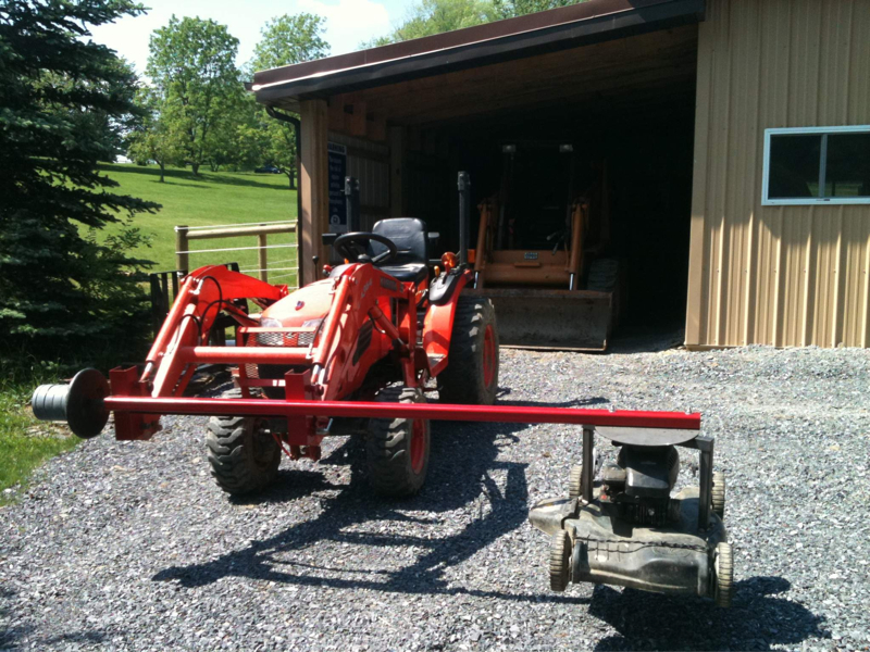

I have a pond approx 2acre and this is what i did. It's probably not the safest idea out there, but it works great, and it doesnt blow the trimmings into the water.<img src="http://www.tractorbynet.com/forums/attachment.php?attachmentid=271410"/>
Very clever and within budget. This is a crazy good idea, you could even put a few bolt holes in at a higher elevation on the far side of that tube steel to go down a slope. I also would point the chute backwards instead of at the driver. Is that 2" tube?

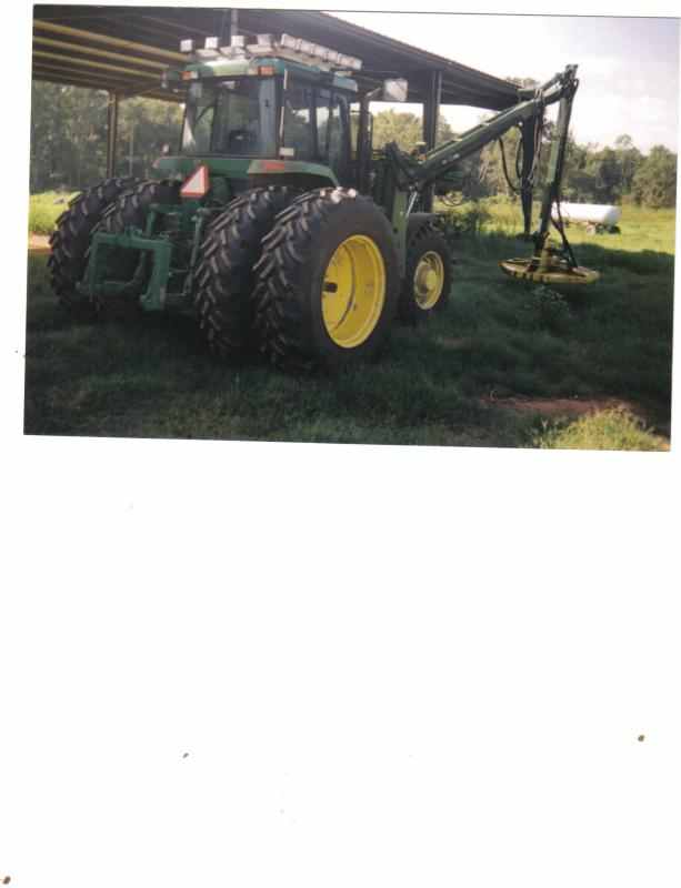

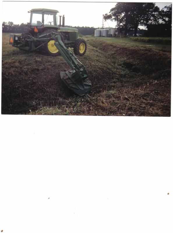

Unfortunately with about 4000' of creek edge taken over partially by brush I am looking at finding a used boom flail mower with about a 15' reach.
Picture from GreyRider attached below (didn't link in right for some reason)
You say boommower?

2 inch 1/4 square tube, i point the chute out to keep all the clippings out of the water. The only issue so far is that the grill on the tractor gets covered pretty quick.
