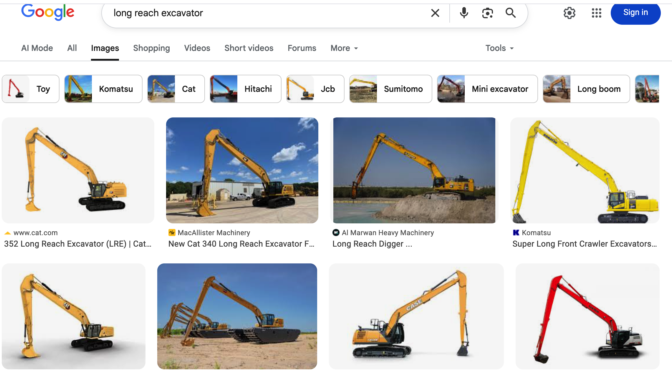

Southern Ontario. Figure 4' of muck for about 1/2+ acre pond. Backing on wetland so getting permission would be nearly impossible for mere mortals. The cheapest option would be to cut down all the trees on 3 sides and get a long reach excavator to dump the spoil on top - but those good'ol days are long gone.

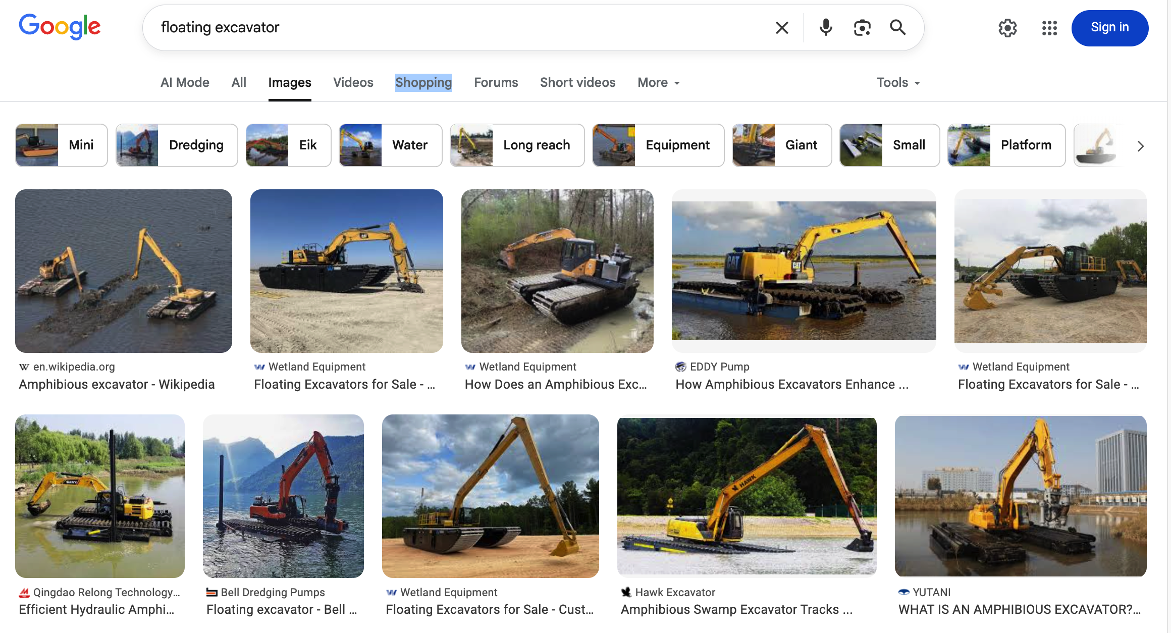

Maybe up to a couple of feet deep in spots. Starting to fill with cattails and phragmites. I'm sure there is room for the silt around the pond...
I've seen images online for the large floating dredges, I just don't know anything about them when it comes to smaller scales.
   / Pond dredging #8
I'd put a note up at the local feed store, or start talking heavy equipment operators. I suspect what you want is a barge someone made, designed to be trailered in a a couple of trailer loads that will take a small excavator with a long boom. This isn't exactly an uncommon problem.
The purpose built aquatic excavators aren't small, so that they require assembly on site in most instances. Still, I think they are neat machines.
