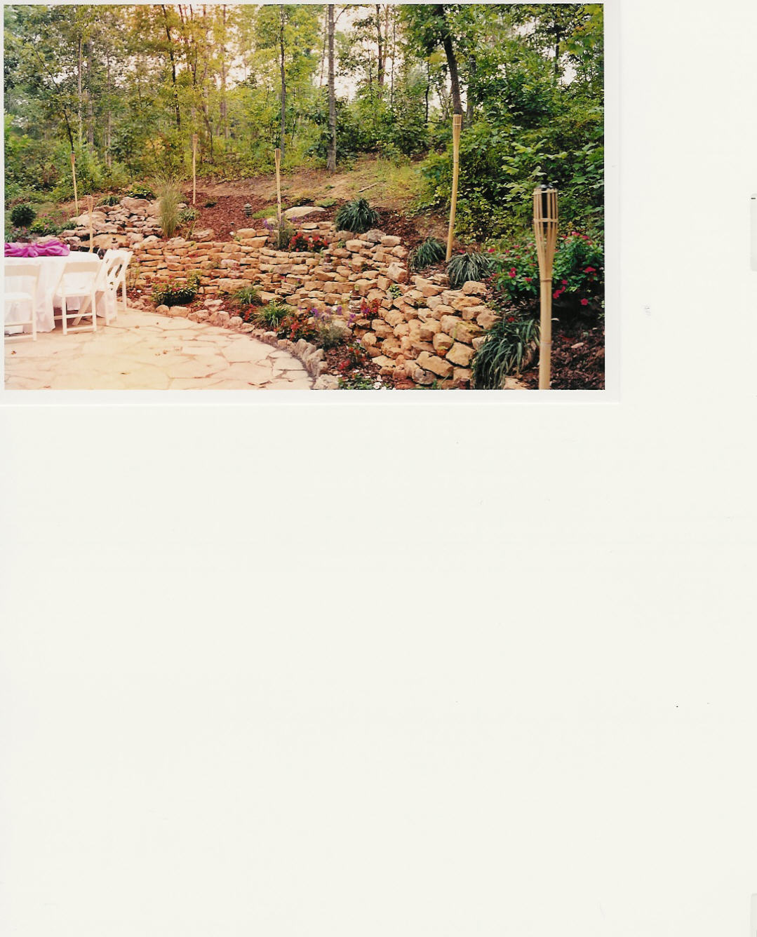

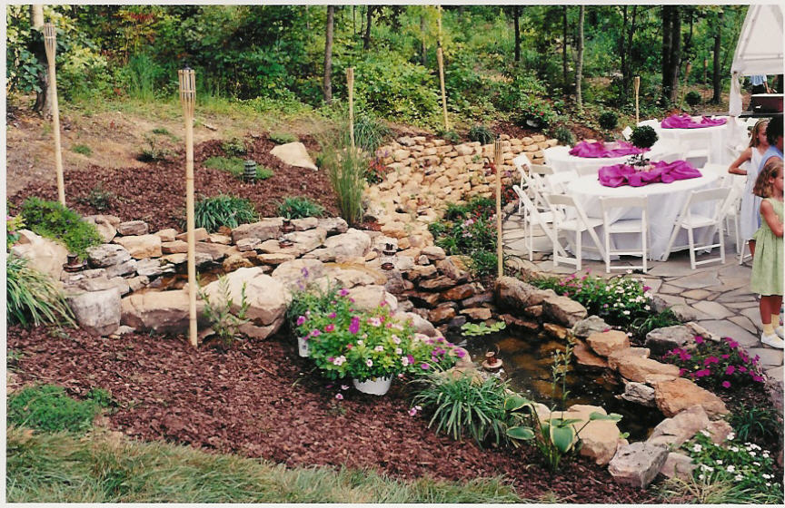

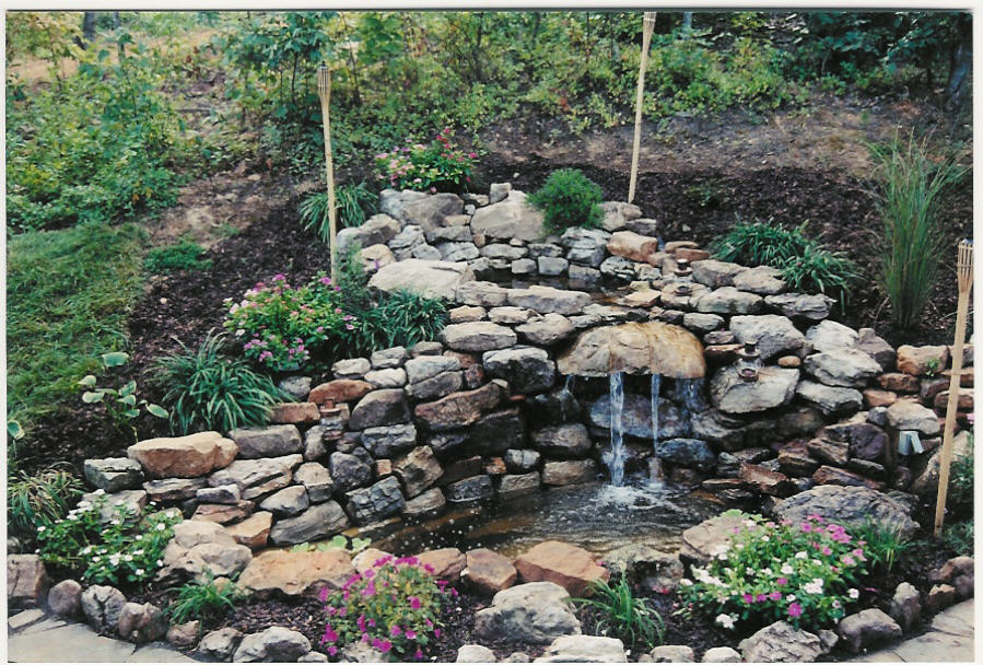

/ pond aka "water feature" #6
Here's one that the wife & I built on our back patio. Never done one before and never done one since.
Found the spillway rock on the farm (as well as ALL the rest of them) The spillway rock cleaved from a much larger rock & had a flat bottom. I just KNEW I might use it somewhere so I picked it up too.
Unseen in pic is a drain which the wife thought was CRAZY...until the first hard downpour we had and the patio flooded but the pond stayed the same! I'd suggest as been said, some kind of drainage.
I also now wish I'd put in some kind of automatic float valve. As it is, I have to toss the hose into it every now & then. Not a major deal but been nice to have it automated. (we've got several irrigation lines criss crossing the back and would have been VERY easy to add another line to the pond)
Pump: When I went to store & bought the pump, I TOLD them what it was for. A year later after the pump died, I went back, told them again what it was for and got a higher GPH pump (I think it might be 1/2 horse?)
It lasted a couple years and died last year.
This spring I finally went back to replace it again...they were out of stock. Good thing for me as I used that delay as my opportunity to go online & find out they've been selling me the wrong kind of pumps all along!! :mad:
Don't let them give you a sump pump with a float and on/off switch. Get a pump rated for continuous duty. Took me 2 dead pumps to learn that lesson and what irks me the most is, I was very candid about what I was doing and using it for. Point being, they (the "experts") should have known that a sump pump wasn't the right animal.
Don't do this... I originally put a 1-way valve in the middle of the pipes (under the rocks on the right side of pond) That fall when the leaves fell I realized how dumb it was to have put the valve in the MIDDLE of the pipe. I had to dig it up by hand, chop out the valve (and the plugged leaves) and patch it back & replace all the rocks. Though I now don't have a valve in it, if/when I DO put one in, I will put it on the exit portion of the pipes in the upper level, this way I'll have access to it instead of the absurdity of having it buried :rolleyes:
Might add that the wife & I got all this done in about 3 months from a 100% mud back patio to what you see here, just in time for our wedding that we had on the patio. :D
I worked like a DOG during that time frame to get it done. In fact, these pictures were taken the day of our wedding
looks like you used a "tarp type" liner as opposed to a preformed plastic "pool"?
yours is a submersible continous duty pump? or do you have an area underground that hids your "dry" pump?
/ pond aka "water feature" #8
You are correct, we used two sections of that rubber tarp stuff made for this application. Used the glue or what ever it is, to seal them (also made the seam as close to the waterfall as I could so each pond would be a single piece.
The pump is a submersible continuous duty. I think it's a 1/2 horse (plugs into 110 volt) I've got some rocks that I put over the top of the pump to hide it visually. I made a ledge for it to sit under but by the time I put the pipes onto it, the ledge wasn't high enough for it to slide under :rolleyes: . Live & learn!
