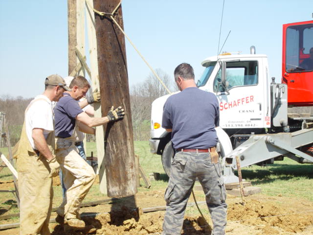

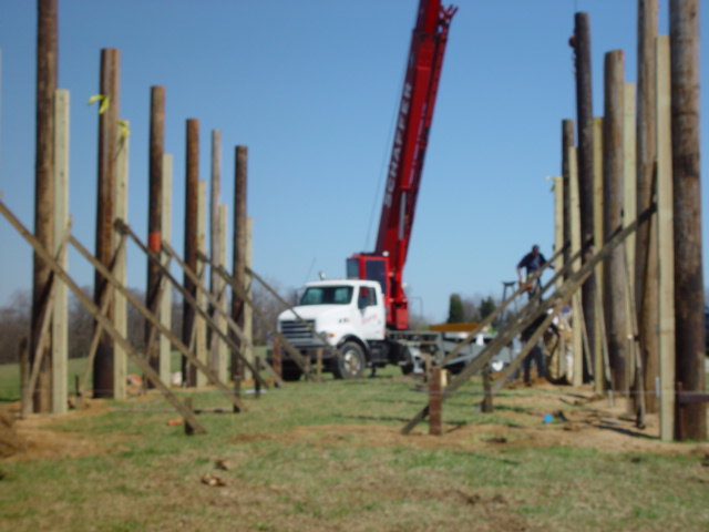

I was worried about wind shear with 18' walls. These are the posts I used. 12" diameter utility poles with 18" diameter bases 6' in the ground on a 2' x 8" thick footer. 10' OC. Yes, I do store hay in the loft. Approx 1500 bales.
DW
