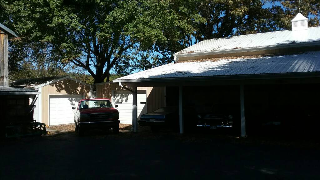

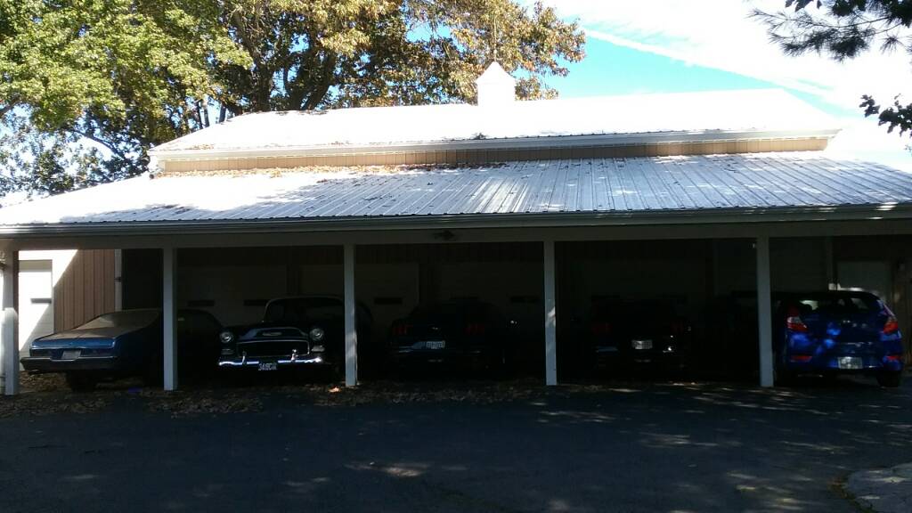

I spoke with owner who said all the other buildings they built for me since 1985 are 29 guage, on 24" centers. I've walked all over the roofs, never had problems and had 3ft snowdrifts.
I was assuming the first one was 26 gauge. I just didn't know how big a difference it would be.
Here are pictures. He can price it for me.
This 30x40 will have just one 12x12 sliding metal door, and 36x36 cupola with ridge vent. Thanks any thoughts! 20181017_113804.jpeg20181017_113811.jpeg20181017_113551.jpeg20181017_114654.jpeg
