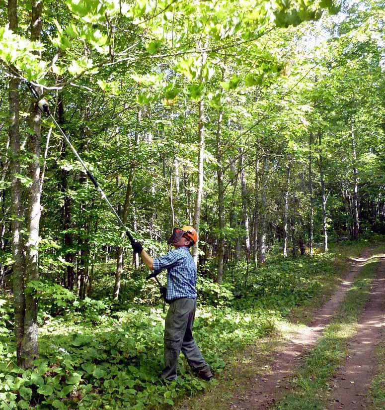

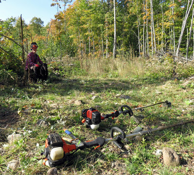

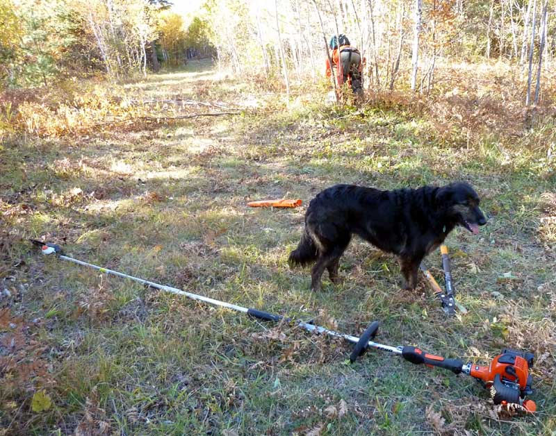

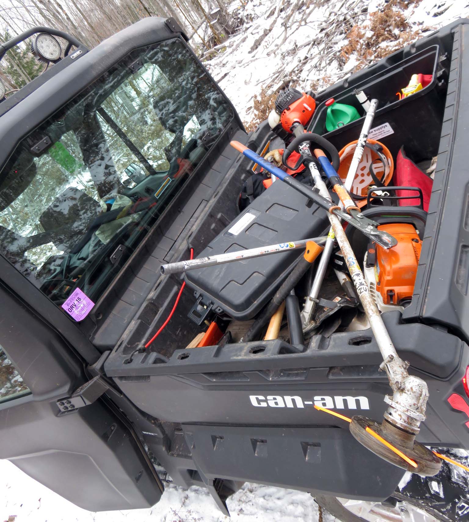

I think you'll do well with a Echo. Please report back after you put it to use. As reported earlier, we have several units we use here. I'll post a few photo's of them at work. Gee, its still winter here but they sure remind me of summer.
