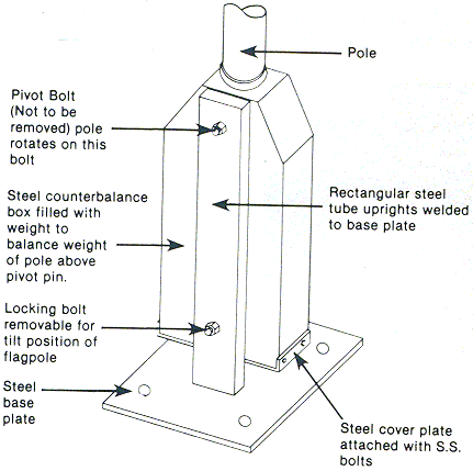

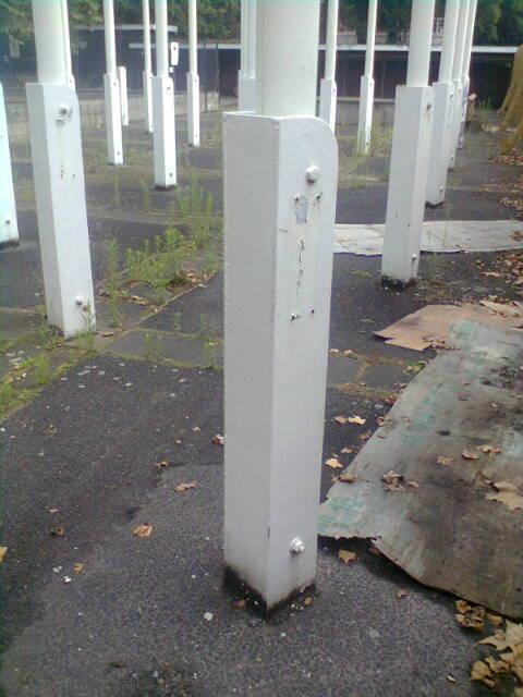

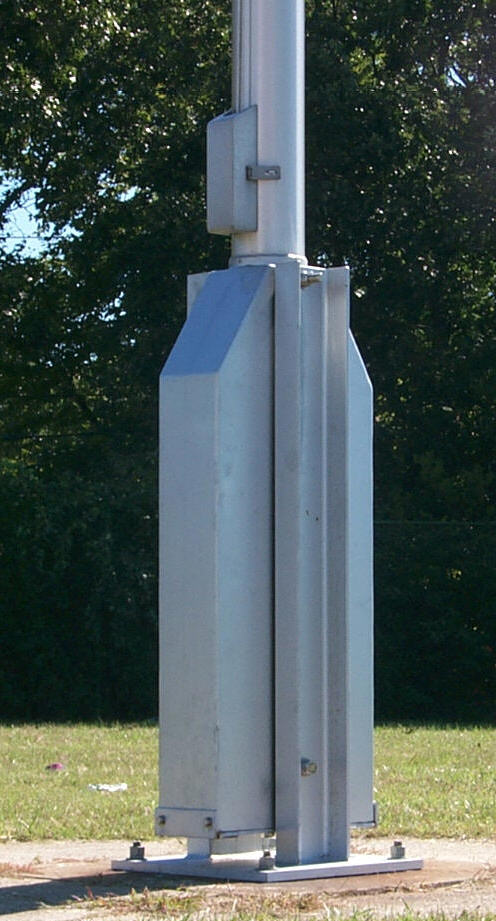

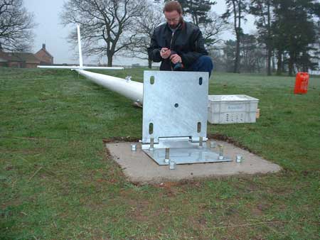

Some hinges:
cpfghb33ih_-04_base-open_33ft-high-pressure-fiberglass-flagpole-with-hinge-base-and-internal-hal.jpg
   / Pole puller #17
Make a hinge before lowering it.
Mark the pole about 2 feet high.
Bolt a 4 foot channel on each side. Two bolts above the mark, two below.
Cut the pole at the mark, with a wide gap so the end can pivot.
Remove one of the bolts and lower the pole.
Bruce
   / Pole puller #18
If it was me i would fab a hinge and weld it on then prop the pole and cut it you can then lower it and do the repair
Then weld a flange on the other side so you can raise it back up and bolt it back together
