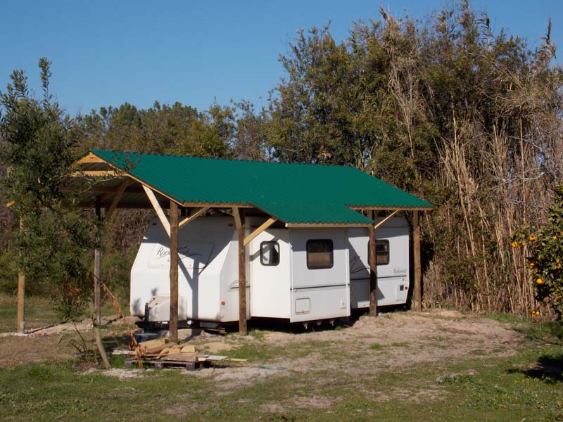

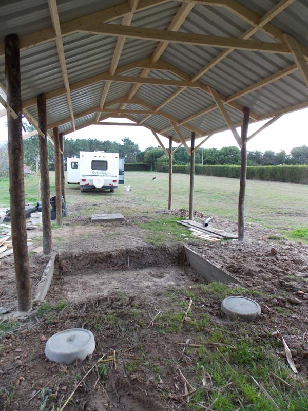

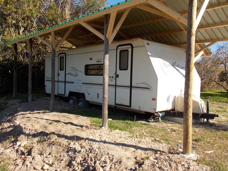

I dug holes 8" diameter and 3' deep; that was a real chore. I made a tool to help.
Guess I'll post that in the appropriate thread...
I also had water in the holes the next day. I puled out the water with a shop vac and poured concrete it, then set the pole [5-6" pressure treated rough round], and braced overnight.
This is an open RV shelter, with a clear view of the Atlantic ocean. We get some pretty hard wind; so far, no movement. I used a lot of screws, all stainless, and lots of triangulation.
