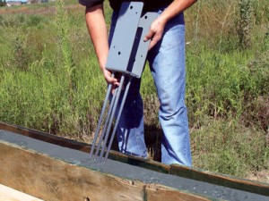

Check these out.
Perma-Column | Permanent Foundation Systems | Home
If there is that much water, I'd be hesitant about subjecting wood to being saturated all the time. Concrete is far more durable in the ground. When I build my shop, the only thing i will put below grade is concrete .

Pictures:
[video]http://polebarnsdirect.com/customizations/pole-barn-perma-columns/[/video]
More info.
   / Pole construction... my dilmena with concrete piers vs. in ground #10
Pictures:
More info.
That also looks like a good idea for existing posts that have rotted off at ground level, but have a floor slab poured around them.
Cut the rotted post flush with floor, slide post bracket assembly under, drill expansion bolt holes in floor, install expansion bolts, and put lags into sides of post.
