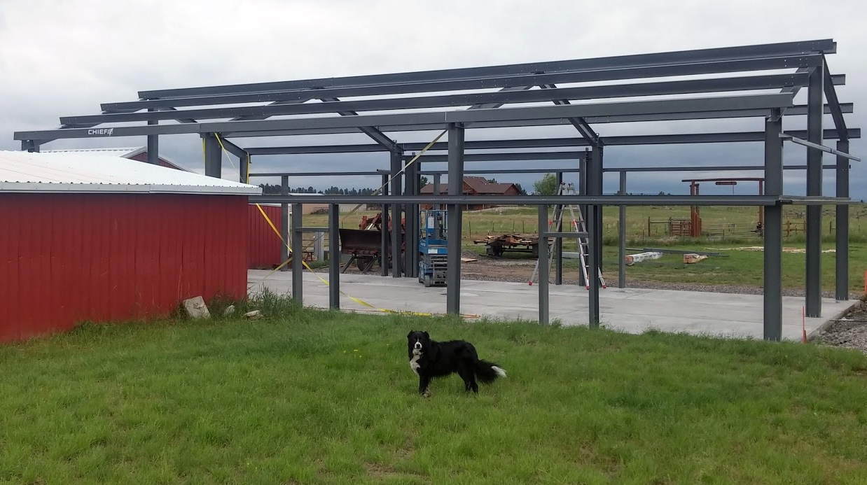

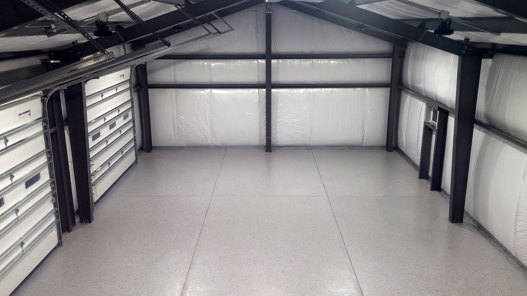

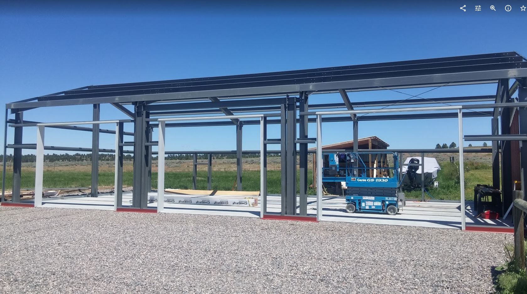

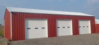

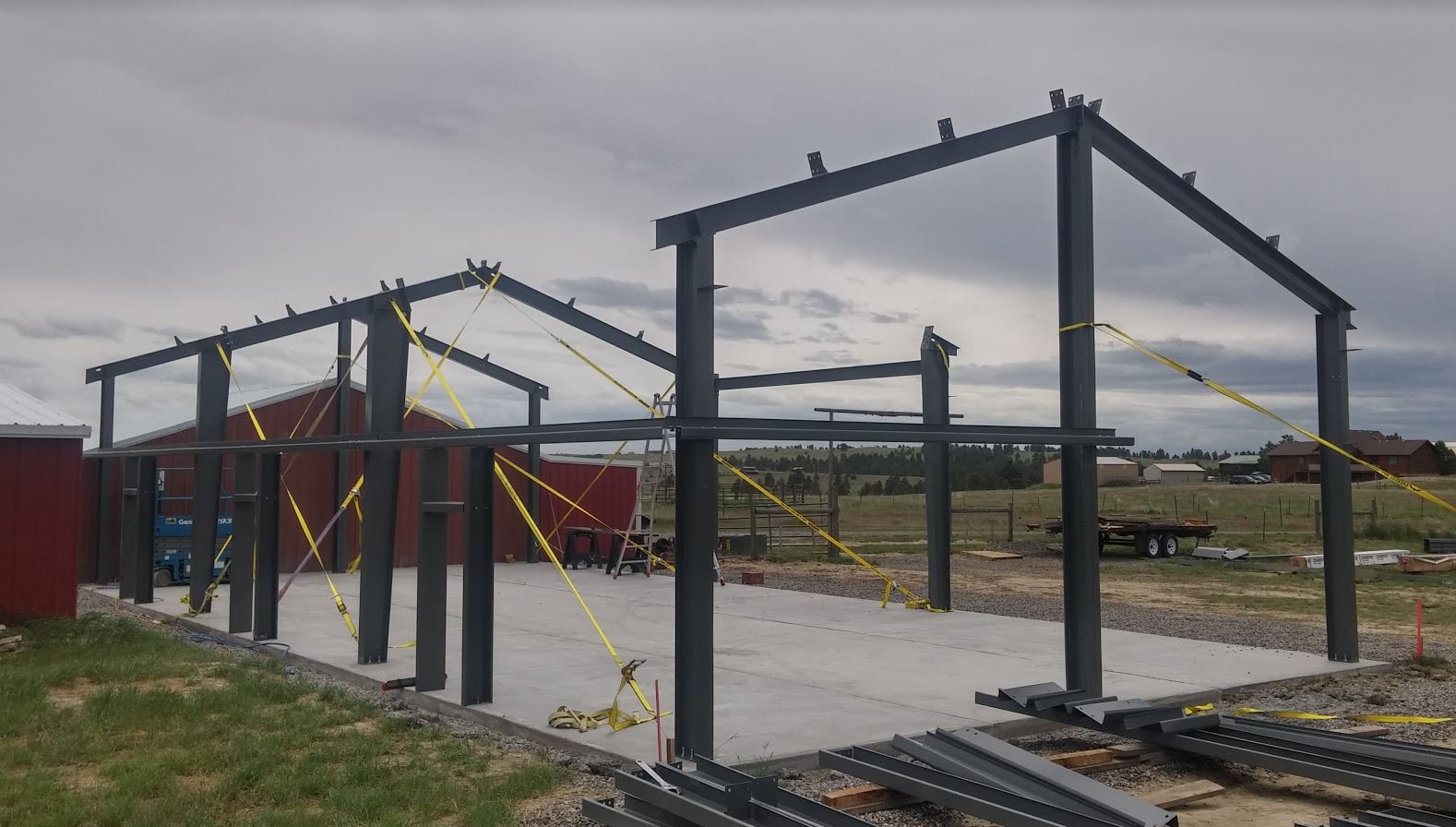

/ Pole building or metal building #5

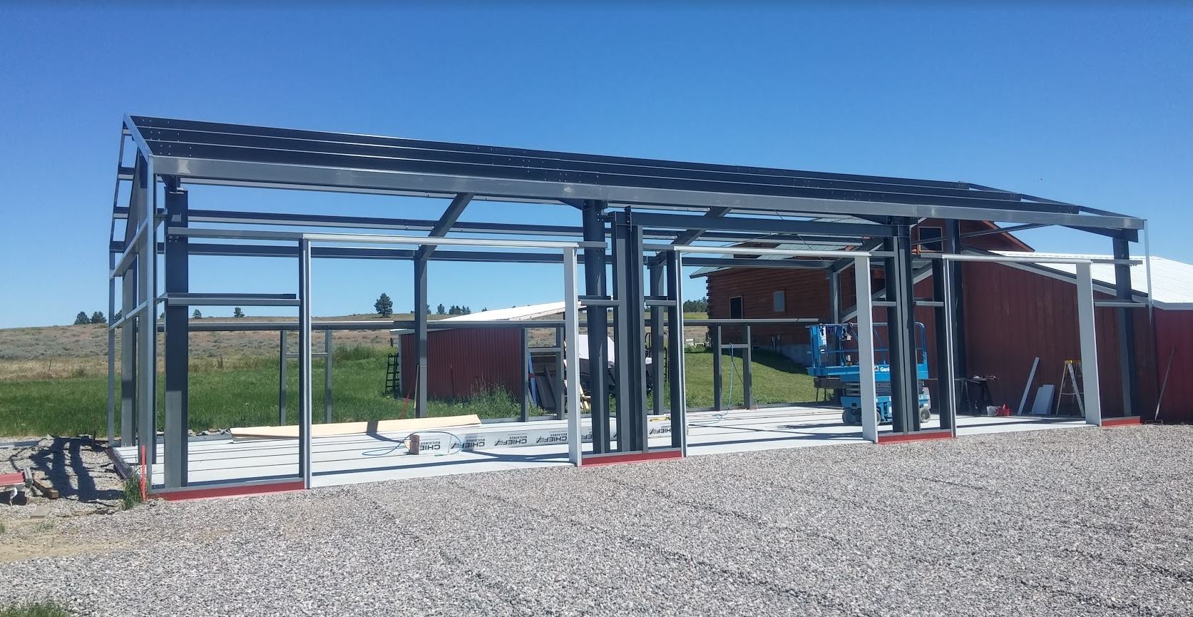

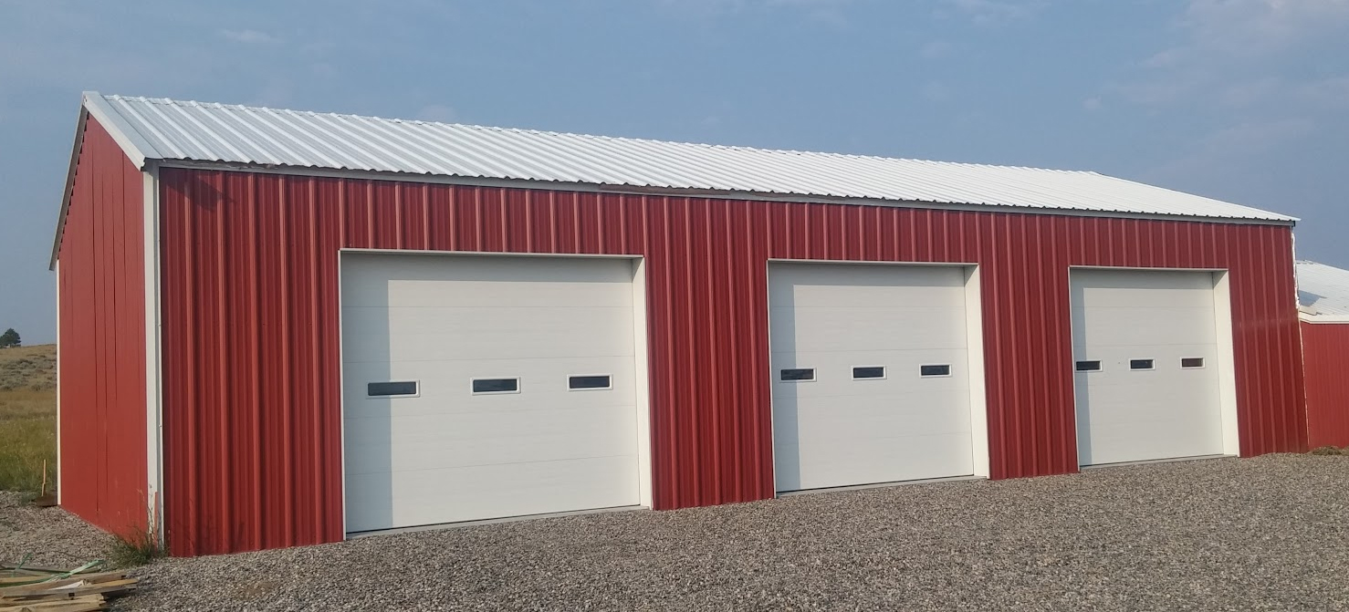

I built a Chief Steel Building a year and a half ago: Chief Buildings | Trusted. Tested. True.
30x60x16 4/12 pitch like Mickey
It's awesome and I love it.
I would do it again in a heartbeat.
Steel is strong as steel.
