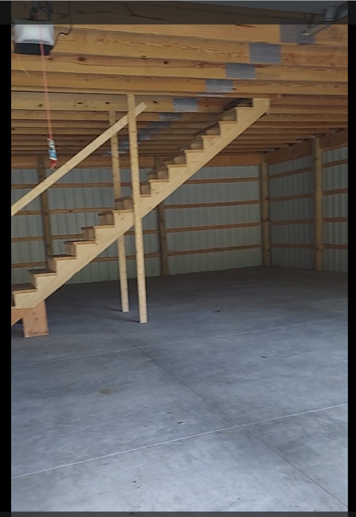

We just bought a new home, which has a one-year-old 30 x 40 pole barn. The seller did not provide much information about the pole barn. It has a poured concrete floor, which was done after the town inspector signed off on the place. Based on some reading on TBN, this could be an "Alaskan slab", since you can see for a few inches under the edges of the barn from the outside. It is sitting on concrete piers, according to the plan and according to what can be seen from the edges. There are stairs up to a full-sized storage loft. There is no protective railing around opening at the top of those steps and the hand railing on the stairs doesn't even reach the top - like they ran out of wood.

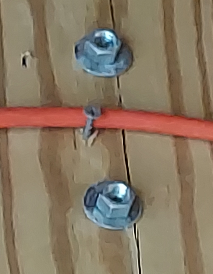

The wall posts have two bolts and nuts near the top. Many of those bolts seem too short, because I can see the ends of the bolts do NOT engage all the threads of the nut.

That retired carpenter also said I shouldn't put too much weight in the loft. Other than 2x4s stabilizing the stairs, there are no supports for the loft in the middle of this building. He can see the two-bys spanning the width are only held together in the middle by "mending plates".

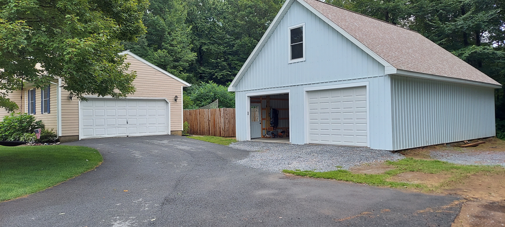

Thanks for the replies with info and good advice! I will try to attach photos here and see how it looks. Have several more to post if the first photo works.
The floor and garage doors (w/openers) were done by contractors and look good. All the friends-and-family DIY construction is what I want checked out by good pole barn companies. Getting callbacks from contractors is the hard part around here.
One entrance door, two garage doors, one homebuilt small "door" in farthest corner of barn from the camera was used for Deere riding mower. Weathered particle board was the "ramp" used for the lawn mower. Just the one window over the garage doors.
CB box is next to entrance door. One outlet is by the CB box and the other two outlets are mounted by the two garage door openers. No lights, inside or out. No other outlets.
Seller had five Harbor Frt LED garage lights chained together, hanging at the same height as the door openers. He ran a long extension cord from the one power outlet to the first overhead light in the chain. When we did the walkthrough just prior to the closing, the extension cord and HF lights were gone. They weren't permanent, so it was his legal right, but I didn't expect it - considering how much we paid over the asking price.
Land slopes away on the right side, as you can see. The slope behind the building is much steeper, heading towards a cliff about 75 ft. away.

Many (most?) of the posts have unused threads on the bolts. First thought - install GRK structural screws as recommended by "deezier" and then see if the existing "short" bolts can be, one-by-one, replaced.

If the "loft" is actually formed in the trusses, there should be some standard loading capability. Again what is the spacing? For a loft, they should be residential trusses, not agriculture and have two foot spacing.
Well.... I think we see what you mean. That photo kinda says it all.
Is that pex or power draped over the drywall screw?
Structually, many MEs consider that three fully engaged threads will develop the full strength of a nut.... the rest are for backup. However, those are ridiculous. Surely those joints were not inspected.
BTW, with the GRKs It makes no sense to put multiple structural screws on the same vertical line. Might want to offset them laterally.
