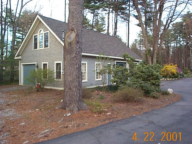

Carl,
I would love to see your materials list. Nice looking Garage/Office you've got there. I couldn't find your email so I thought I would list mine and perhaps you could send me your Excel spreadsheet. Thanks in advance. tdenny7@hotmail.com
   / pole barn #37
Mike,
It's probably due partially to the setting plus the green metal roof - 12/12 pitch and contrast to the siding with the overhangs. The rafters were 20' so had the overhangs same as the house 18" to keep the rain and snow away from the bldg.
One note, put the entry door on an end wall if you live in snow country - stuff slides off and creates a wall. Need to get out the TLB!! Was 5' high 2000-2002 winter.
Also sent the excel ss and more photos to you and tdenny.
Thanks for the nice comments, and attached photos are of the garage/office.
