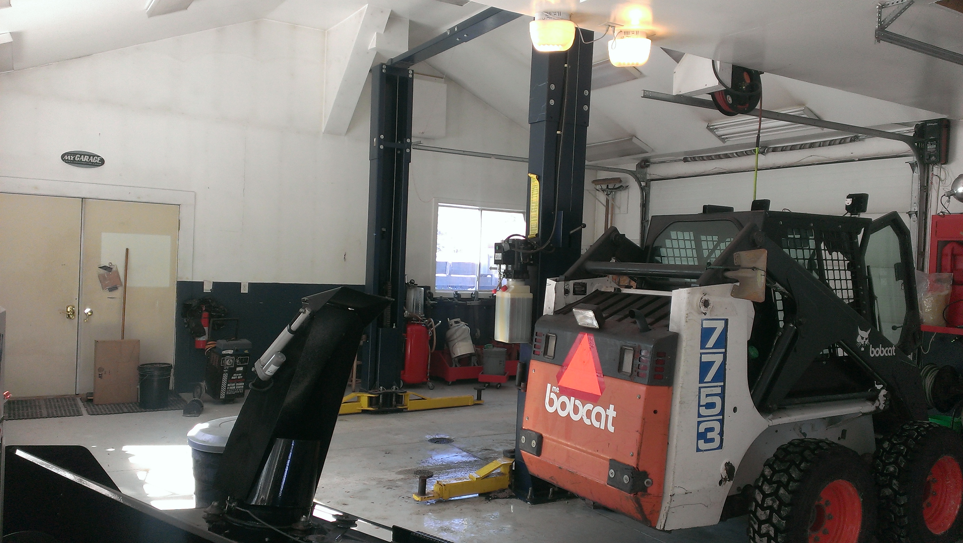

this is what we did.
Side walls are 10' door openings are 9' building width is 28 foot. Where the lift is, are rafters the rest are trusses. Roof pitch is 4/12. We can get suburban all the way up so I can just about walk under it and i am 6'. We insulated the snot out of the building so we could afford to heat it. has in floor heat. It is really nice to work in!

Very nice. My steel building ceiling is vaulted but not that steep. My building is tight and well insulated. It's a very comfortable environment to work in T-shirt on the worst Winter day. It's my oasis. :)
