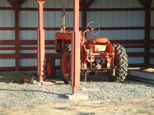

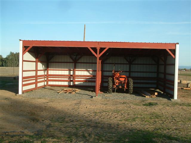

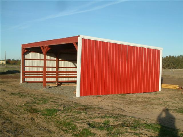

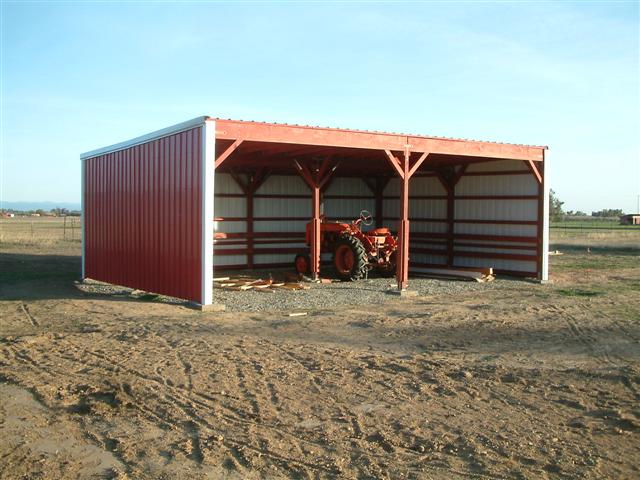

I built this one several years ago--20x28 ft, 9-10ft roof. Lumber and metal R-panel for sides and roof ordered through Home Depot and delivered to the jobsite for about $60 transportation cost. About $3500 in material total.
DSCF0090 (Small).JPGDSCF0097 (Small).JPGDSCF0098 (Small).JPGDSCF0099 (Small).JPG
Simpson post bases embedded in 18"x18"x18" concrete footings. 4x6 posts (DF lumber painted with Behr solid color stain), doubled 2x12s to span 14 ft between the posts. 2x6 rafters. 2x4 purlins (on the roof) and girts (on the sides). 28ga R-panel metal siding and roofing screwed to the purlins and girts. It helps to have a nailgun handy (mine is a 6-in-1 gun from Harbor Freight run off a $90 pancake compressor also from HF).

Flusher thats a great looking barn! After seeing those pics I came to the realization I really need to keep my structure portable. My family has 2 sections of land, 1 that all of us use for camping, hunting etc and 1 we lease out. One day my brother will have 1 and I the other.
I priced out a carport style structure 18'x21'x8' at the eaves for a 1022.00 installed, really think I am going that route as its on its own frame and not mounted in the ground. All metal structure that I could take down if need be in the future.
Thanks for posting the pics, made me rethink what I was doing.
