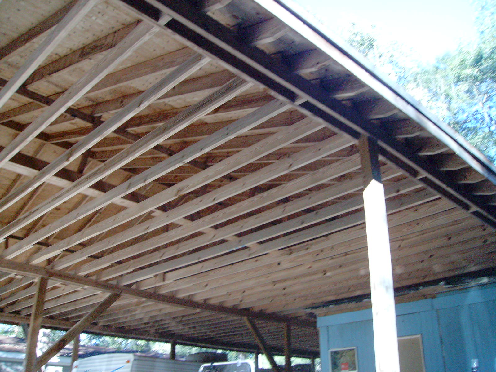

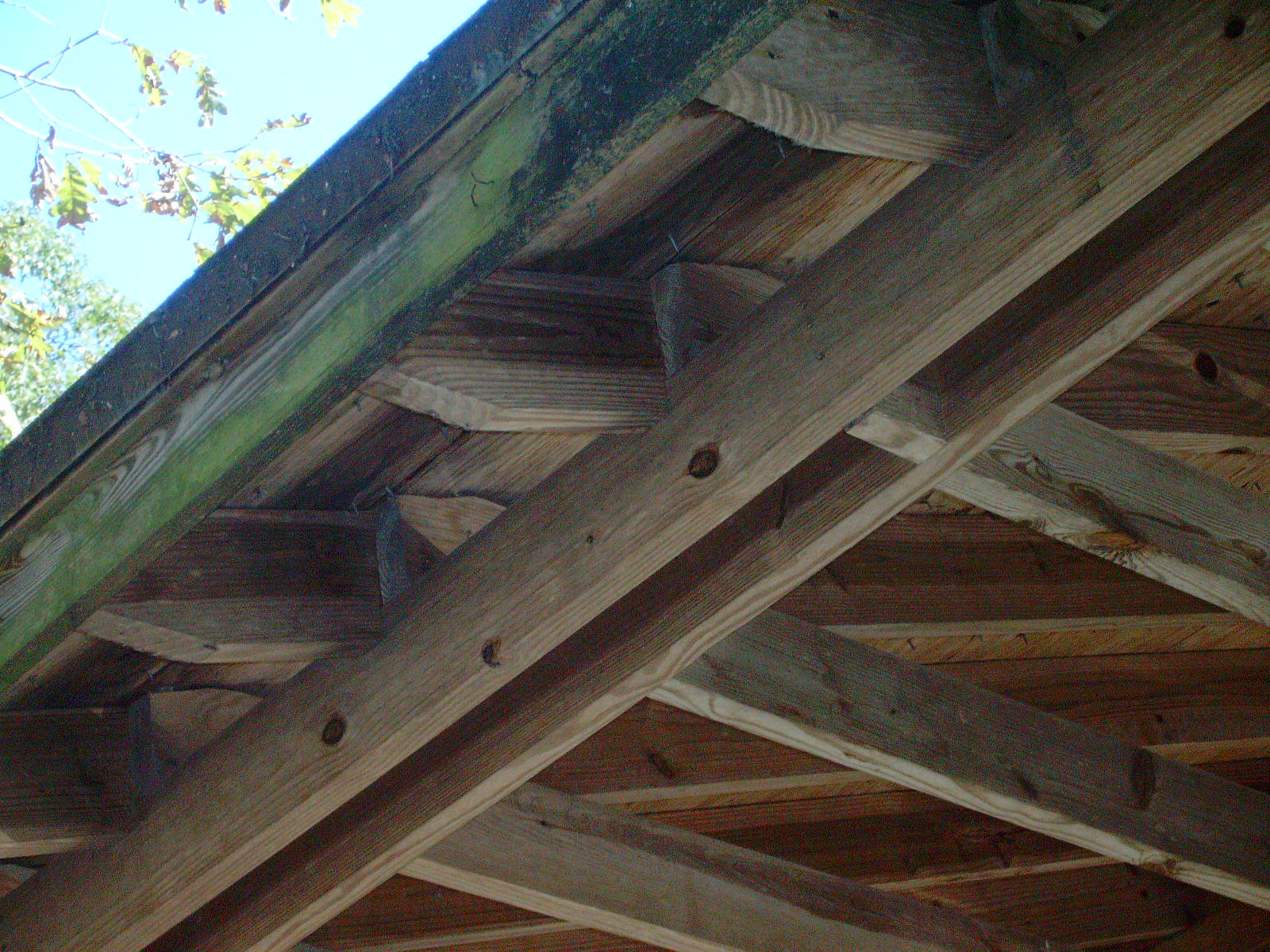

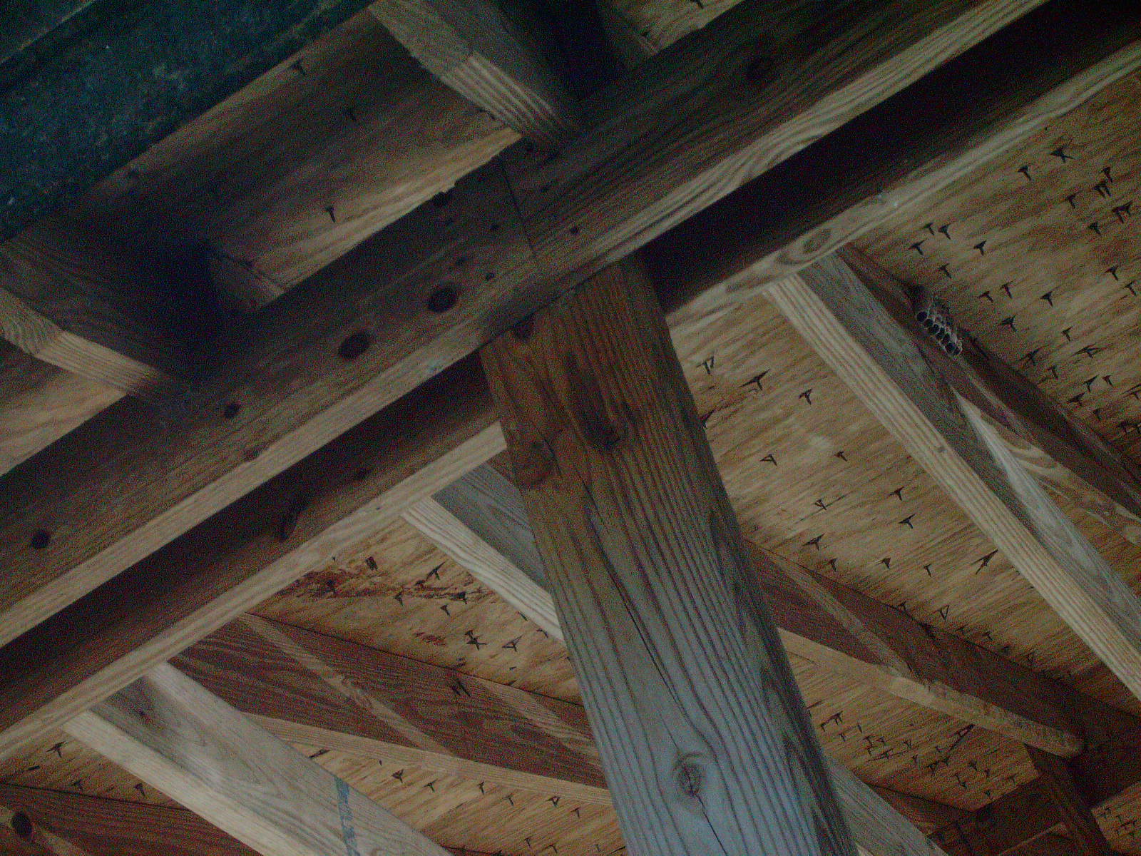

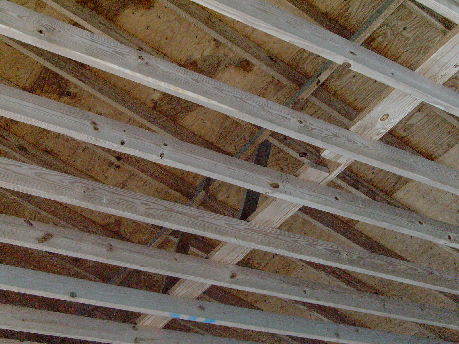

This is the way I am wanting to build my pole barn. This is a pole barn my father built about 15 yrs ago. The longest free span is 20' it may be sagging an inch or so in some spots, but not much. This is not the only pole barn like this in my area but the only one i could get pics of.
