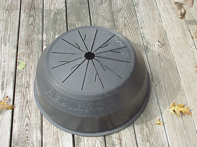

My posts moved in all directions.... front to back, side to side. Around here, the frost gets deep into the ground and it is not rare to see -20 degree weather for a week... as for wind, yesterday, my wind meter topped out at 75 MPH. I don't know exactly how hard the winds were blowing, but 2 pine trees blew down from the wind and the heavy soaking rain. I am posting a picture of the foot that I used. You cut the slits out for the size of tube that you are going to use and slip it into the center and lower into the hole. They foot is marked for each size tube so it is easy to do with a sheet rock knife. My mistake was not backfilling with sand. Had I done that, they might not have moved. I have since worked around the problem and it is resolved.
As for what some other people have mentioned, you will need cross bracing. I suggest that you use 2 x 6 PT and "let" them in. That means that you hold the board against the uprights at an angle and then mark where they board will meet the uprights. Then using a circular saw, make two cuts on the lines that are the depth of the 2 x 6... (1 1/2"). Then you chisel out the area between the two cuts and put the board into the cut out area. This will give you the most strength for diagonal bracing.

Junkman,
Now that is an interesting footer/form. The ones I have seen
are only tubes which still require a footer or they have an
Elephant foot which just does not appear large enough for what
I want todo. I figure I'll have to get what you used or build my
own footers. The "book" sais the footer should be a minimum of
8" thick and I think 7" from the edge to the pier/foundation wall.
Soooo, I thinking of building a 24" square by 12" deep footer
under each pier. But your footer form looks interesting. Much
faster to do your way......
How did you fix your pole movement? Sounds like using ABC
will firm things up around the pole. That stuff is almost like
concrete once it settles...
Thanks for the ideas!

I did it the old fashioned way...... just waited a year for it to settle to where it wanted to be and then built on top of it. It being a deck that is attached to the house, I don't have any more problems because there is no wind or sheer factor that I know of....
