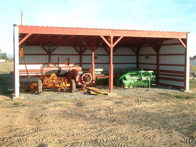

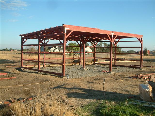

That's 1200 square feet or $25/sq ft. I built this 20x28 ft = 480 sq ft equipment shed with metal roof and sides (29 ga R-panel) for about $3600 including gravel floor ($7.50/sq ft).

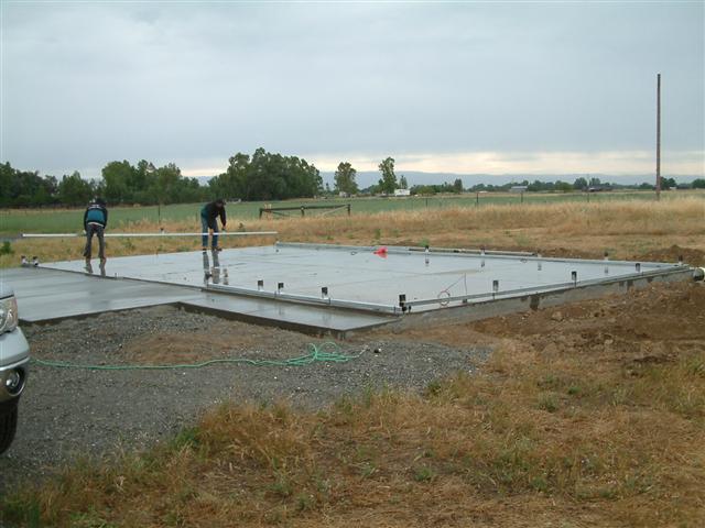

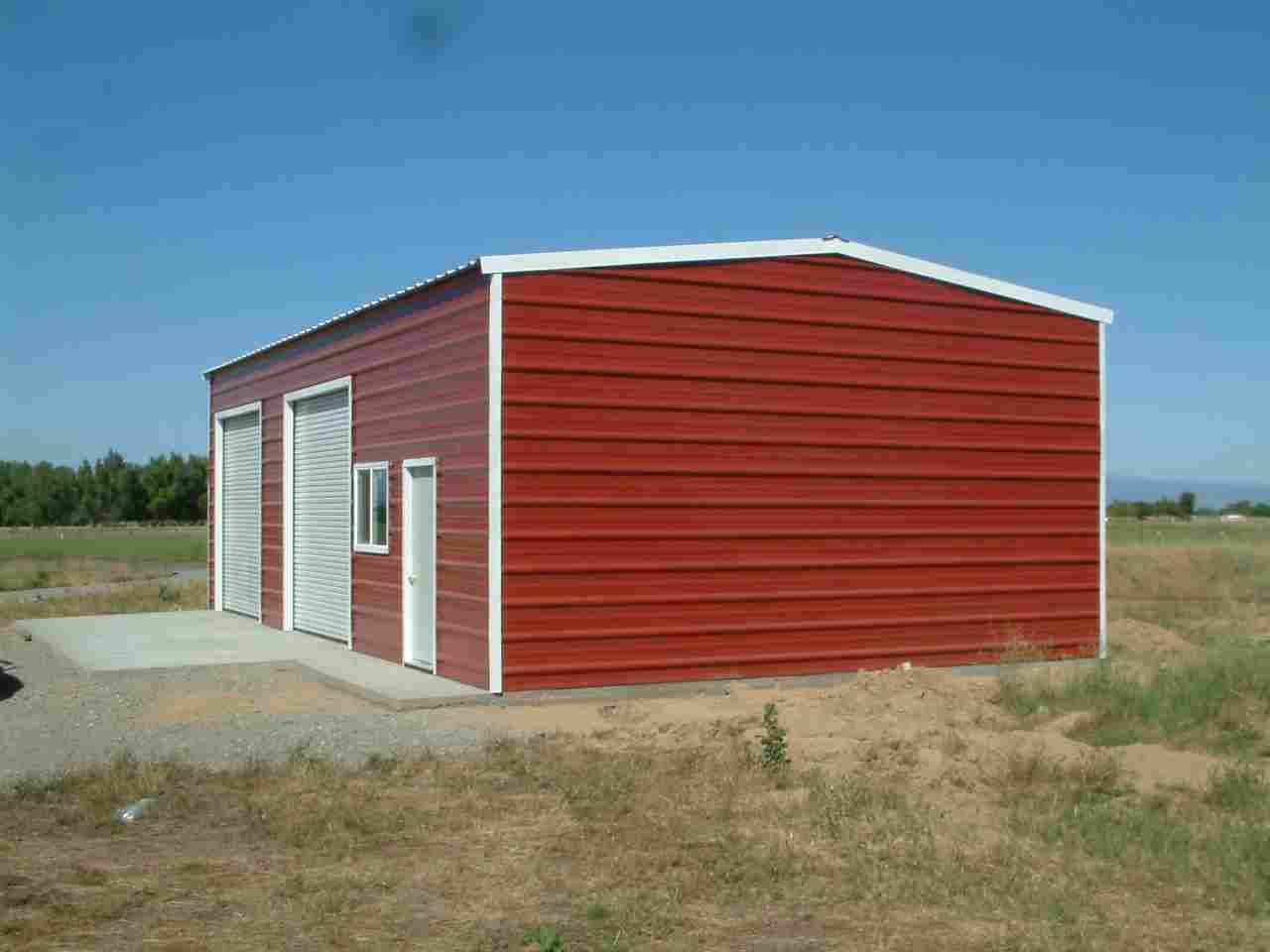

My 24x42 ft (1008 sq ft) all metal shop with 12 ft high walls cost $16K installed ($16/sq ft) in 2005 for the building alone including two 10x10 ft roll up doors. The concrete floor (6 inches thick, 4000 psi mix, #4 rebar on 24" centers) cost $8K installed.
So I'd say that bid you got is way high for what little you're getting.
