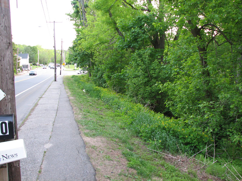

OK - here are some pix of my ivy problem. Do the goats get hazard pay for working close to a state highway?
Overall - there are quite a few small stumps buried under the taller grass - you can also see the drop off.

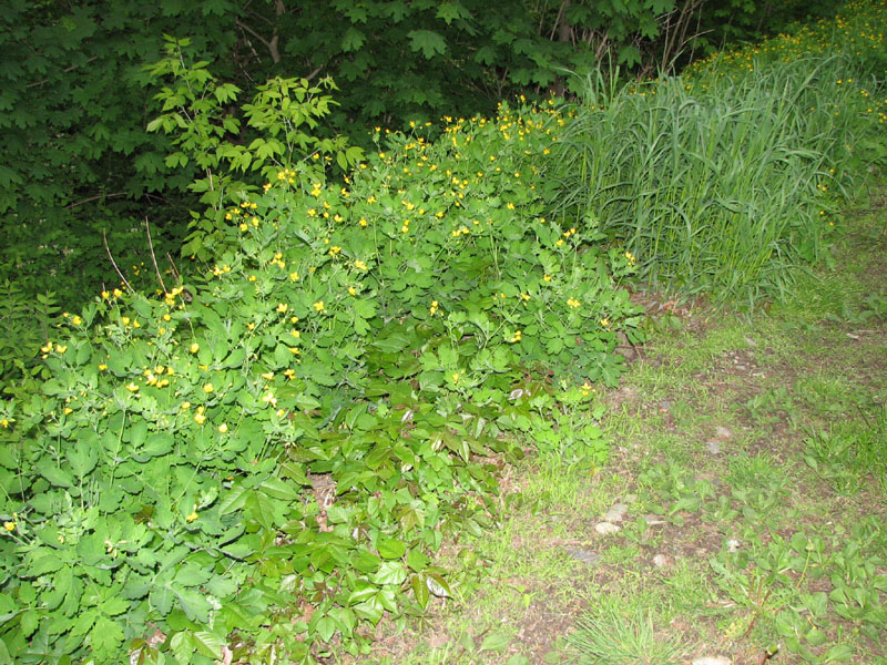

Up close 1
Up close 2

Hazmat,
Google "triclopyr". That's the active ingredient that eventually kills the poison ivy/oak/sumac group. It comes in a salt form known as "triethylamine", which is the active ingredient in Ortho's Brush-B-Gon. Many public highway departments use this for controlling roadside brush under the commercial names Access, Crossbow, ET, Garlon, Grazon, PathFinder, Redeem, Rely, Remedy, and Turflon. I'm not sure if any of those herbicides are available to the public, but the key ingredient is either triclopyr, triethylamine salt, or butoxyethyl ester. Apply it according to it's directions directly to the leaves.
Good luck, you'll get em eventually, and remember the plant's oil, urushiol, will remain active for several years after the plant has died and will still getcha. (Gets me at least, BADDDD)

MadDogDriver, I have used Grazon, however you have to have an applicators license/permit here in Mississippi to get it and I had let mine expire so the Co-op recommended BRASH as a suitable alternative that is not restricted. It has 2-4D plus a dicambra mix, kicks poison ivy big time as well as our other "green weed" curse, kudzu, works like a charm on locust saplings also. The other benefit is that a 2 gallon jug is about $60 and 2-3 oz per gallon it does a great job. Mix in roundup for a full spectrum effect.
/ Poison Ivy -- HELP!!! #51
Yeah, it's amazing how much the general public gets soaked for a lot of diluted chemical applications. The bulk generic versions that farmer Co-ops and other commercial ventures can get are much cheaper and generally way more effective.
Just gotta read the labels and know what to look for. "Knowledge is Power"
/ Poison Ivy -- HELP!!! #52
Crossbow is one that is recommended and works. It's triclopyr + 2,4-D Ester. The two chemicals together are synergistic and work better than either alone.
If you add a little Quicksilver and a non-ionic surfactant it will work faster. The best time to hit the poison ivy is when it is flowering as the plant is most active and will carry the poison to the roots faster.
But, you will probably have to spray the next year with something like Trimec Broadleaf to control re-growth when whatever is left sprouts the next spring. Trimec + Quicksilver + surfactant is really good. The Quicksilver seems to be synergistic with the Trimec and makes it work much faster.
Very difficult to control with only a single application of any type of chemical. You just have to be more persistent than the plant & keep after it. At some point, it will all be dead.
The point about the birds spreading the seeds is true. You'll have to either use a pre-emergent over the area early spring, or spot kill the new plants.
You can get Crossbow from several suppliers through Ebay. Quicksilver and Trimec are available from a number of outlets. If you have a Lesco outlet near you, they should also have the same or equal chemicals.
