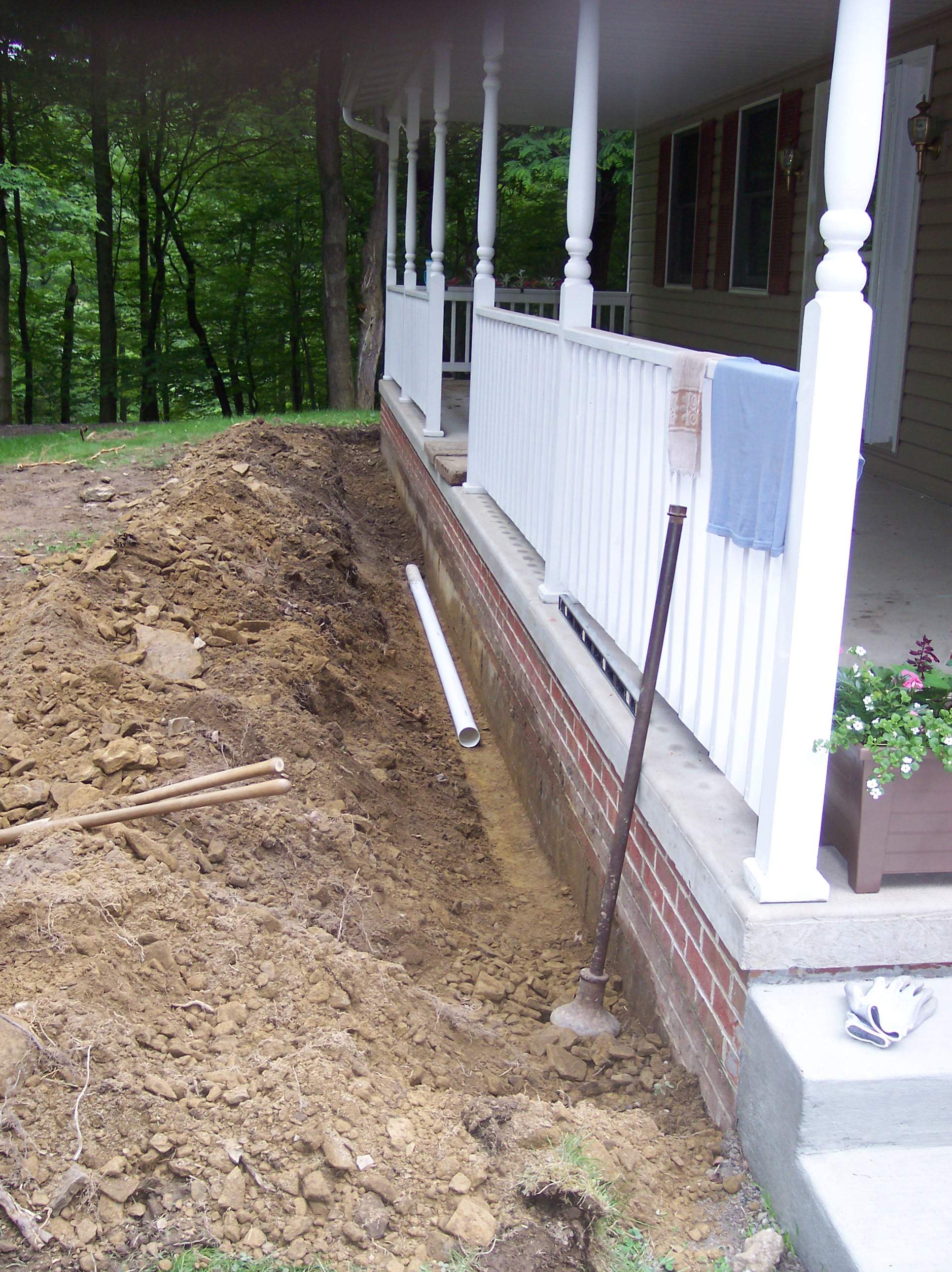

I built this for my Case 1816 last year. It works very well for its size. Even straight line digging goes well. It makes a mess though because of moving the wheels from side to side constantly and pulling back (no stabilizers).
