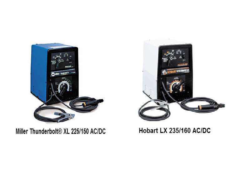

I’ve been looking at welders for a couple of months, so I have followed this thread with a lot of interest.
I was looking at Northern’s website today and found this Hobart LX 235 AC/160 DC welder for $399.99 (see link below). I put my zip code into the shipping calculator and for standard shipping it said $0. If I am looking at these numbers right, that is a savings of $200.00.
Something else that I found interesting when I was doing a side by side comparison. Look at the attached picture and tell me if you see any resemblance in these 2 welders.
Hobart Stickmate AC Welder — 230 Volt, 235 Amp, Model# 5004212 | Arc Welders | Northern Tool + Equipment
   / Plz, Help me Choose 'tween These 2 Welders: #17
Well... downright uncanny! Somebody messed up with the white paint!
And I guess the amp dial, too. They let the Hobart turn another quarter turn.
AKfish
   / Plz, Help me Choose 'tween These 2 Welders: #18
Could you TIG with these smaller boxes? Either the Miller or the Hobart? Thanks.
AKfish
   / Plz, Help me Choose 'tween These 2 Welders: #19
I know, it's kinda odd they just happen to look alike. What are the chances of that happening again?:rolleyes:
I dont know if these would handle TIG or not. Some of the other fellows on here will know. I can stick weld OK but I've never tried to TIG. A friend of mine runs a welding shop, so if I need anything that fancy, I just take it to him.
I had been leaning towards buying a Miller, but after comparing it to the Hobart, I think I like the idea of saving $200.00. That will give me a head start on the next toy that I want to buy.:D
   / Plz, Help me Choose 'tween These 2 Welders: #20
Miller is the parent company of Hobart so they will look alike with some minor changes like Paint and some inside stuff, I have no idea what on the stick machines....on the mig units the drive units are different.
