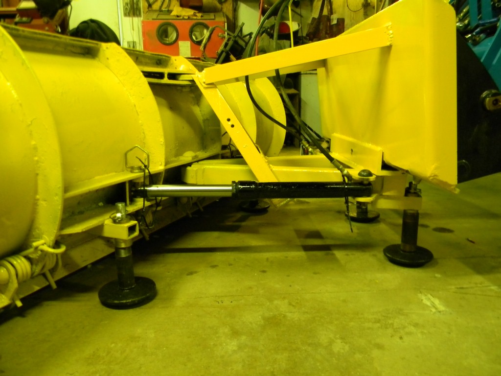

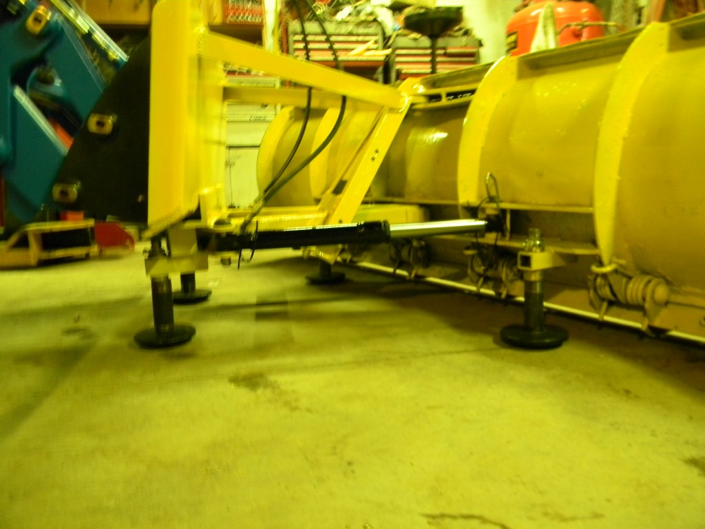

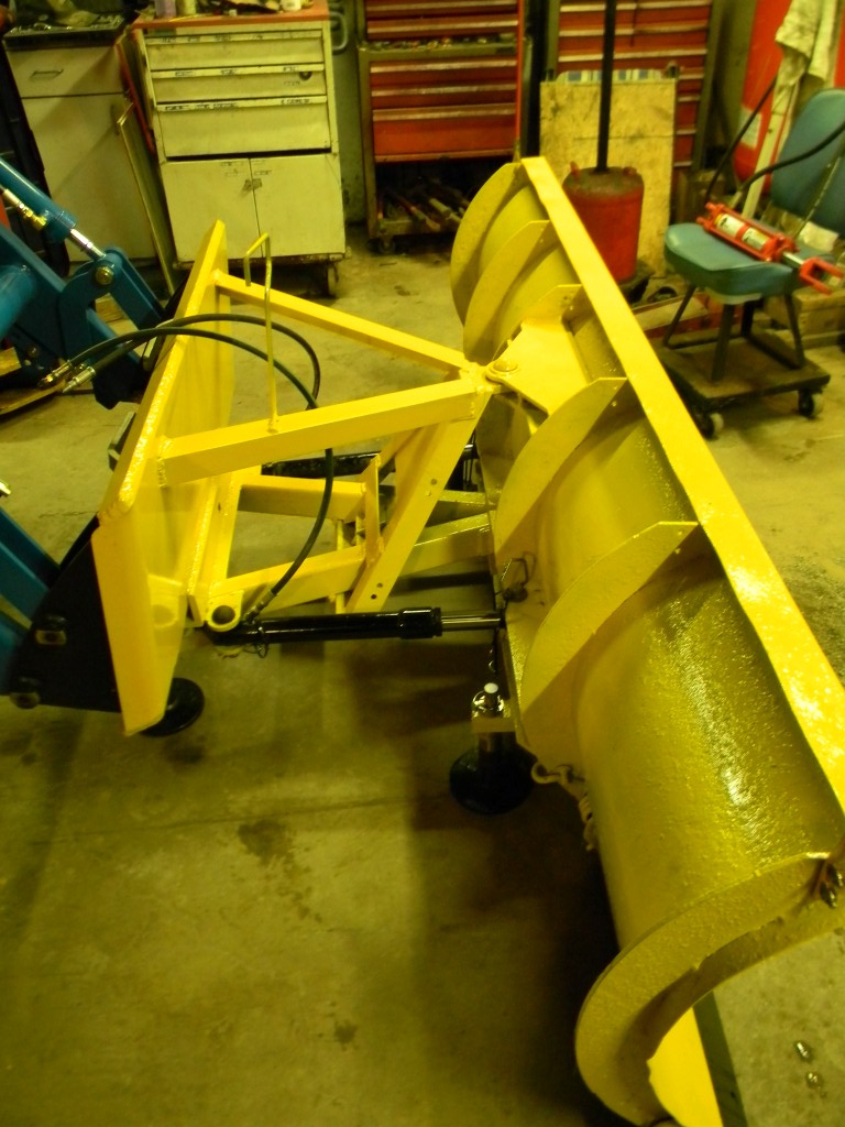

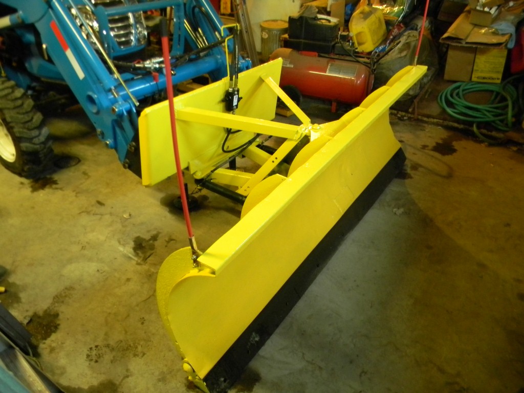

As James mentioned, yes using 2 single acting cylinders will work fine. One double acting cyl. will work also. I originally had a DA cyl. on my plow but decided to use that cyl. for something on the 3 pt. and bought 2 SA cyls. I hooked mine to the remote that has the center detent. I also installed a crossover relief. Plow frame is welded to a 1/2" QA plate like you have.
