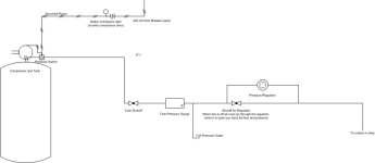

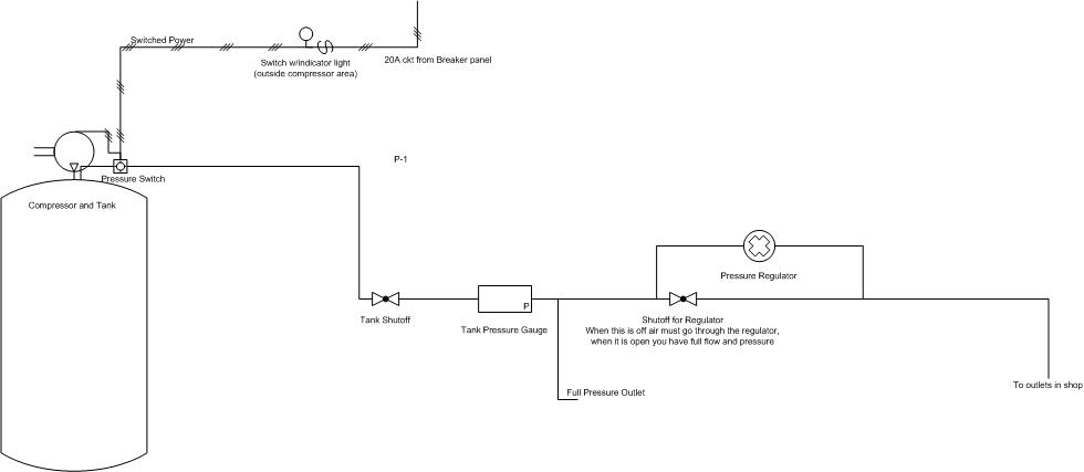

I plumbed my father in law's compressor into the shop the other week, I used all in 1/2" PVC, so far so good, next step will be to enclose the compressor (vented to outside of course) so that it is quieter...
a schematic is attached...
Enjoy
