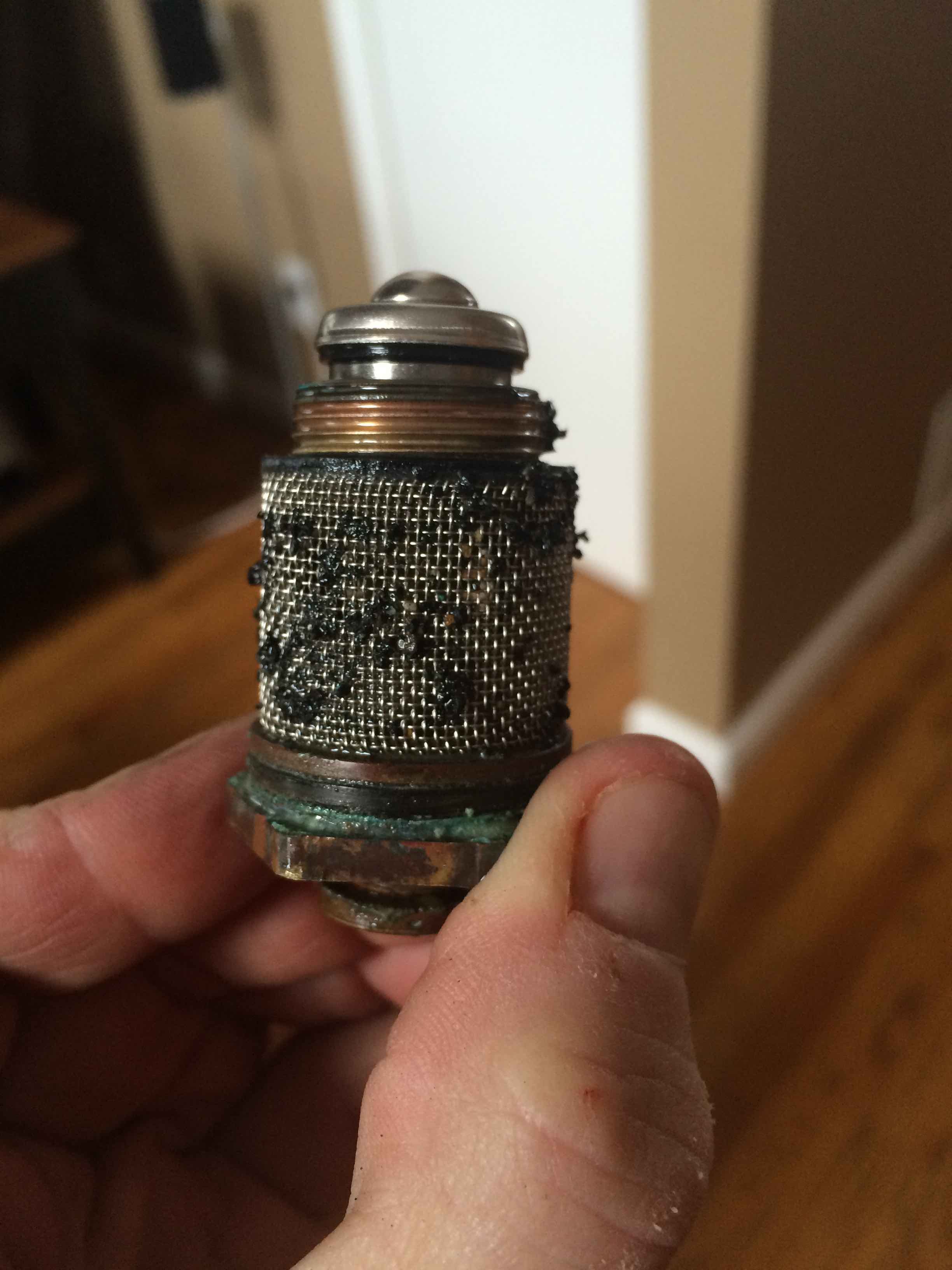

UPDATE:
Today I took the pressure valve all apart and cleaned it - I mean cleaned everything I possibly could. This is what it started out looking like:
Once my son and I were done it was perfectly clean. I then worked on adding my second outside spigot and running all the lines for it. Once everything was done and dry we turned everything back on and did some testing. I tested everything at the same place as I originally did because I made no changes there.
Pressure again was about 42-44 PSI
Flow into a 1 gallon bucket - 10 seconds, try #2 - 11 seconds, try #3 - 10 seconds.
WOW, that is awesome, before I was consistently at 18 seconds a gallon before. Basically went from 3.3 GPM to 6 GPM. I am VERY pleased with this improvement. I know it is not great compared to other places but for us it the best we have ever had. Even noticed how much faster the commode refills.
I wanted to thank everyone that answered my post and gave me ideas and information on ways to improve our water flow. I figured it was something I was able to do myself but just don't know much about plumbing so the information was a huge help. Never knew the pressure valve had a screen or even gave it a thought. Again - Thank you all!
