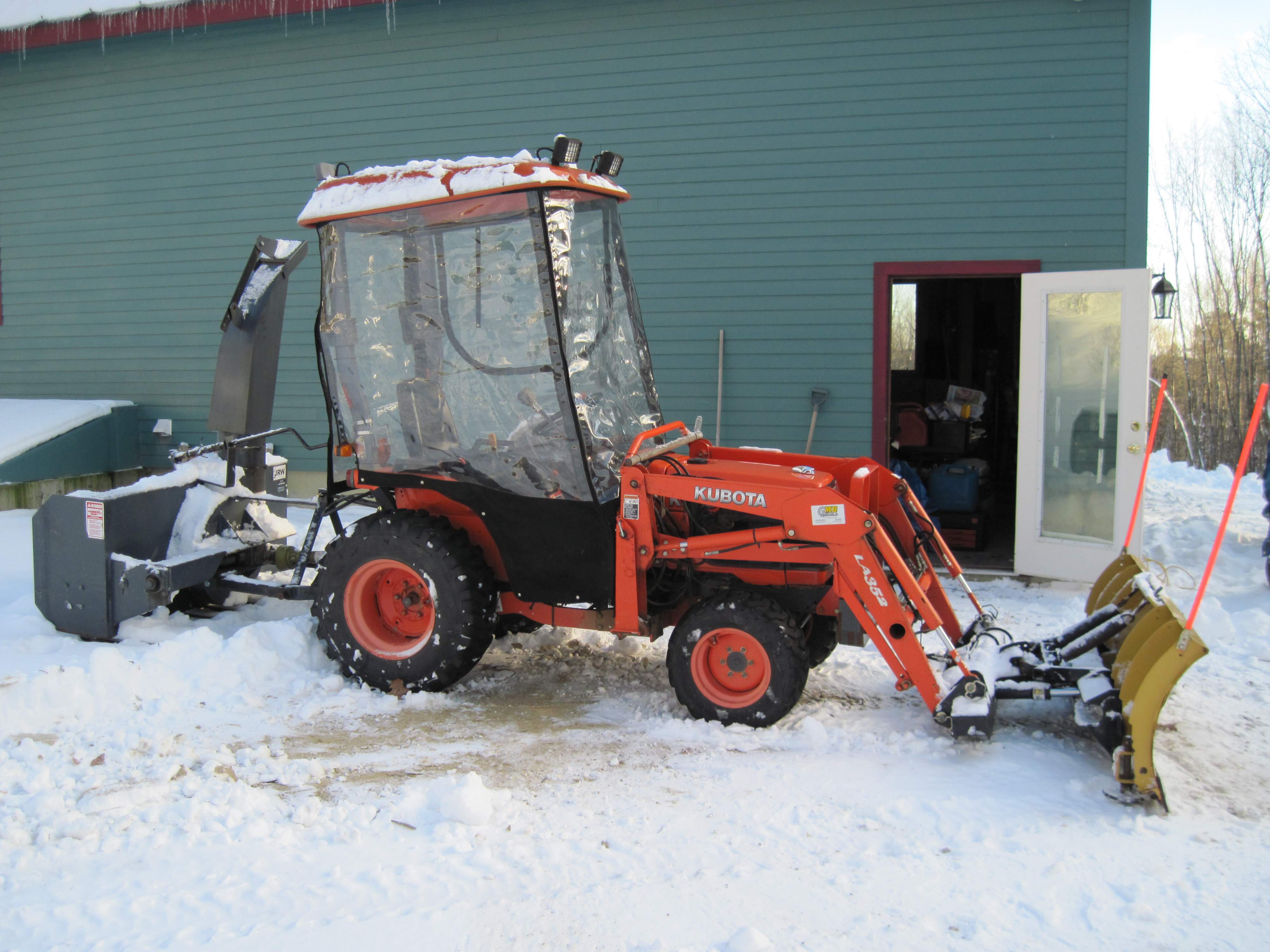

I have a loader mounted blade on the Kubota L4240. It does fine on the black top and you can run the loader in float. I am having trouble from keeping it from digging in on gravel. I can work the loader up and down myself but my driveway is not very level and it is hard and I can only run 2.1 MPH doing that. I have seen guys with trucks plow on gravel and not dig in and the same for the highway department on back roads. I was on a dirt road today that had been plowed by VDOT with a loader and it was not all messed up. I have heard of people splitting a piece of pipe and putting it on the cutting edge but I think the blade still may sink in. One thing that would help would be a good hard freeze but where I live the ground is constantly freezing and thawing. How should my ski shoes be running, level or slightly higher in front? The ski shoes are 6.5" and they are round. Is there any trick to it?

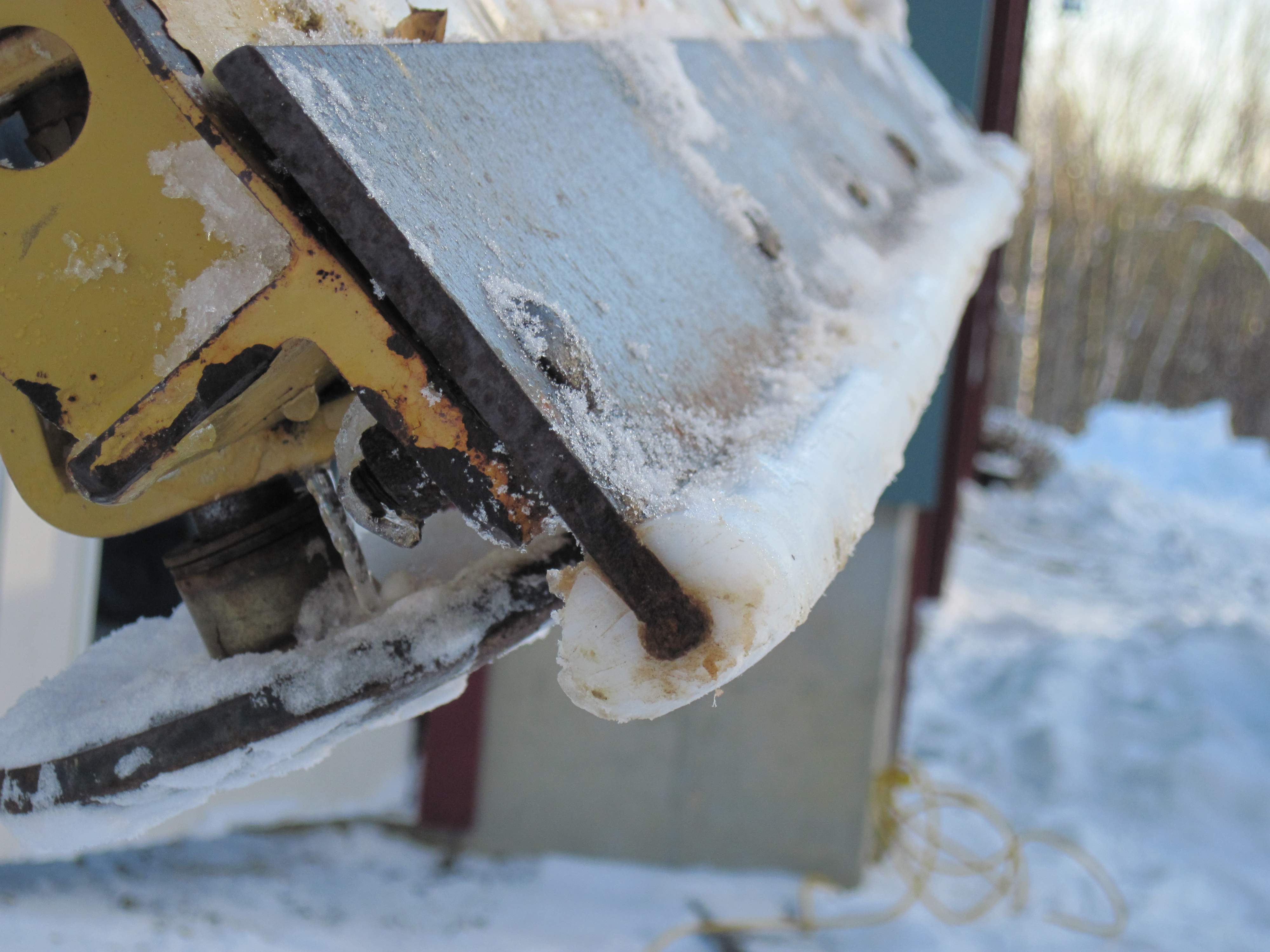

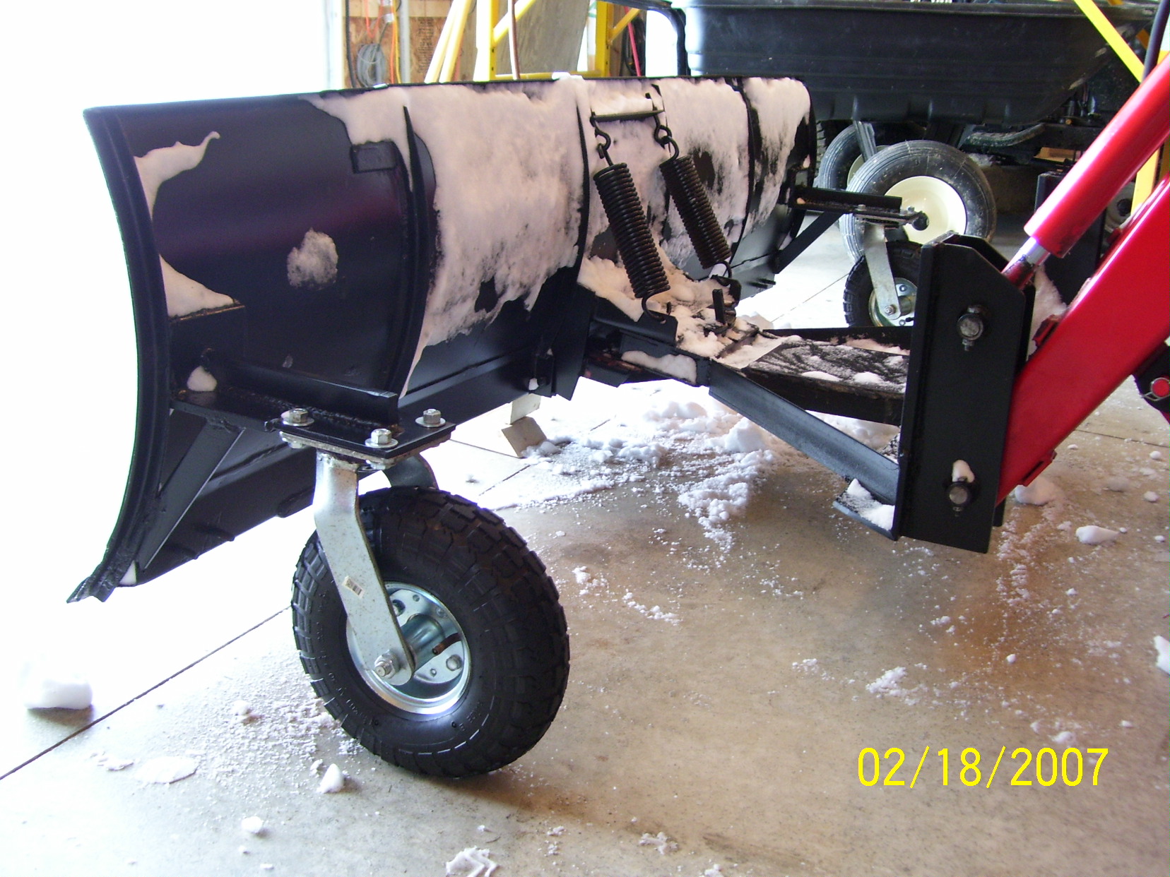

Plowing on gravel is an art.
The pipe will help a lot. Use a piece of 2" steel pipe. Don't bother slitting it, just weld on tabs and bolt it on.
It also helps a lot, (unless your area is perfectly flat), if your plow is hinged, or hung so it can move up and down freely. And, has the ability to rotate a few degrees. The can be accomplished simply by having some slop in the attachment.
I made gauge wheels to replace the shoes.
Finally, pack down the first 3-4 inches of snow, by driving over it. And don't use chains.
I plow over 300' of gravel drive, and move less than a 5 gallon bucket of gravel all season.

A pipe at the bottom of the blade will help too but I found it still dug in some at the ends of the plow blade/pipe.
I wound up making BIG plow skids that I use until either the base freezes or I get a good solid pack.
When I say BIG, I mean I took a pair of regular skids and welded skis to them making them about 6" wide and about 12" long with the front angled up just like a ski.
Once the ground freezes or you get a good pack they are then too big and tend to ride on top of what you are trying to plow so at that point, I pull the pins and put the smaller ones back on.

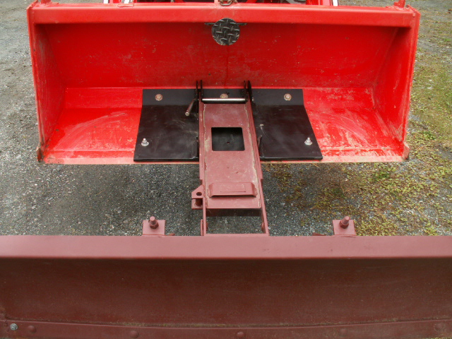

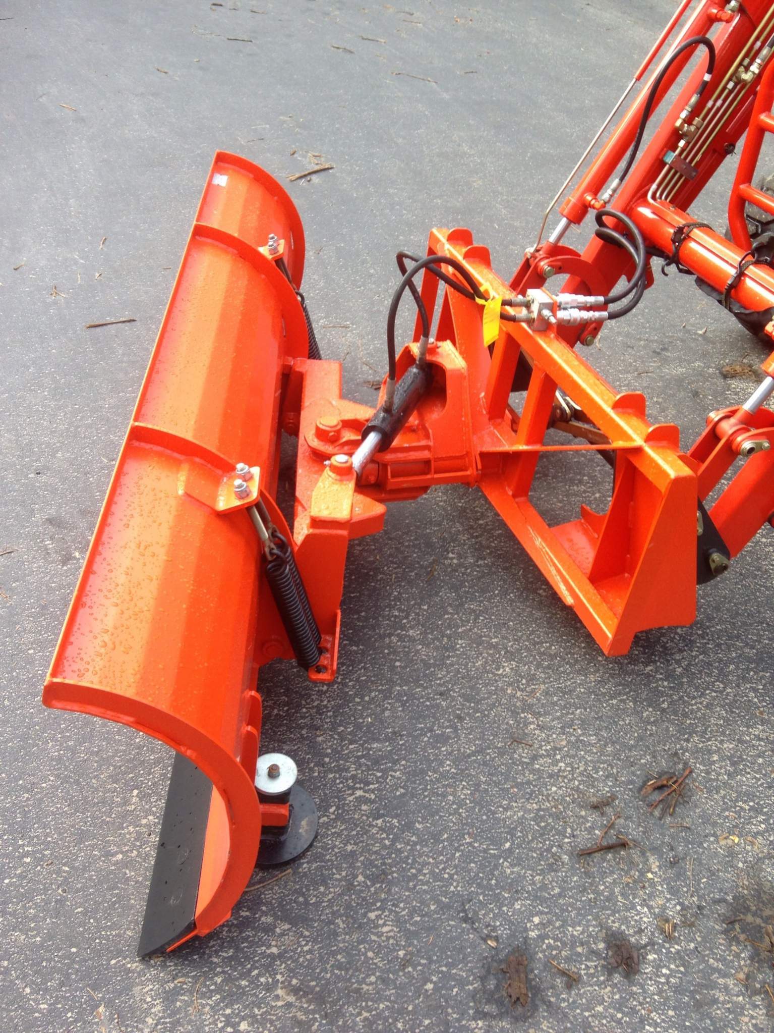

The blade has 4 sets of adjustments in the back. The manual says to use the upper holes but the loader runs really close to the ground. Here is a picture. I have tried where is it pictured and all the way up and all the way down. I think I need to be somewhere in the middle.
I don't use shoes/slides nor float,I slighty tip plow back bucket couple inch from ground let my main plow pin float.
My plow is rigid mounted to the loader.

The blade is rigid mounted mounted to the loader. I can now see a advantage to a blade that floats itself. I probably have around 1500lbs riding on the ski shoes I imagine. I have let the ski shoes all the way down and it still cuts in.
