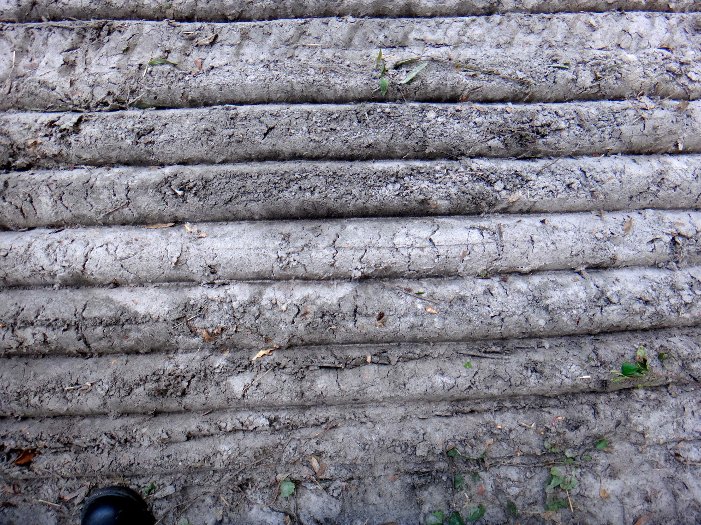

I plowed a food plot this year, we used to just till it, but it was time to really turn it over. After that, I plowed it one more time and than used 3pt tiller to smooth it over, it worked reasonably well, but it is far from smooth, there are lower and higher areas in the field.
For future reference, what is the recommended procedure. Say I plow it - we have single 14" plow - and now what? Disk it? Drag it with harrows?
This food plot is more like a small farm field, not your typical clearance in the forest.
   / Plowing food plot #2
Get the soil cultivated and loose. Plough, disk, and then harrow. As time goes on the soil will get more crumbly and the plot smoother. The first disking pass should be the same direction as the furrows. Not near so bumpy a ride. Then start angling the passes as it gets smoother.
For levelling.
Think grader blade performance on the cheap. Then make a drag about eight feet long from a piece of heavier timber ( 8x8 ) or so and put a couple of skids on it so it stays flat and does not roll. These skids also help in levelling as they cut the high and drop in the low. Attach a chain at each end and pull with the chain. You can angle the skid by just moving the hitch point on the chain. Then start draging the skid from different directions and at different angles till your satisfied.
Of course there is always a length of chain link fence or bed springs that seem to work for some.

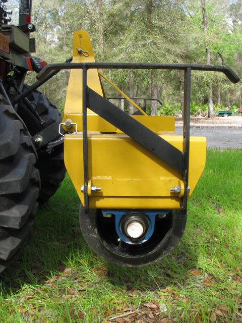

Sow seed. Pack with a heavy Cultipacker, which should smash the clods as it rolls in the seed.

With my food plots I switched to the coated seeds like what you get from Wildlife Institute. You get less qty for you money but being coated, The critters and birds don't eat any seed. I've been at this for 20 years and tend to get more simple as I go. I use Slay and Arrest to kill broadleaf and grass in my plots and they turn out beautiful every year. I lightly over seed in the 3rd year and spray it and disc it up every 4-5. I don't have a cultipacker but I built a water tank roller that smooths and sets my seeds. Be careful when buying seed mixes. Too often they have plants that need to be mowed mixed with plants that will die if you mow them. They look good on the bag and in the plot but not so much after they get mowed. I can't say enough about getting a soil sample tested and follow the testers instructions to get am optimum plot.
