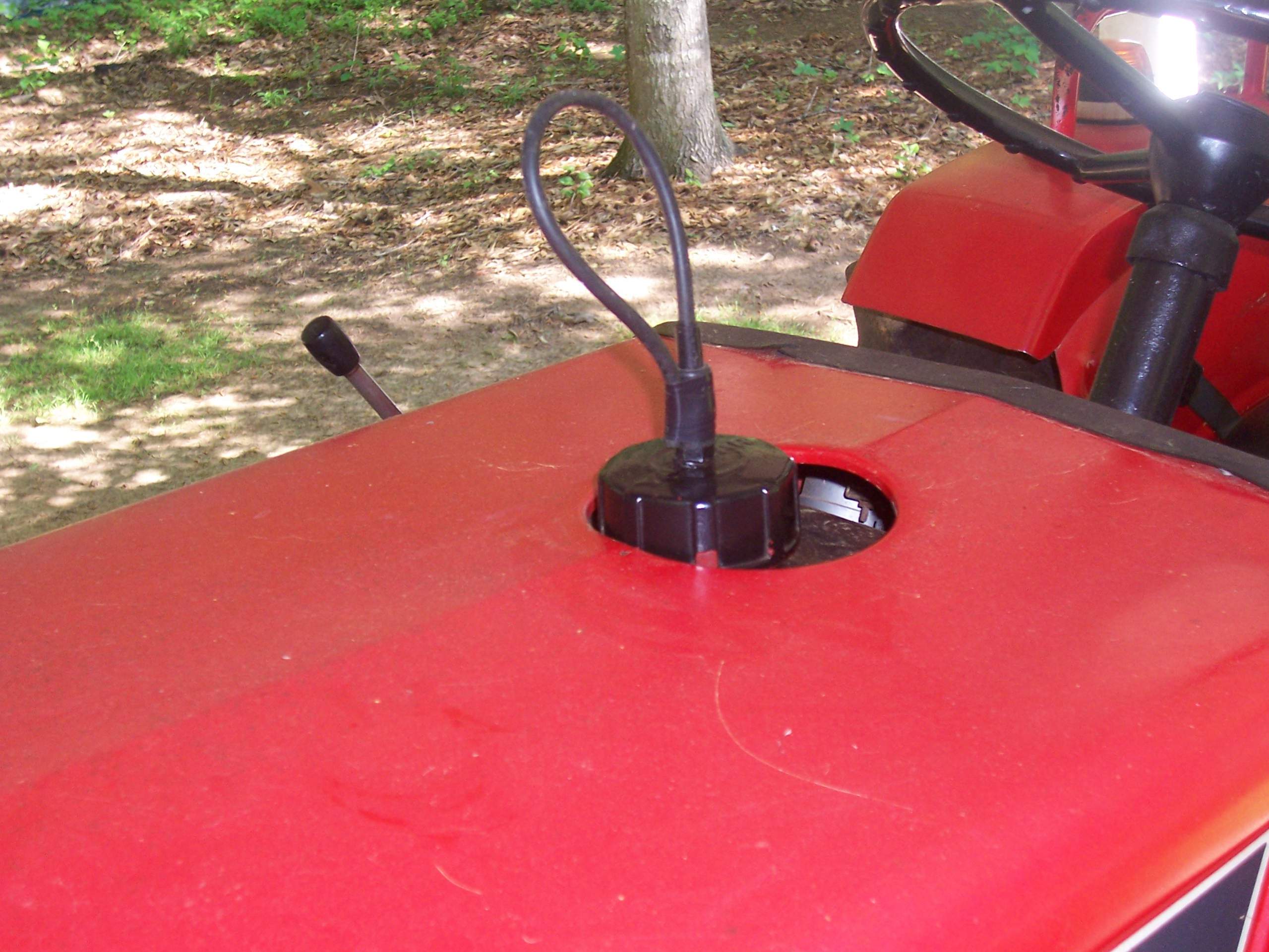

Was plowing tonight and the engine just started to shut down. I figured I was running out of diesel so I shut it off. Checked and its full. What would make this die just like it ran out of fuel ? 186d. Stuck in my driveway

Here is a when all hope is lost, use at your own risk, probably will never work twice tip from someone in the north. When all else fails and you know that you are not getting fuel to the injectors. Crack the fuel lines at the injectors. Cut a circle out of a inner tube with the stem in the center of the circle - as big as you think you will need after reading the next step. Take the fuel cap off and wrap the inner tube around the spout of the fuel tank, now put a hose clamp around that and tighten it down. Put a FEW PSI in the tank - watch the lines at the injectors when "liquid" fuel comes out turn the fuel off at the filter, then release the air pressure from the inner tube. Don't go putting a lot of pressure in the tank!! Something will eventually give and diesel will go flying everywhere, potentially hazardously!!
