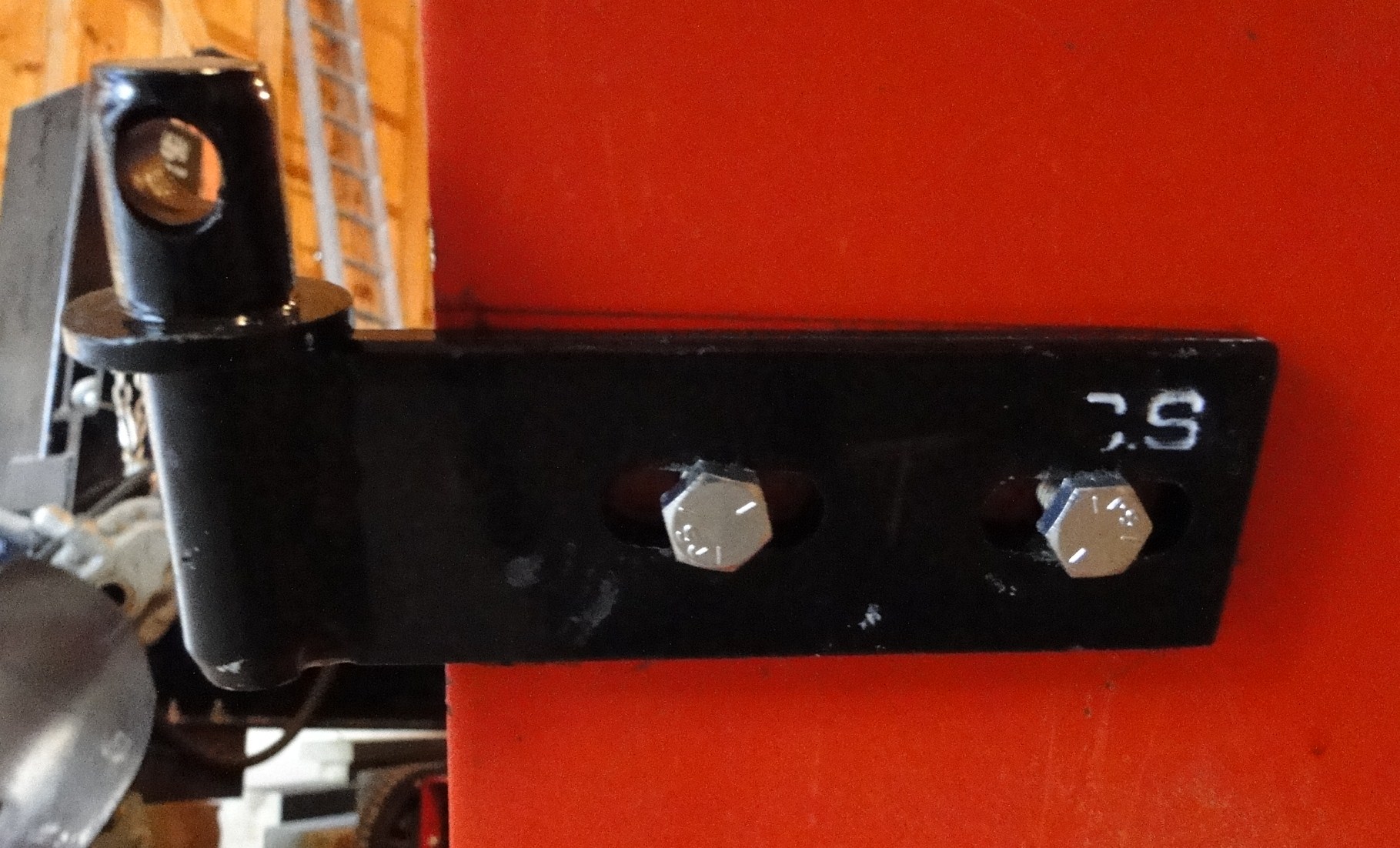

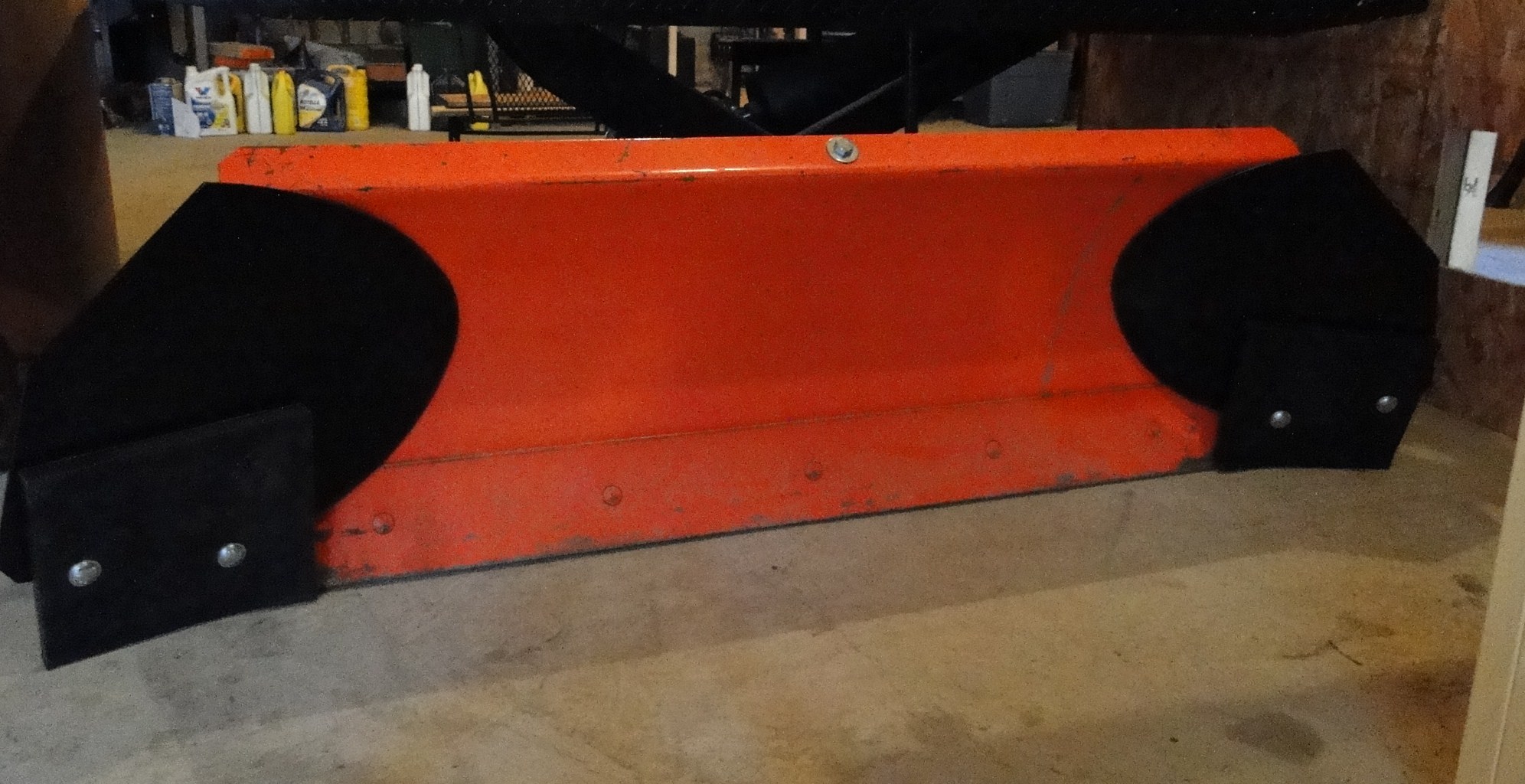

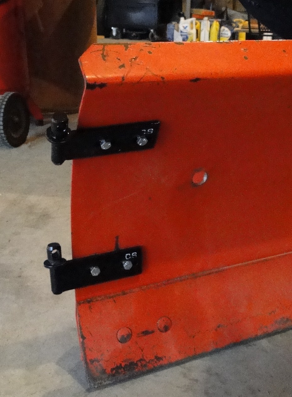

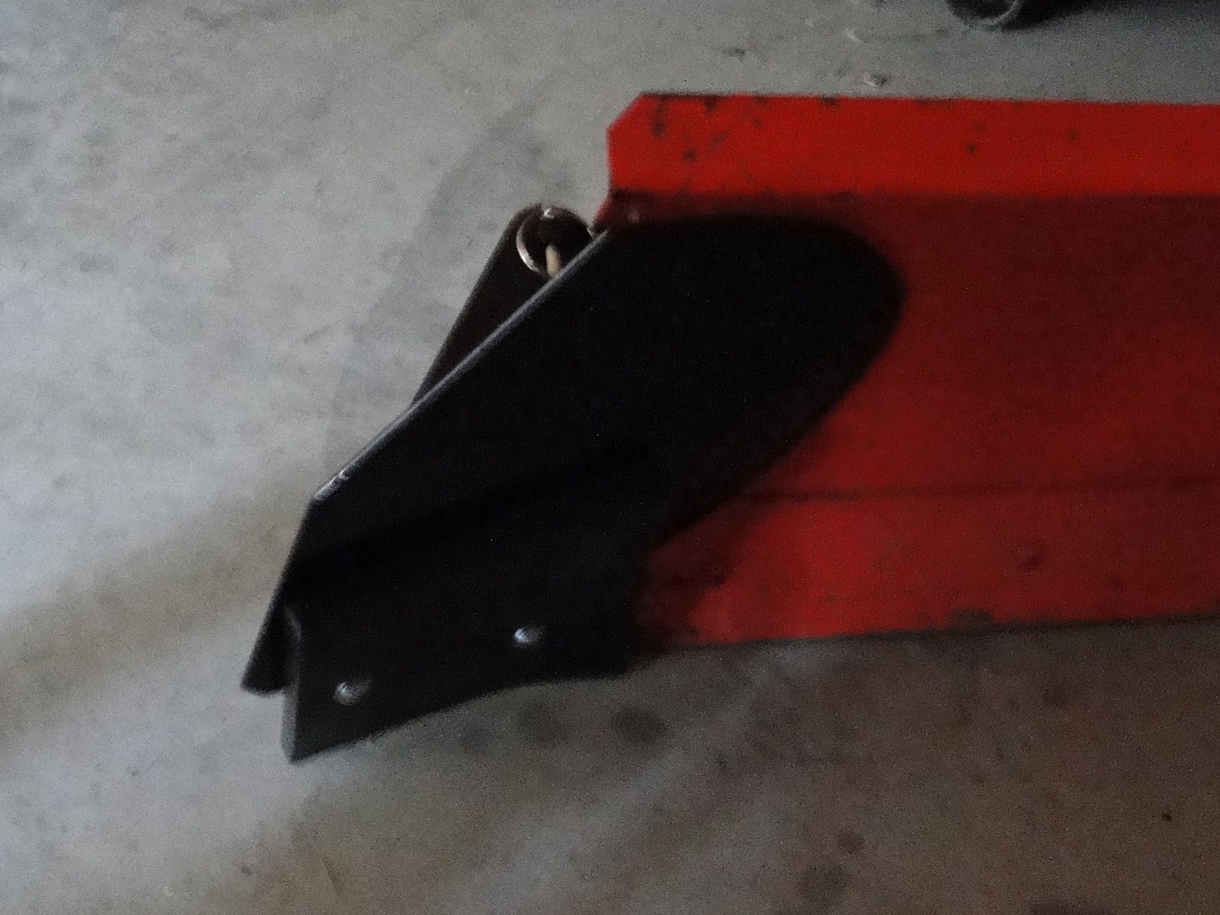

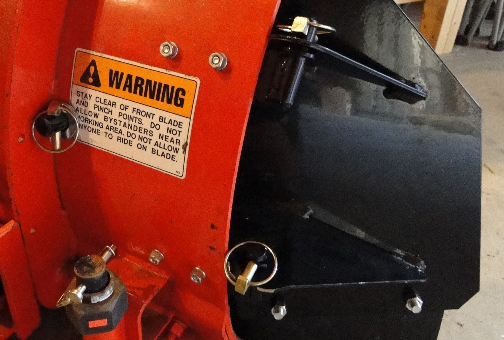

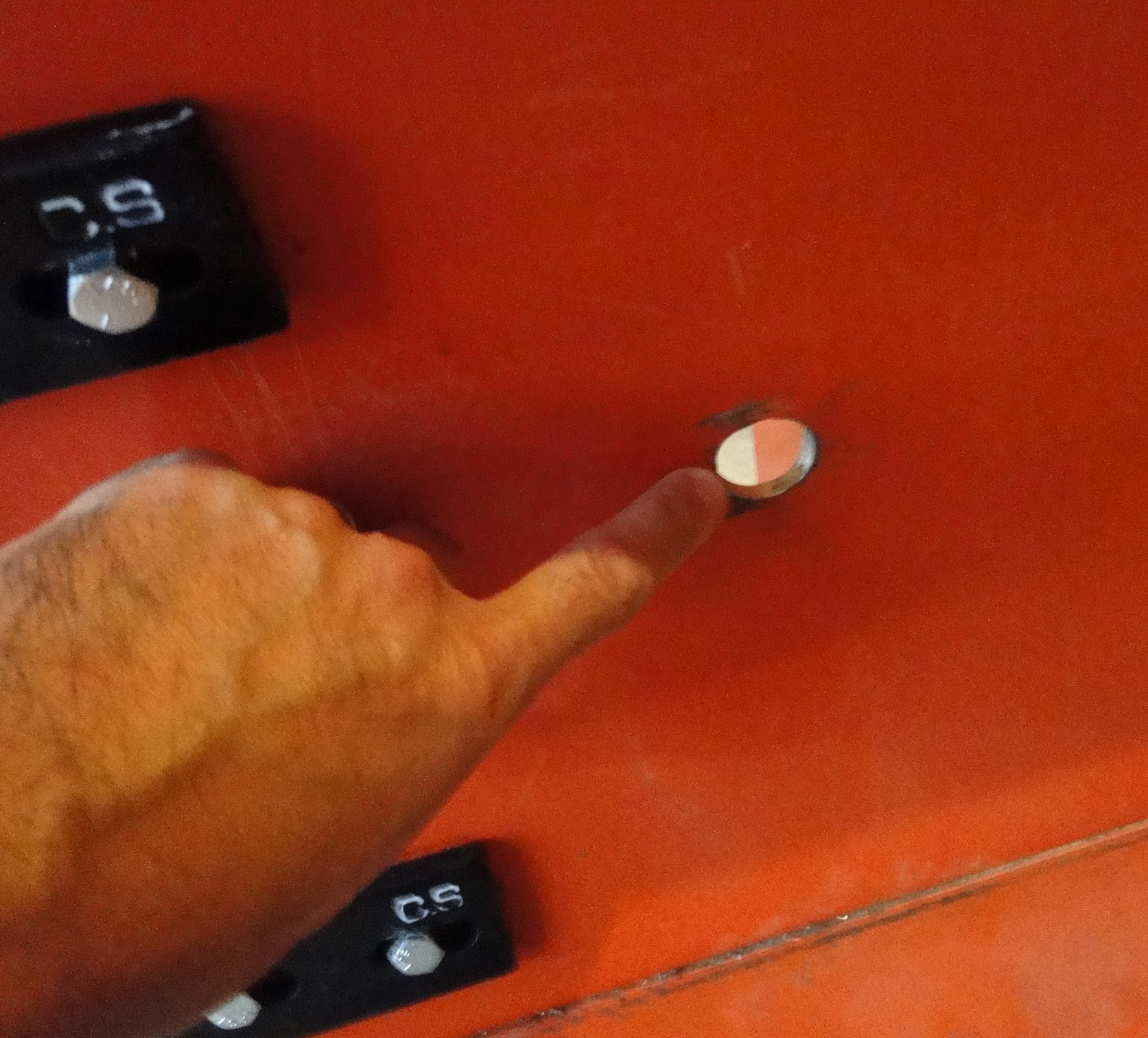

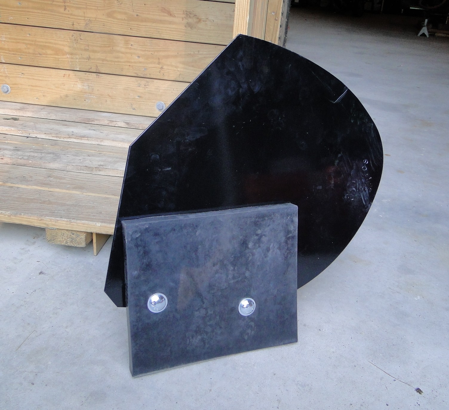

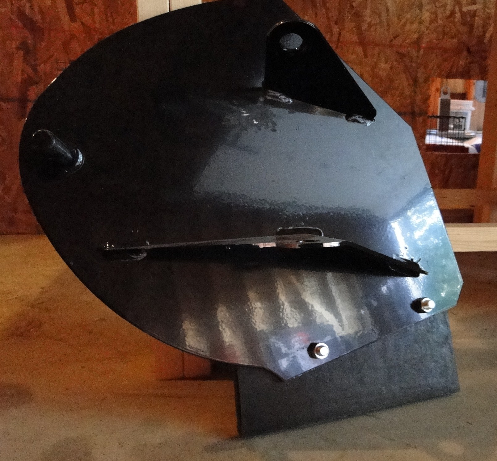

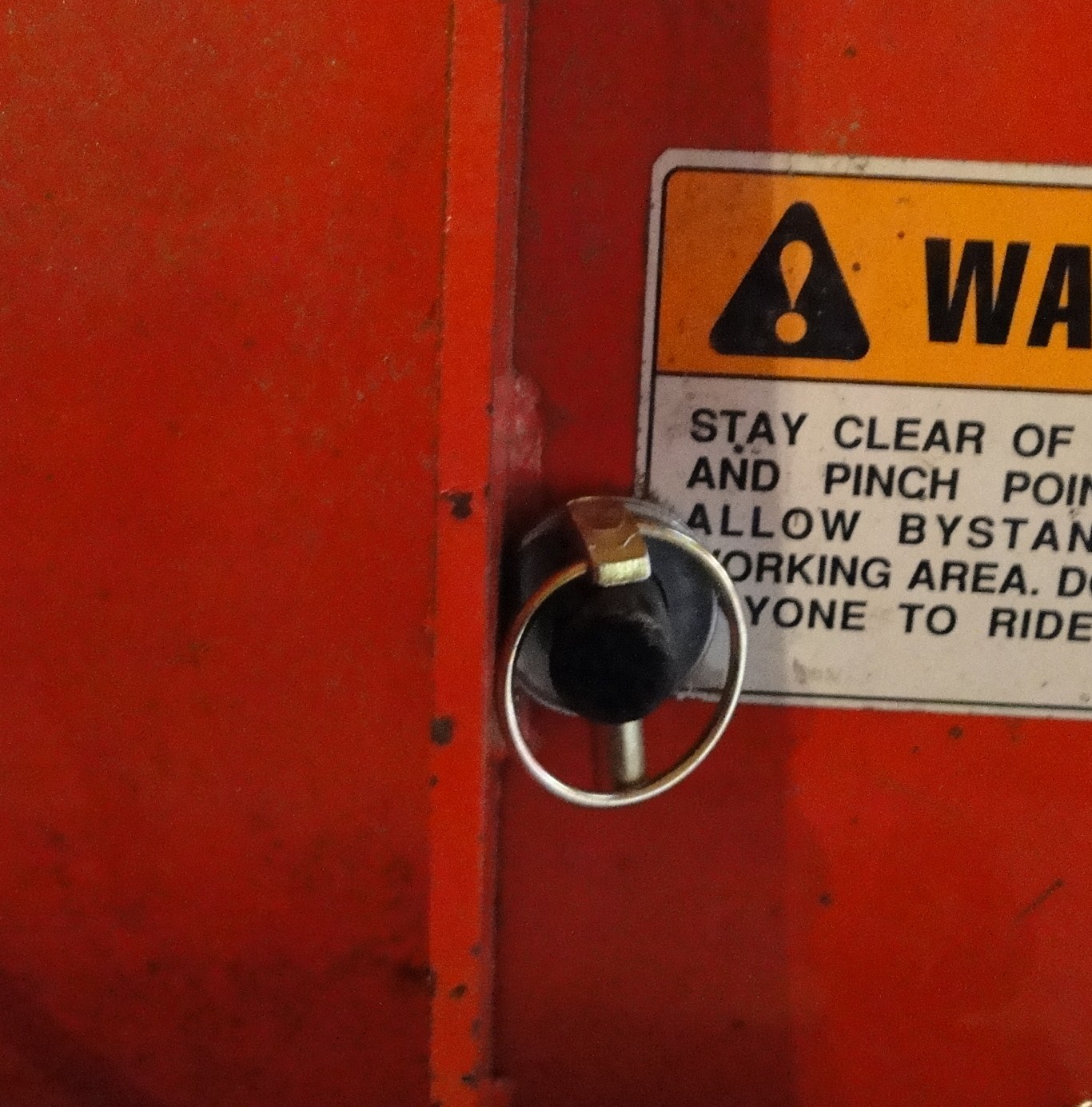

I found the time to install the wings over the weekend. The hardest part, as expected, was drilling the 1-1/8 holes in the blade. The wings give an extra 22 inches of plow length, as was advertised in the literature. The wing material is about 3/16 thick and the welds on the hinge plates don't run the entire length of the contact. The rubber sweeper panels that close the gap between the wing, blade ends and ground surface are about an inch thick. We'll see how they perform in about 4 months...
Here are a few photos of the pieces and install.
