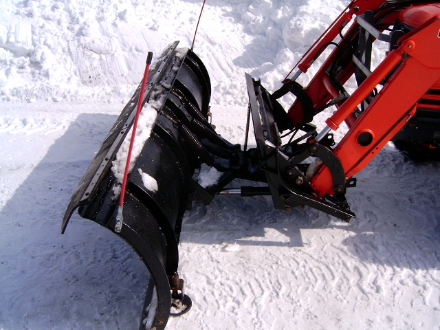

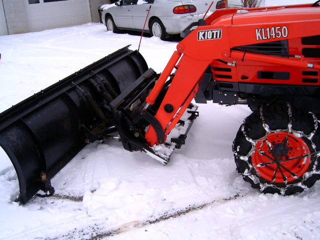

I'm wondering how others plow with the new SSQA? Loader arms or sub frame mounted plow?
I recently traded in my BX 23 with a sub frame mounted snow plow and bought a B2610 with the SSQA. The BX 23 was a plowing machine, easy to use - up,down, left and right and it worked perfect
I'm having problems getting used to the loader arm mounted plow. Its so picky on the height of the loader arms and angle of the curl. A little high on the loader arms and the blade digs in, a little low and the blade rides high. the curl cant be too far back either.
Its a great feature to be able to take the plow off and put the 72" bucket with the SSQA but its not easy to plow compared to the sub frame mounted plow.
I'm thinking of getting the sub frame and plow and returning the SSQA plow to the dealer, which he said he would gladly do.
With the sub frame plow I would have to take the loader arms off to attach the plow and put them back on when I needed a bucket.
Pictures below show the SSQA plow uses a chain for a float so it can follow the counter of the ground and that works well if the loader arms are adjusted just right.

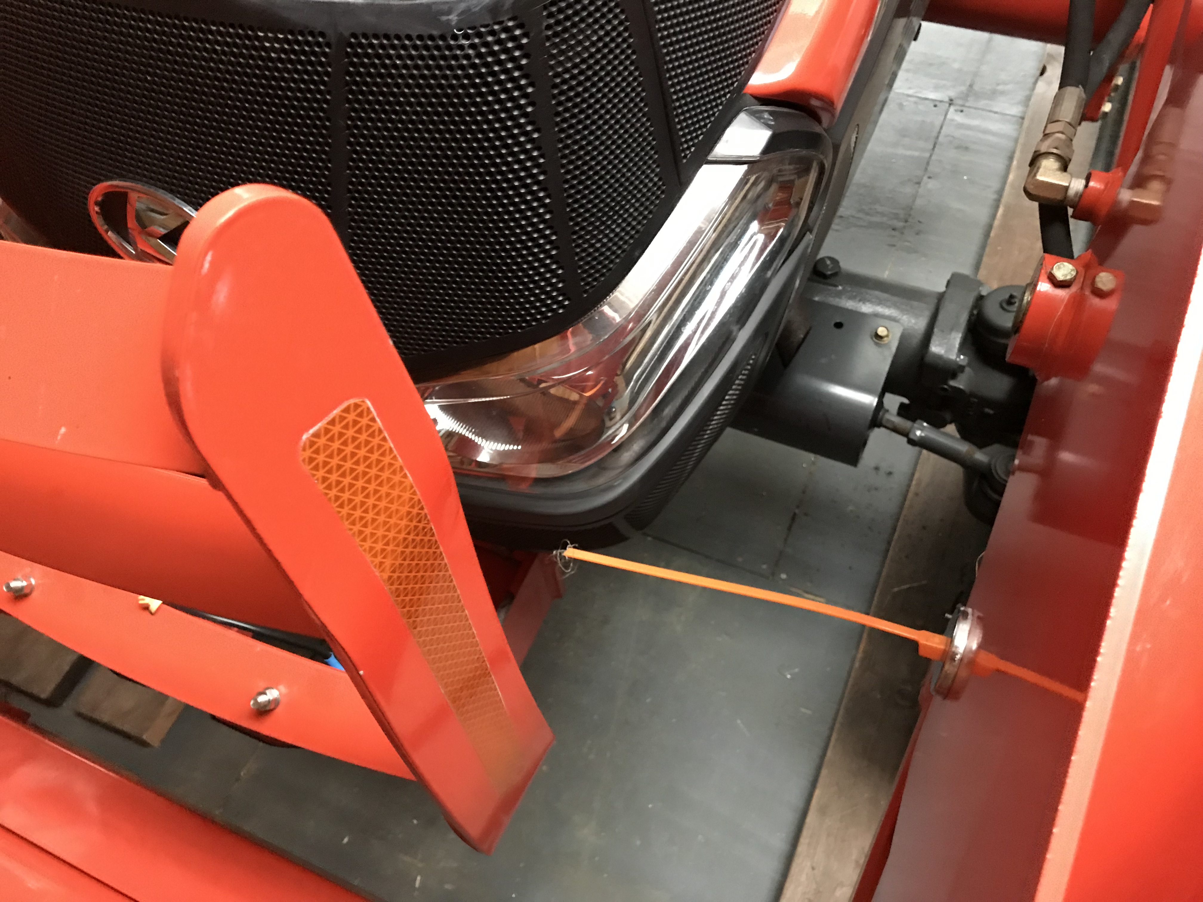

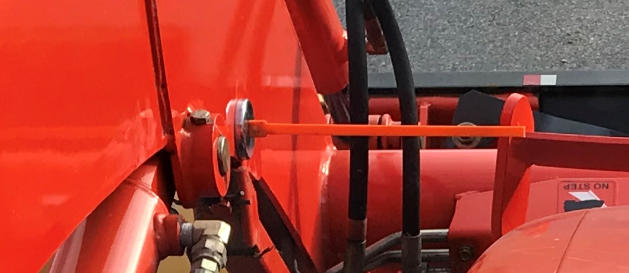

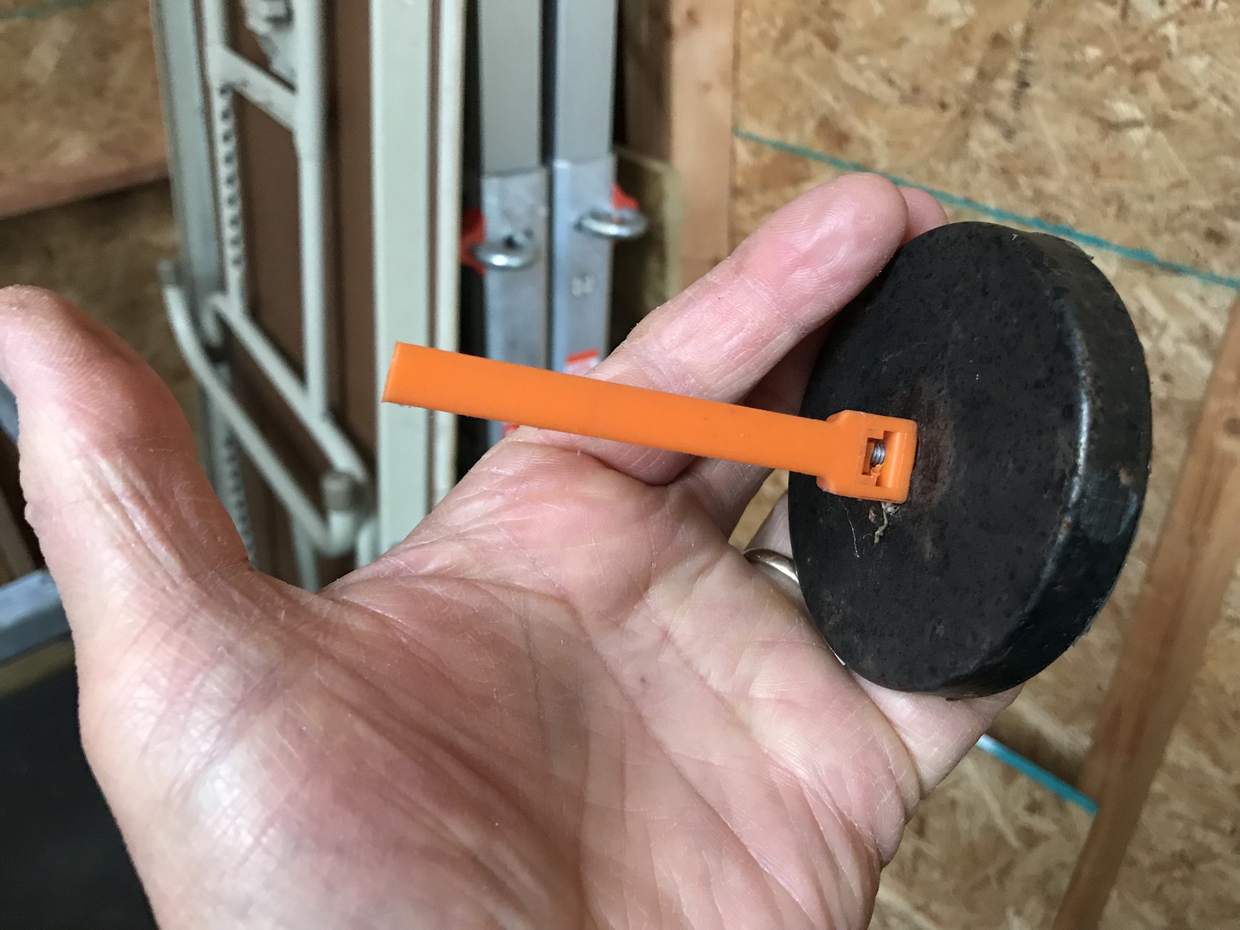

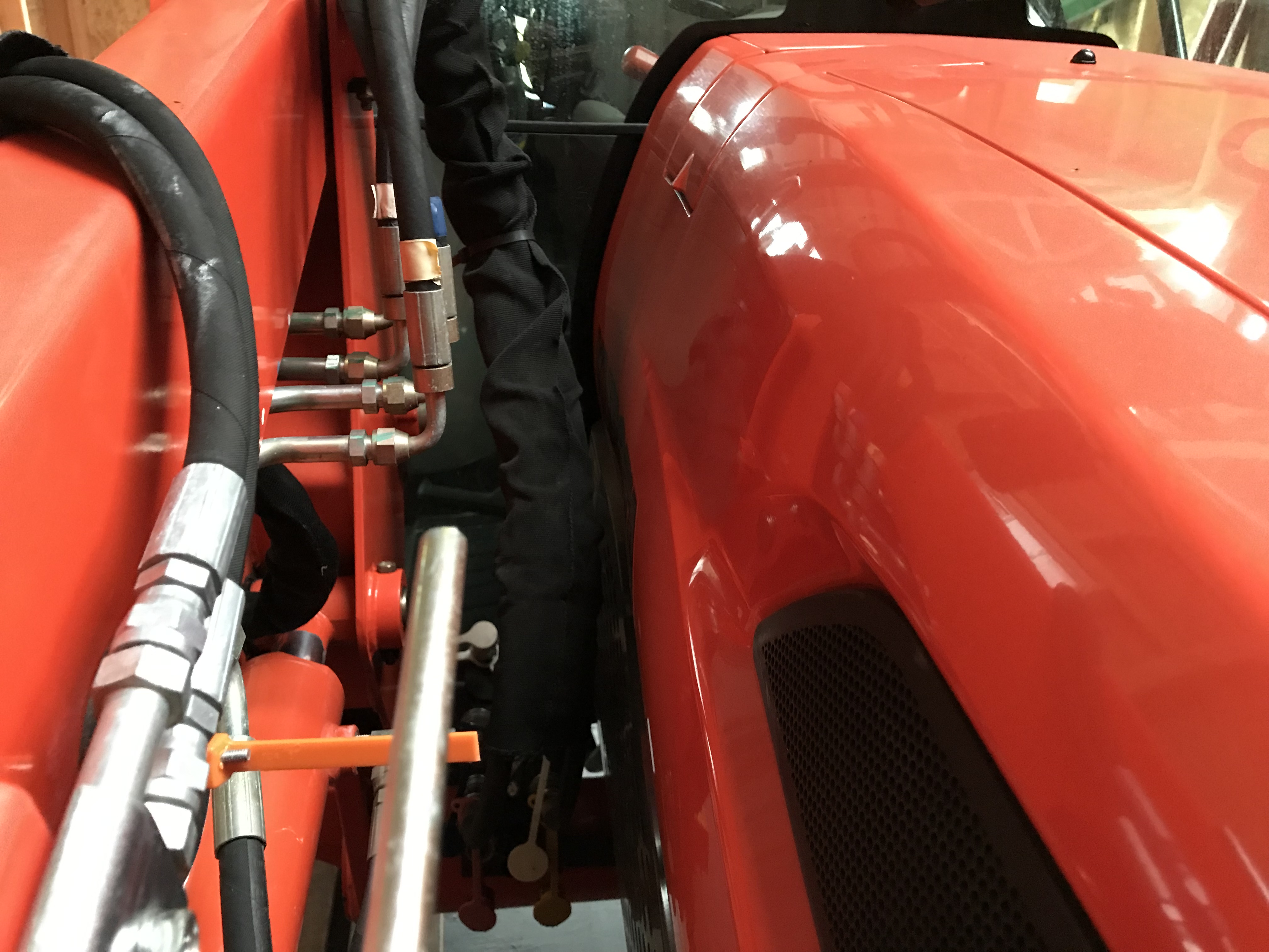

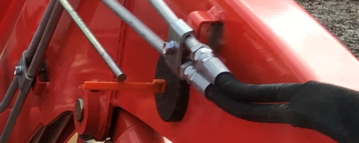

I have a similar setup and will take a couple pictures of the simple home made indicators that might help. They're just two magnets with Tyrap "whiskers" for referencing the loader position.
Here is how my setup works. There are two ordinary magnets with holes in the center. A piece of a large Tyrap is held onto them with a screw from the underside. The magnets are placed on the loader arms to make the up/down and curl/dump positions easily repeatable.
One is located on the inside of the right arm so it is at the tip of the level indicator rod when the curl/dump is set. The other is placed on the inside of the left arm and references to the grille guard when the height is set.
The other picture shows what I was describing about the height of the lower ends of the FEL arms when the plow is set to the normal plowing position. There's close to a foot of clearance between them and the pavement. The blade has slack in the chains, and has a good range of movement to follow the contours encountered. It does well without applying the weight of the FEL arms. Probably because the blade was designed to work on a pickup truck without any down pressure. I have encountered a couple spots where traffic mashed the snow down and it was handy to be able to press down on it.

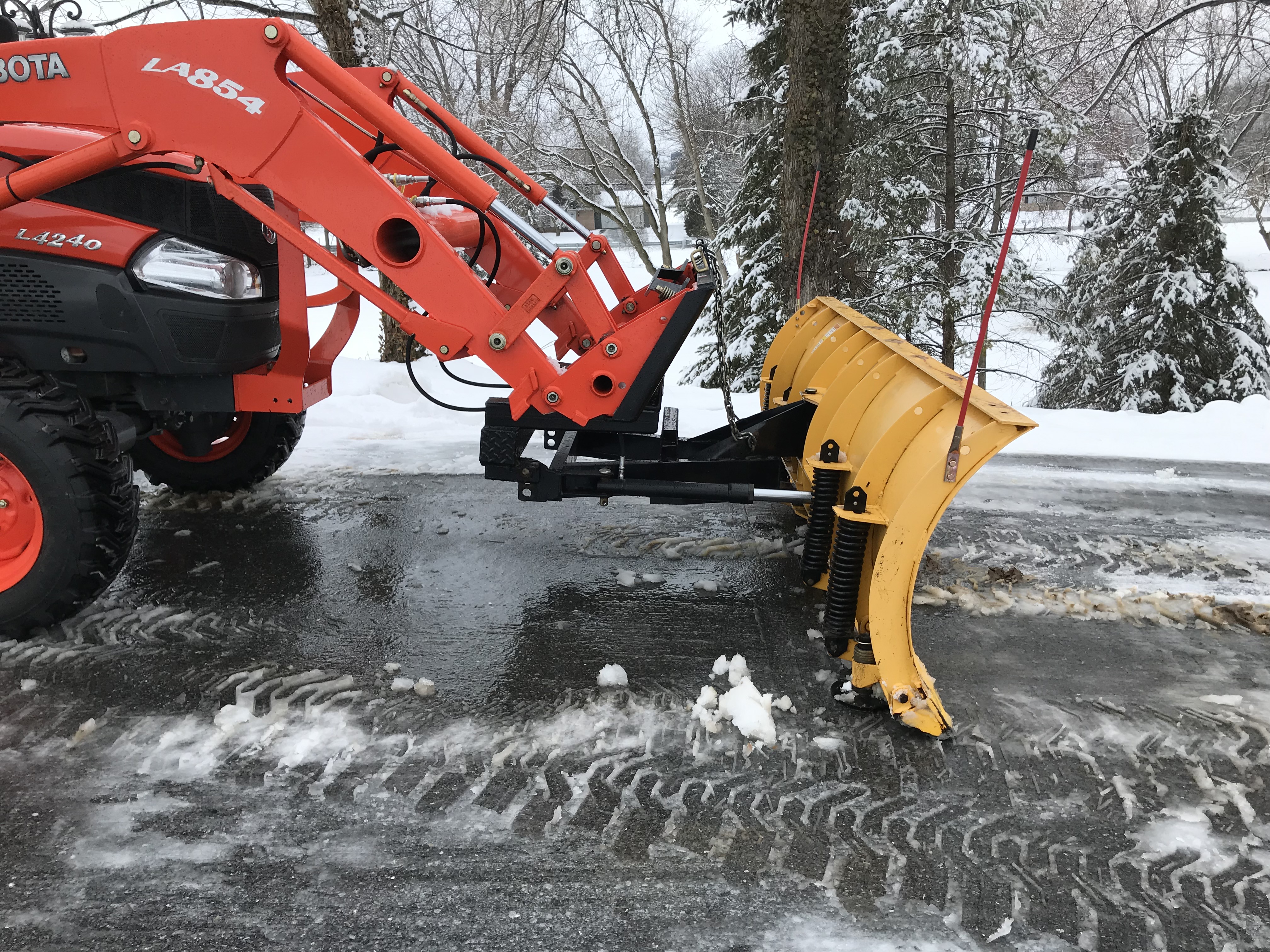

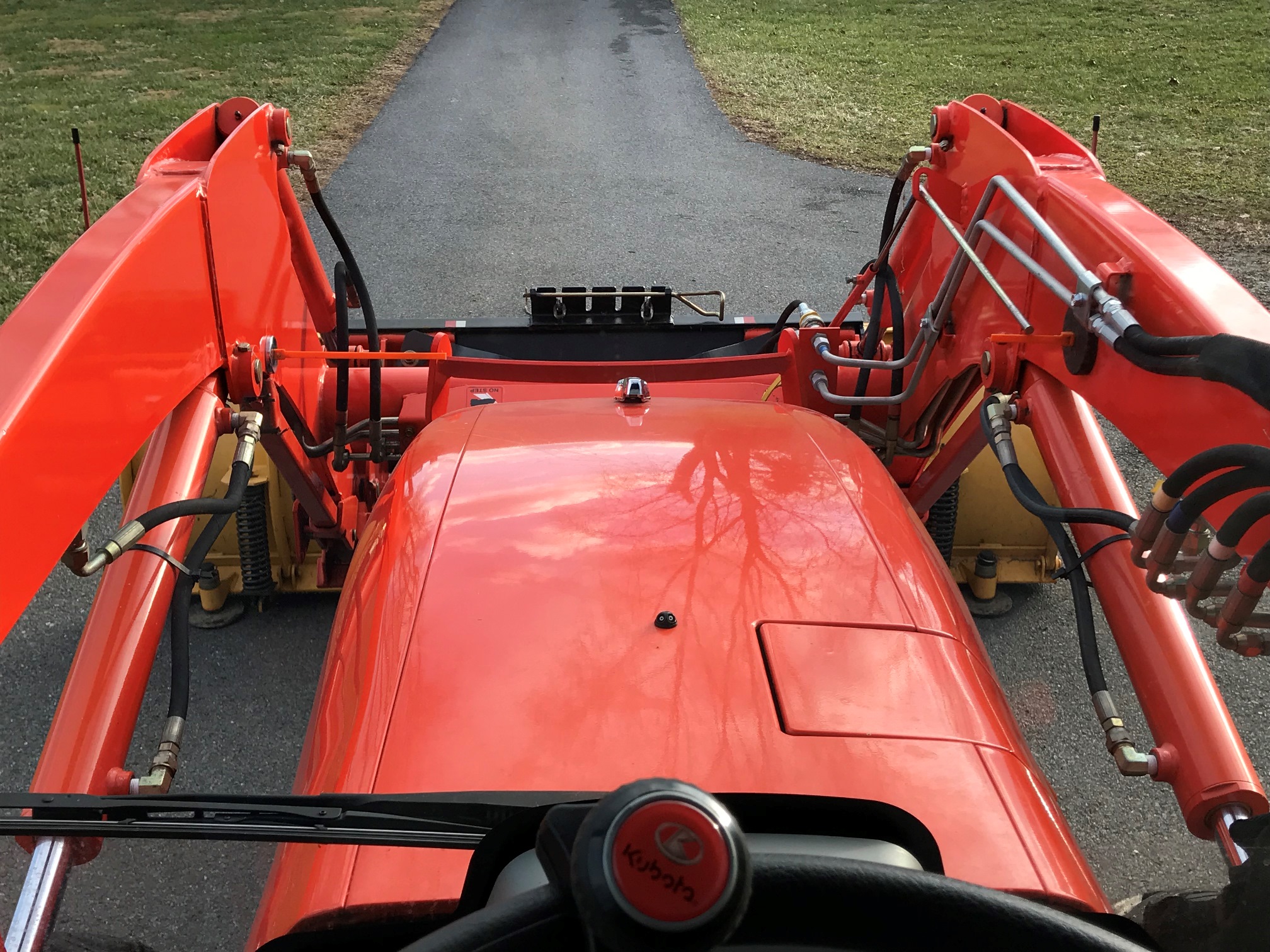

Better Pictures and Explanation

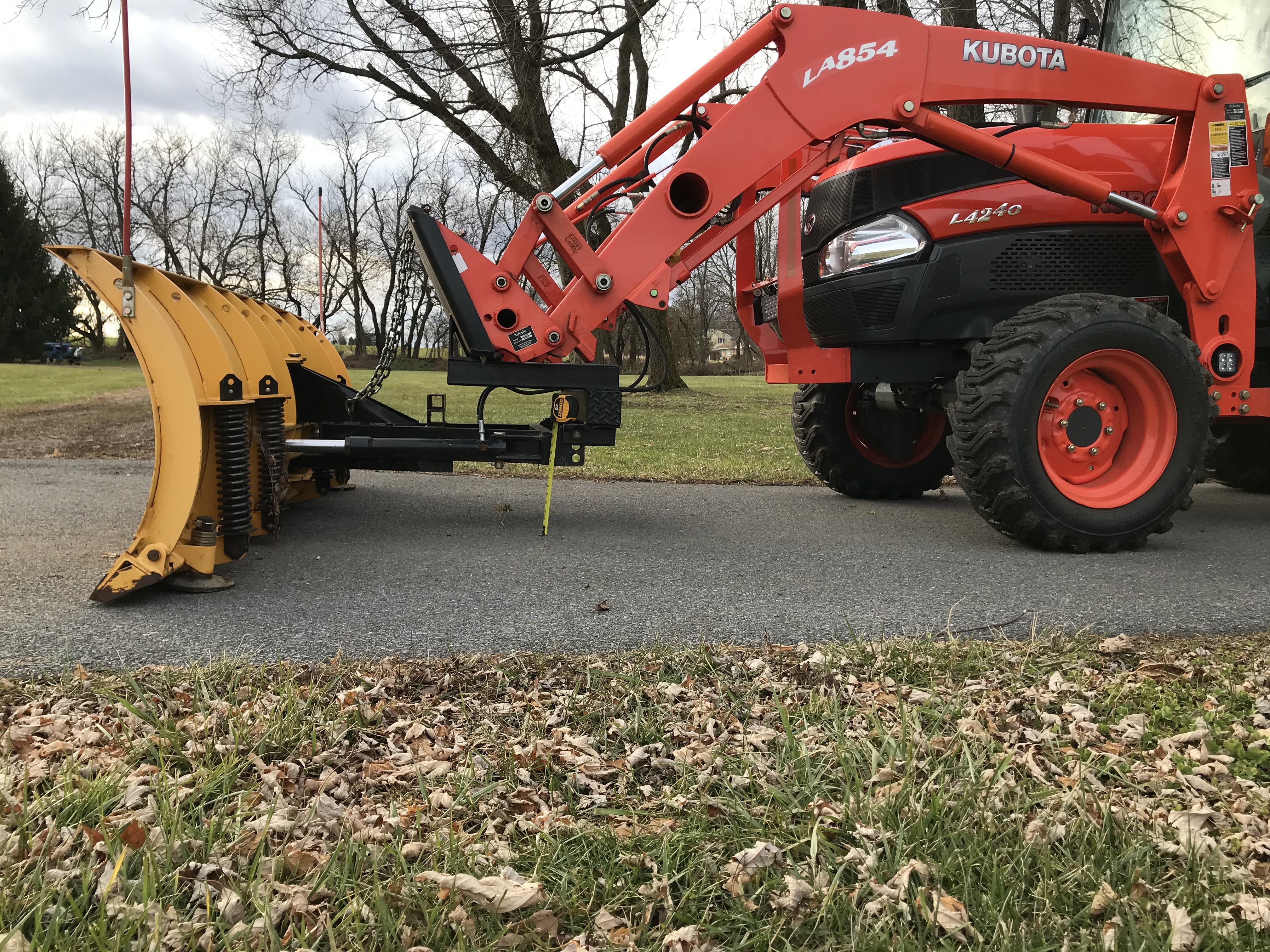

Today was a nice day to park the RFM for the season and swap the bucket for the plow. The pictures I posted earlier weren't the greatest, so I snapped some today. The first photo shows what it looks like from the cab. In real life, the Tyraps are more easily seen than in this shot - more like the larger pics below. They are a simple method of getting the blade set straight vertically and having slack in the lifting chains.
For just pushing straight, the axis of the pivot point of the blade can be somewhat off vertical without being much of a problem. It becomes more important as the blade is rotated to cast snow to the side. The farther off of vertical the pivot point is, the more one tip of the blade will make contact with the driveway while the other end wants to be off the ground when the blade is rotated.
Second is a blowup of the left side. When the Tyrap is even with the crosspiece of the grille guard, the FEL arms are the ideal height.
Third is the right side. When the rod of the FEL level indicator is at the Tyrap, the SSQA plate is at the proper angle.
Last is a side view of the plow adjusted correctly. The frame is parallel with the driveway. That makes the pivot point perpendicular with the driveway surface. Adjusted this way, the entire bottom edge of the blade contacts the driveway surface regardless of how the blade is rotated.
The clearance between the frame and driveway is a measured 8-1/2". That's not as much as I had thought, but plenty to keep it from dragging.
