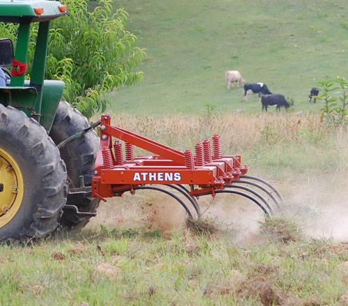

Guys I’ve had 2 acres of woods cleared for food plots last summer. The ground has never been worked and it’s been compacted by the dozer that cleared the trees. I’ve tried breaking up the ground with a chisel plow and a 3pt disc, but neither did more than scratch the surface. Someone said I should try a plow at least for the first couple times to get the soil lose and then I should be able to use my chisel plow or disc.
Just wondering what size plow would work on my tractor. I’m gonna look for something cheap. My LS is 39hp and weighs 3900lbs and is 4wd.

Was the soil MOIST when you attempted to work it?
Many implements are marketed as chisel plows. Some are much lighter than others. Plains chisel plows usually require a tractor with 100 horsepower to pull through the earth.
How about a picture? Or the weight of the implement, number of tines, and the brand?
Chisel plows are conservation plows, which slice the earth while leaving 15% to 20% of the soil surface intact, to reduce water and wind erosion.
You can use a Moldboard Plow or a Disc Plow (which is NOT a Disc Harrow) but that will leave sloped land subject to water erosion for three to five months. Is your plot land sloped?

Photo #1 Plains Chisel Plow - Primary Tillage

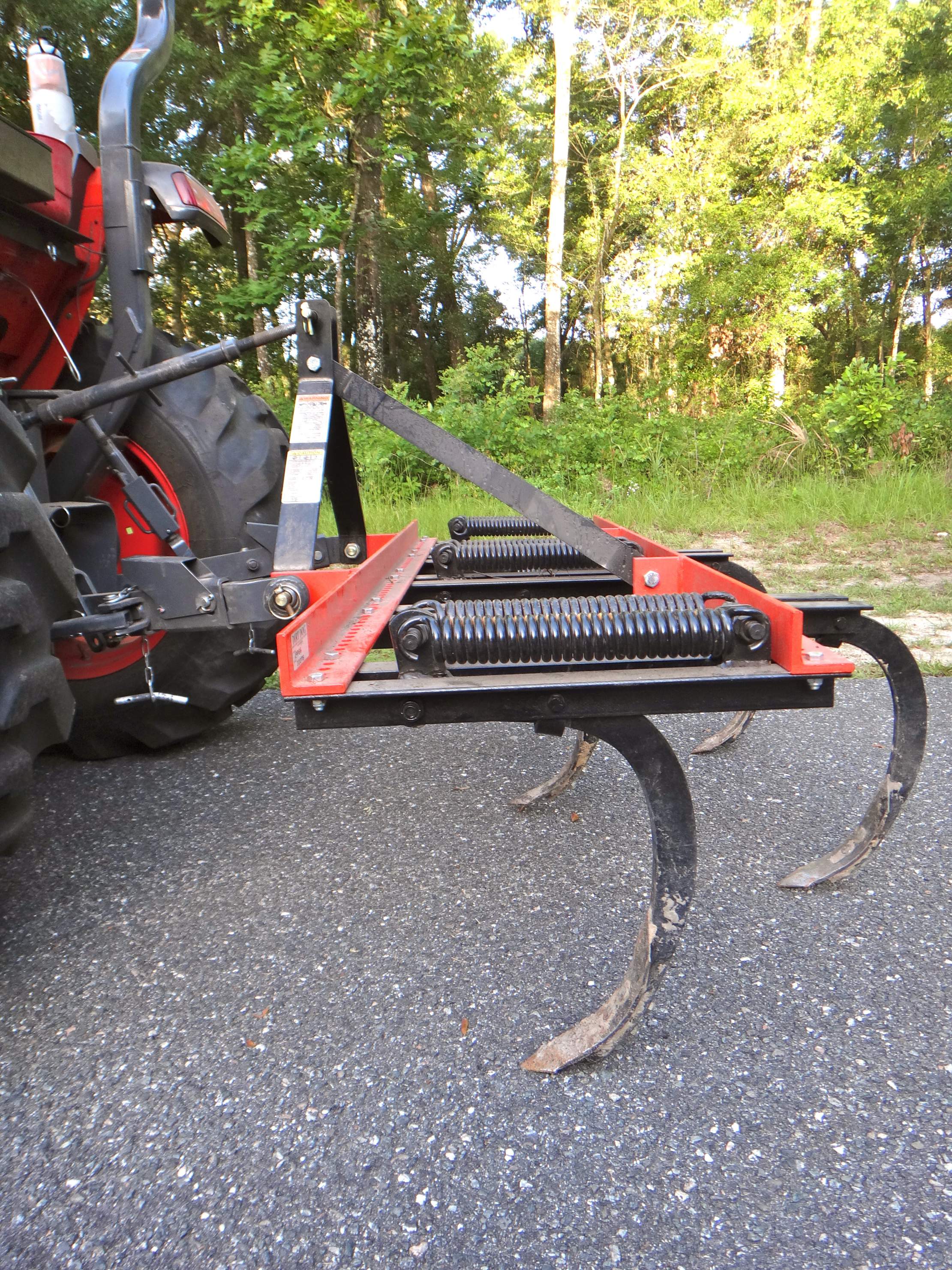

Photo #2 Dirt Dog brand Field Cultivator - Secondary Tillage

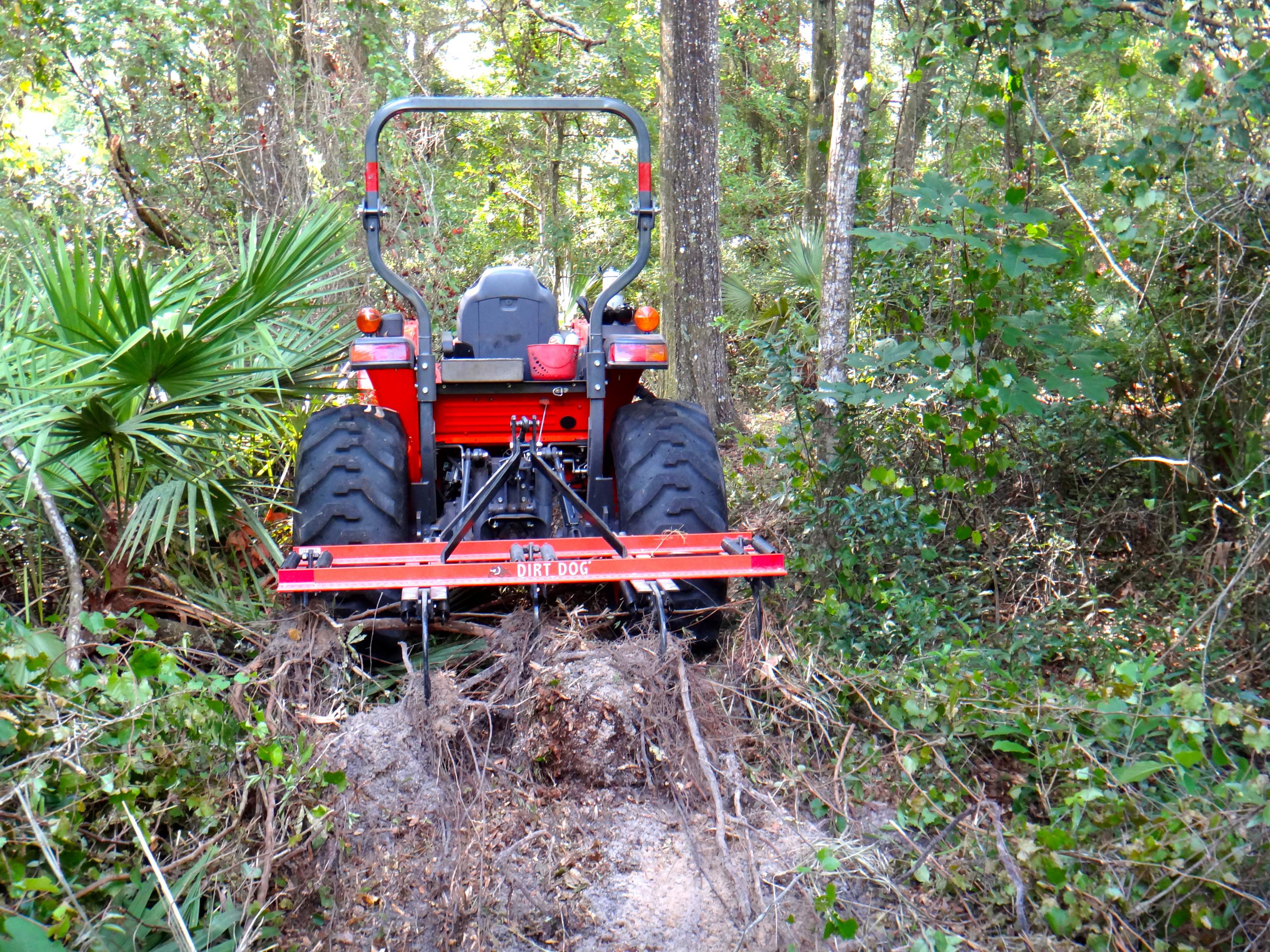

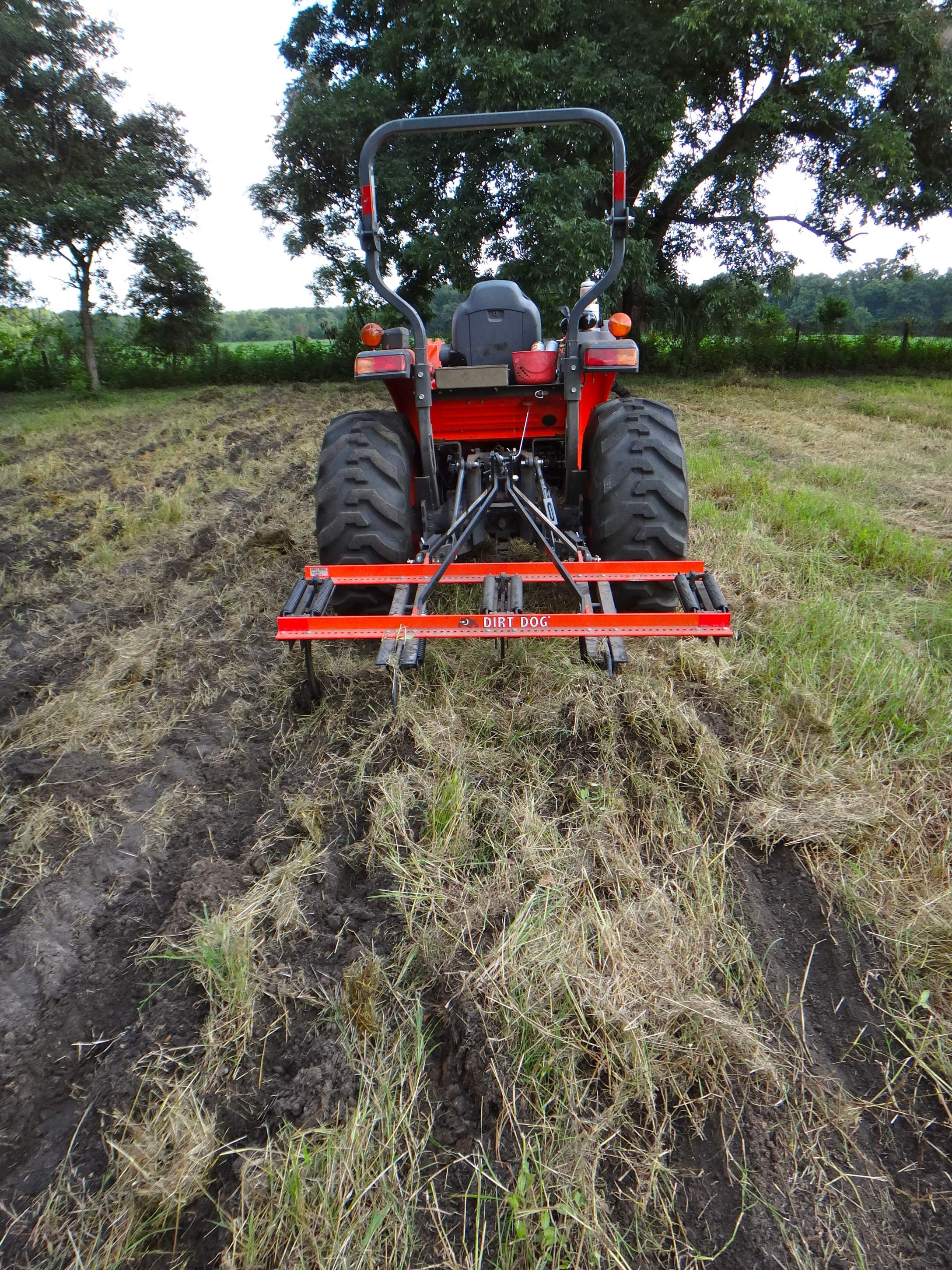

Photo #3, #4 Dirt Dog brand Field Cultivator at work in MOIST sandy loam.
