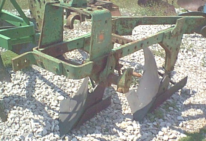

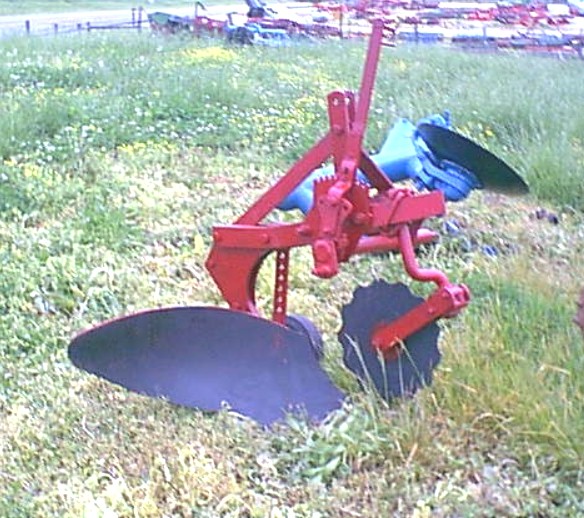

A plow like this Pittsburg 1 bottom or this 2-12 Oliver trip Beam plow would work fine. $425 your choice + modest shipping. Ken Sweet

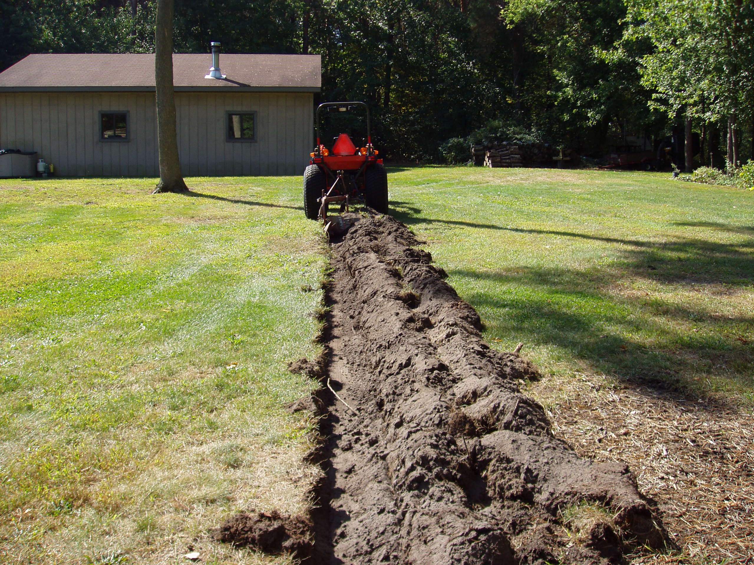

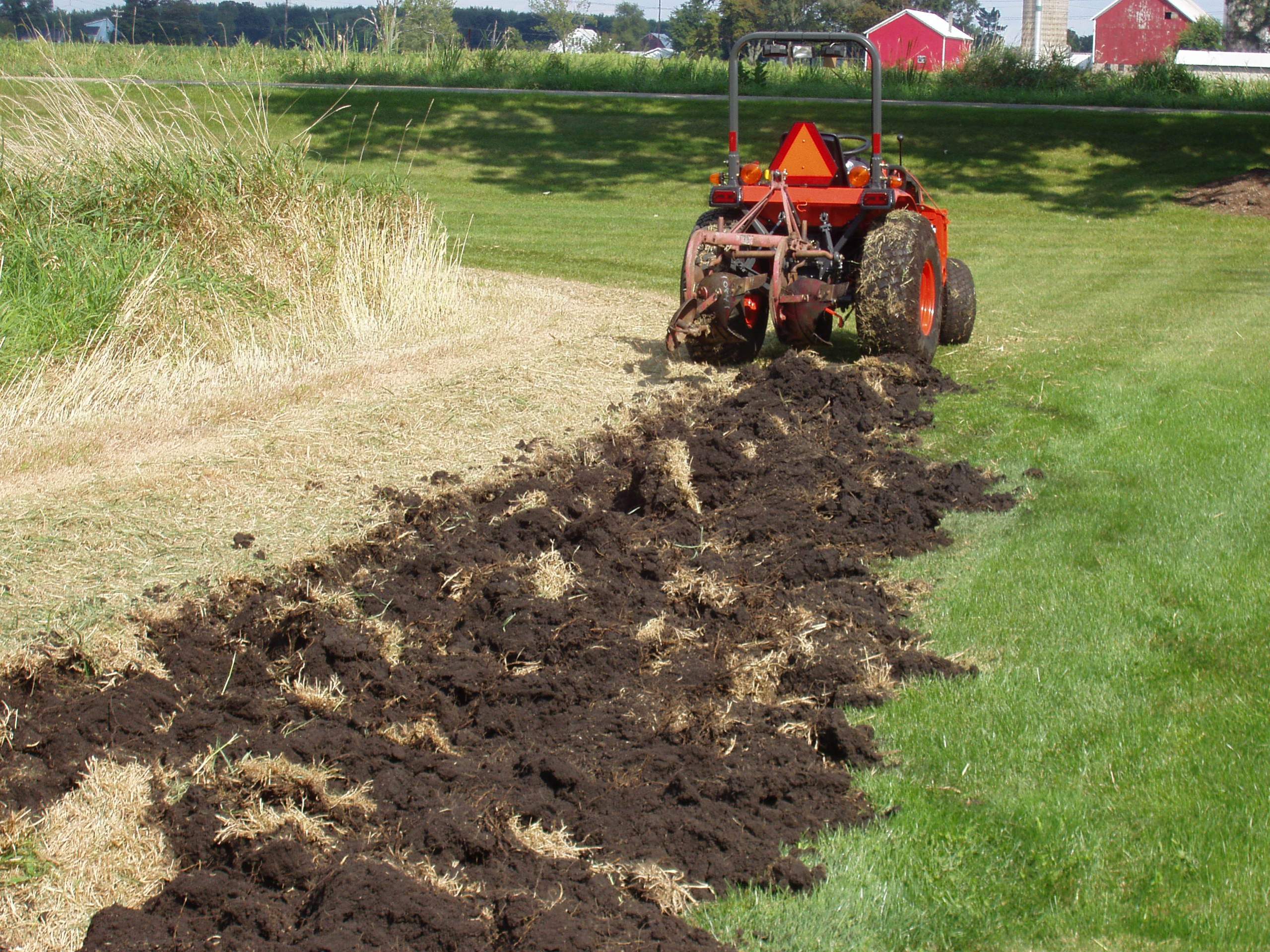

I have a B3030 with loaded turfs and pull a 2X14" in light soil without any trouble. With that said, the big issue with a B3030 and a 2X14 plow is the rear wheel track. The width between the tires is only about 24 inches and the plow covers 28 inches.The plow must be adjusted so it pulls itself into a full plow width. That is done by rotating the plow drawbar. The drawbar is bent at each end to keep the plow level when the tractor wheel is in the furrow. This offset, when rotated forward or back, also sets how the plow follows the tratctor. I set the telescopic links so the plow starts in the correct position but pulls itself straight once it is in the ground. I use the slotted portion portion of the links so there is some play for the plow to move side to side a small amount.
If adjusted properly a B3030 can pull a 2X14 but a set of wheel spacers to increase the track would be a big help. A 2X12" plow would be ideal but they are hard to find. For small plots a 1 bottom plow would make a lot of sense for ease of setup. All of the old 3PTH plows were designed for tractors with much wider wheel tracks than the modern compacts. For small plots they can be made to work, but they will never be ideal. Of course, a CUT is not a field tractor meant to pull a plow over 40 acres anyway. The compromise is possible however, which is the beauty of a CUT. They can do a wide variety of tasks which is why we buy them. Good luck and I hope you find a good plow. BTW, I paid $250 for my 2 bottom. Don't worry about the turf tires. They will do a good job if the ground is dry.
