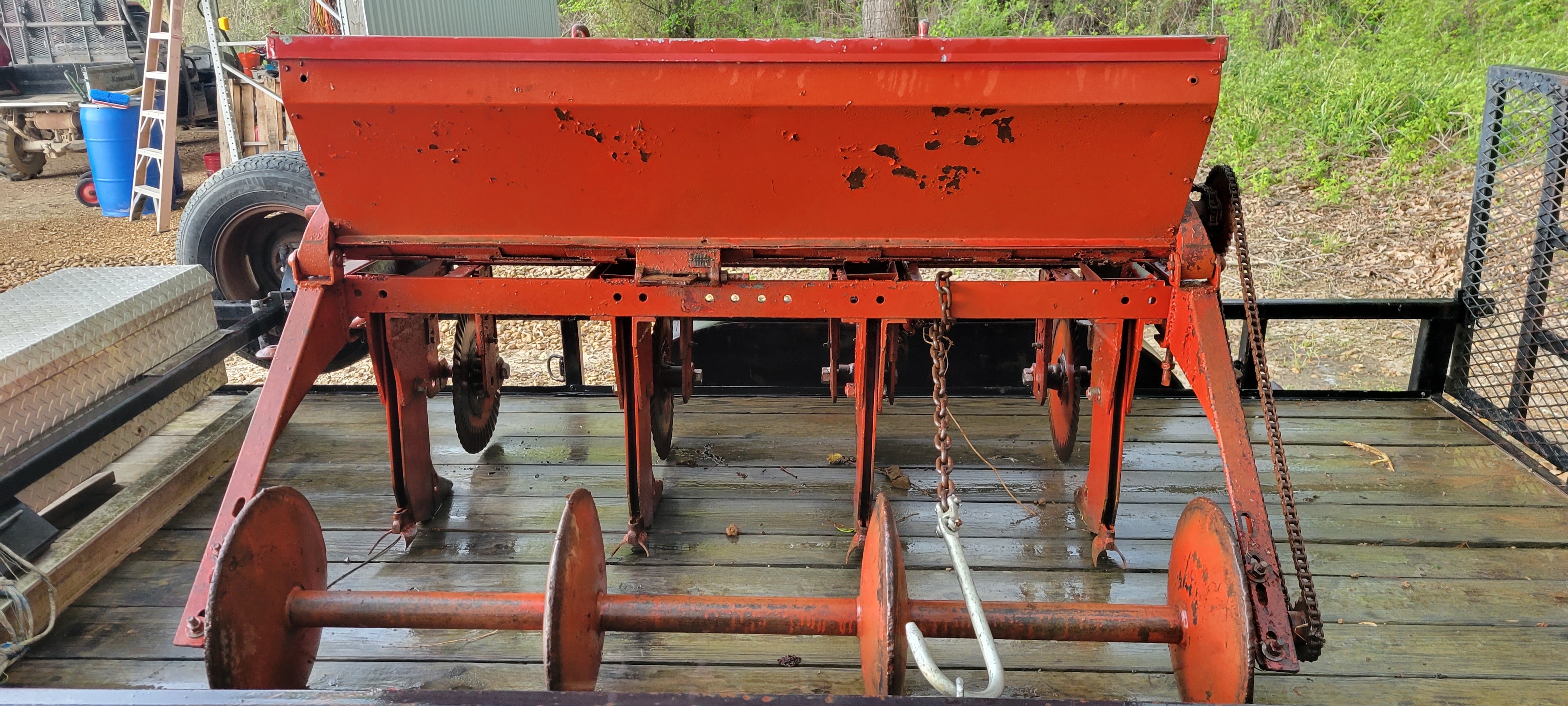

It would probably take as many passes with a Plotmaster as using a disk, cone spreader and drag to plant a foodplot to get a good stand.
One pass plowing, seeding, covering is a fantasy that will never be fully accomplished.
I am currently retrofitting a Taylor Pasture Dream to plant into existing crops or cover. Almost got it finished, just need some free time to finish.
It will not ‘till’ the ground, rather cut a slit and drop seeds either into or on top of the minimum disturbed soil and covered with a drag chain and a cultipacker wheel to close the slot.
As close as I will ever be to ‘One Pass Planting’!
