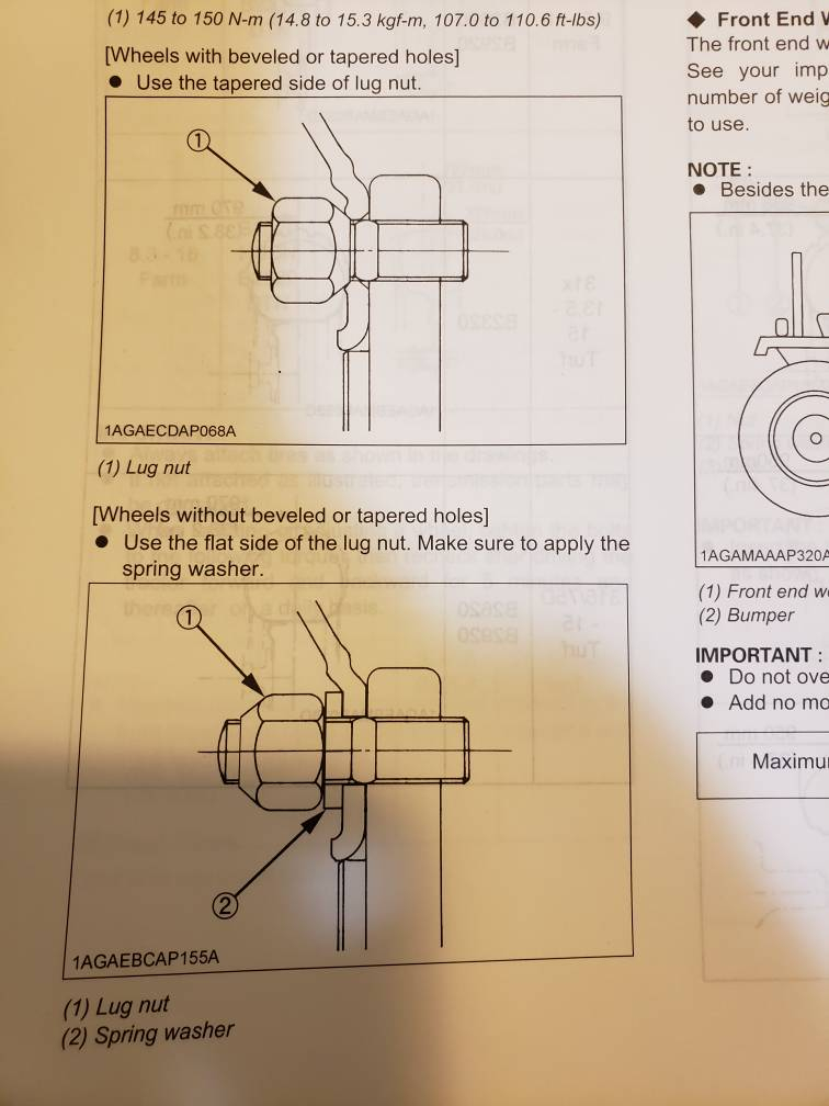

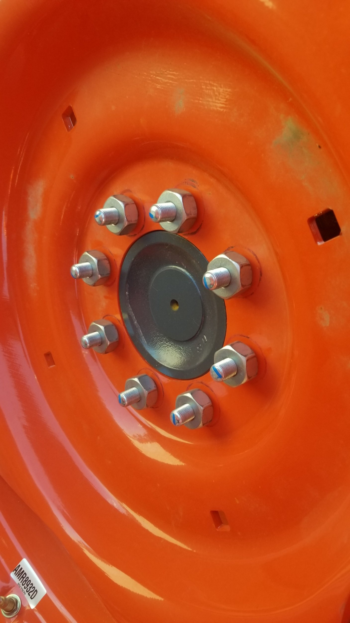

I've never seen a taper facing out so it caught my attention and the other two tractors had the lugs installed as to what I would expect.
I don't know if those are washers or a flat face on the nut. The second picture definitely looks like a washer though.

"the other two tractors had the lugs installed as to what I would expect".
(1) Two out of three are correct?
(2) Two out of three are wrong?
I will go with the first option!

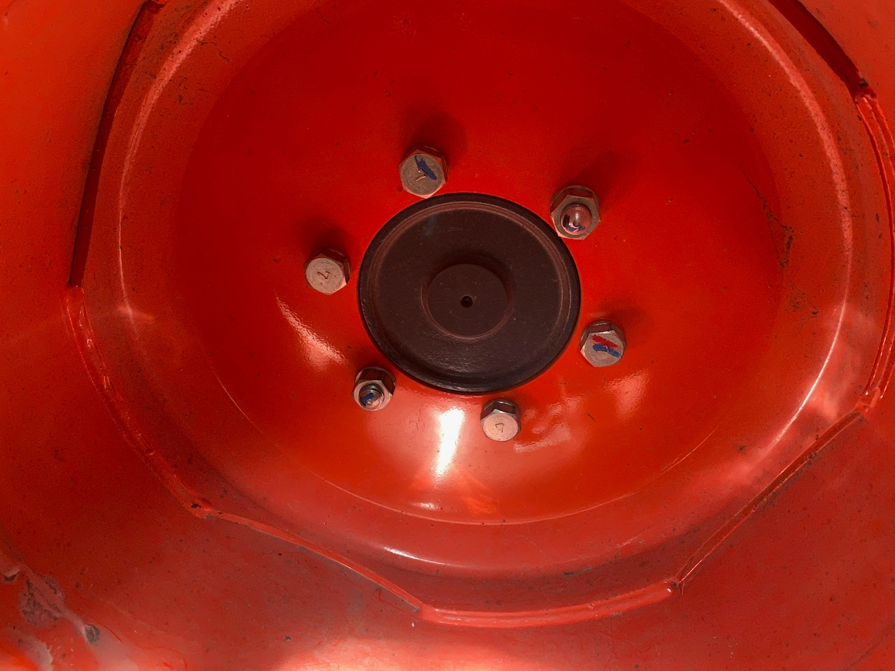

There are suspicious washer marks on the other one though.
Maybe that's just the end of the wrench socket that marred up the paint.
   / Please tell me this isn't what I think it is #24
If you look at the original pictures, the washer is the same size or slightly smaller in od, so I think your assessment that it is socket marks is the correct answer.

Could be the washers are tapered? Unlikely but possible. I agree without taking one off I wouldn't be to quick to shoot arrows at anyone. If I was the one looking at this in person I'd certainly bring it to someone's attention so they could do that. If it is wrong it should be corrected.
   / Please tell me this isn't what I think it is #29
Could be the blue mark is to keep track ones that were torqed. Good picture though, you can see the washers under the lug nuts.
