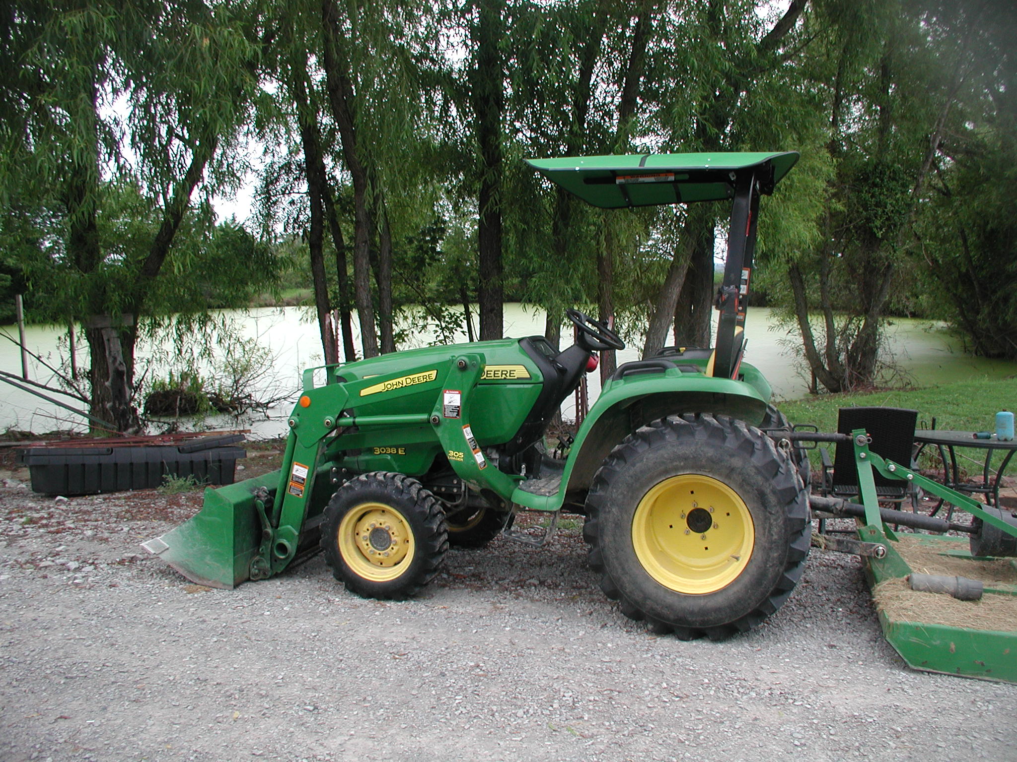

I have read here about using 4 to 6 inch PVC pipe and I like that idea, not sure how to attach PVC to a tractor though. If you have another solution please show me that too.
John
PS I have plastic fenders/hood so those are not a good mounting spot for me. It is a loader tractor but how to mount to the loader frame?
   / Please show me your tractor chain storage solutions.
#2
This is the tractor I want chain storage for,

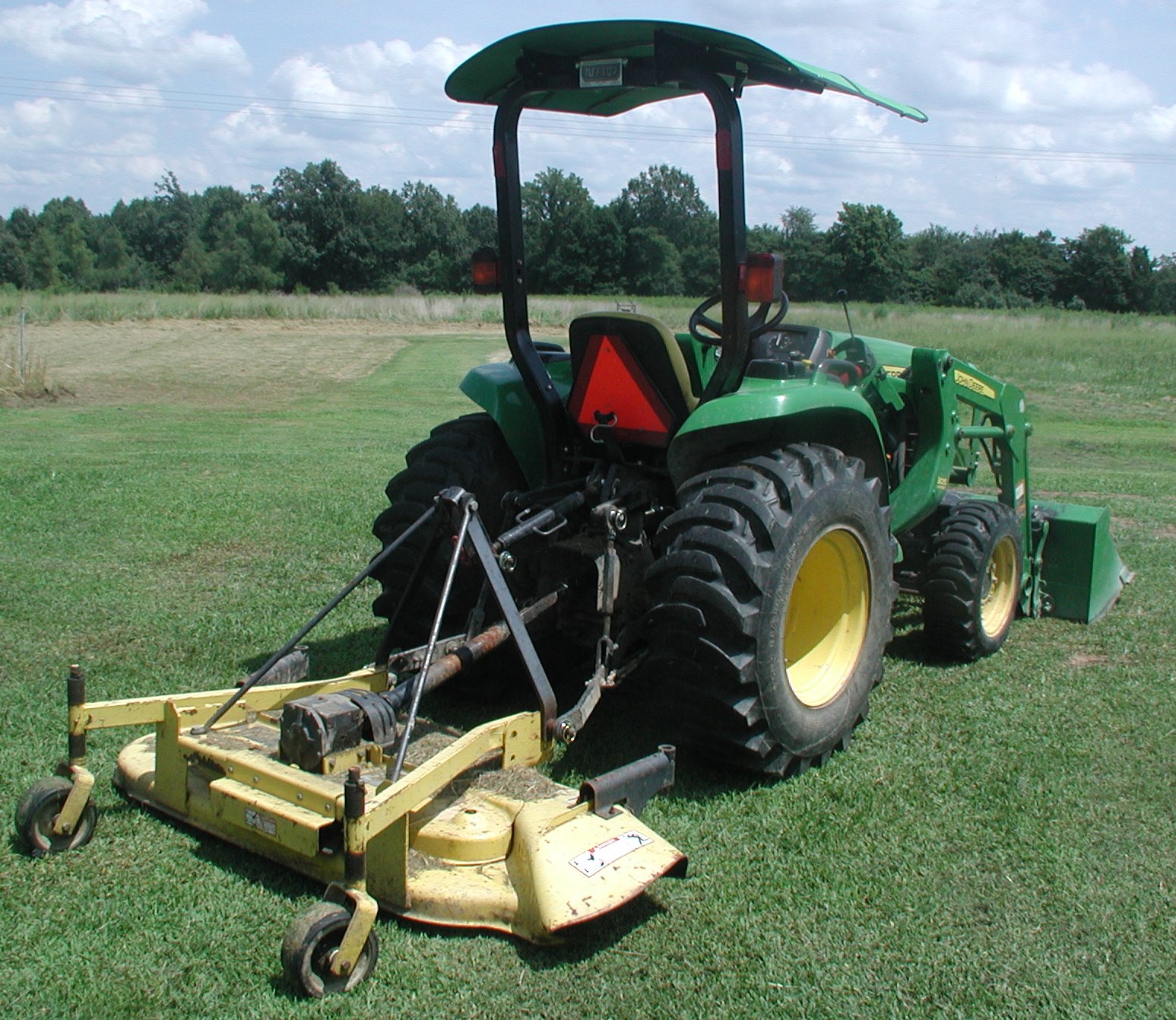

How about heating 1/2" all thread rods with a propane torch and bend it into U shape and use angle iron as the base to make big U bolts to attach large PVC pipe to the ROPS for chains.

Here is a pic of the back of the tractor, if this helps, I think is has to go on the ROPS like CjR said or maybe a metal tool box mounted somewhere? Though the back side of the driver side loader frame bracket might be a good location for the PVC?
