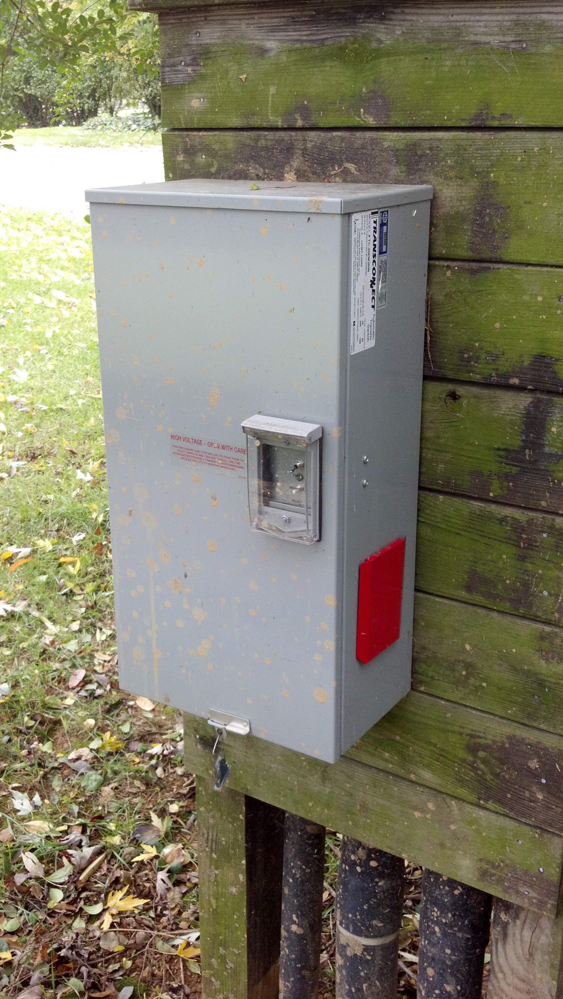

Howdy,
My first consideration would be the connection. The size of amperage needed, and then the generator itself. Having bulk off-road diesel helps with this part. Multiple tractors also helps with the type of generator. I have and use a bunch of different generators. But, when the power is going to be off a long time, a tractor is hooked to a pto generator to supply power.
JD 6430 using 540E with 30kw pto generator with the engine turning at a miserly 1580rpm using 1.1 gallons an hour. The load ranges between 5kw to about 22kw. Connection is through full power connection at the central farm distribution at the meter. Works great. :cool2:
