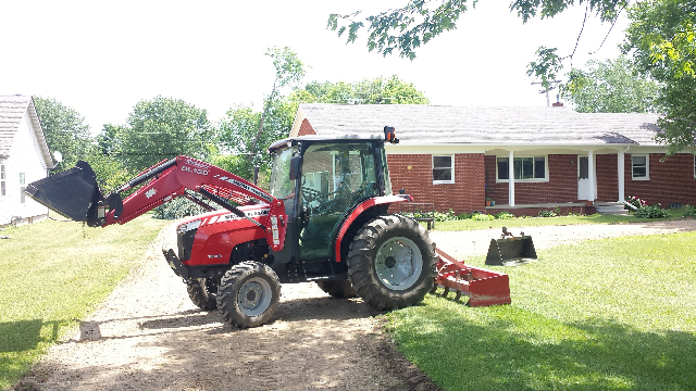

Everyone seems to think that my Massey is sexy ... and she likes the camera!
Masseys are the best looking tractors and they even have musical theme music.
