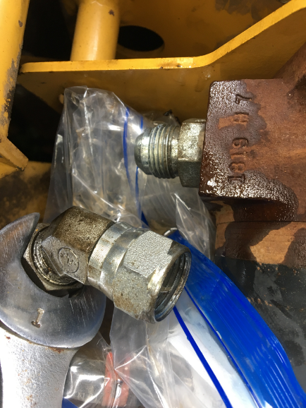

I'm working on my first hydraulic system (Magnatrac 7000) and I'm having problems identifying the fitting size going into the track motors. It is hard getting super accurate caliper measurements because of tight spaces, but it is the male thread OD is close to .75". And it appears to be 37˚JIC.
What dash size is that?

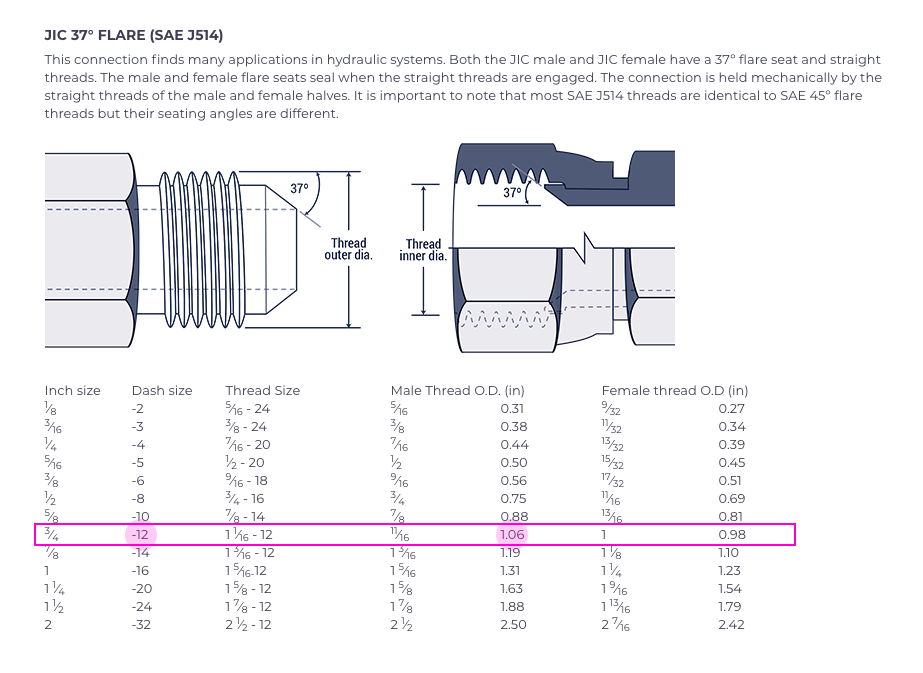

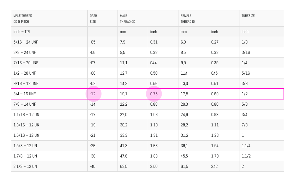

Some sources claim that -12 has male thread OD is 0.75.
Others claim that -12 male thread OD is 1.06.

Looks like that male fitting would come off faster than you can type the post. I’d suggest pulling that fitting and getting the measurements you need. Better yet, drag that fitting to a local auto parts, heavy machinery or tractor store and match it up. With it off you can, at least, verify with the link above.
The other option is to order some fittings to verify size and style. Common fittings won’t go to waste. JICxIP etc seem to get used up......hydraulic hoses are consumables- like oil, tires and blades.

I didn't even think of getting the male fitting completely out of the motor! Thank you.

SAE & JIC Thread sizes
# 4. 7/16-20
#6. 9/16-18
#8 3/4-16
#10. 7/8-14
#12. 1 1/16-12
