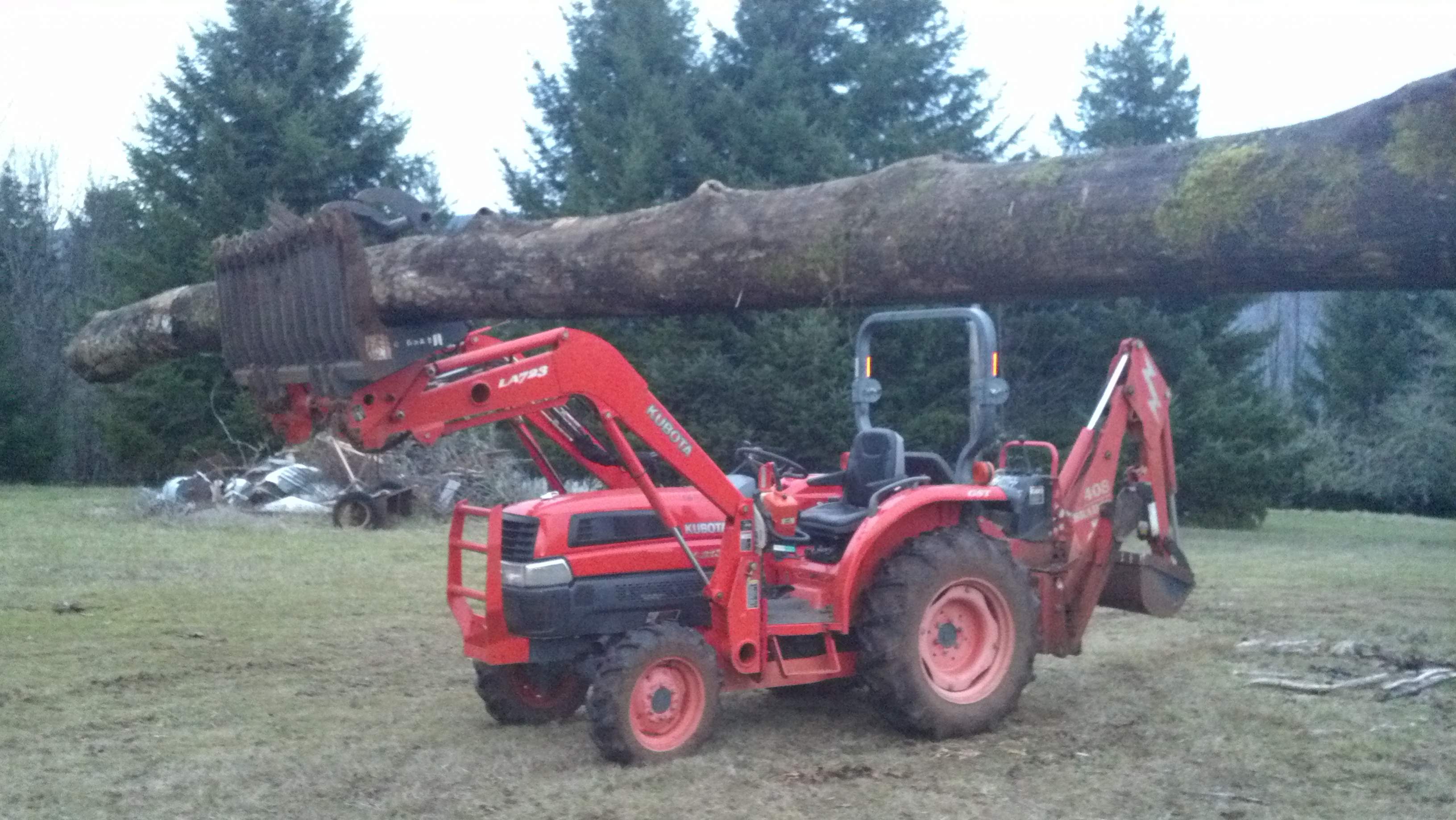

If you are getting a grapple look at the WR Long third function remote, it makes using a grapple easy as you have grapple operation on the loader control and you can clamp and curl at same time, making operation a whole lock easier and efficient.
Using one of the rear remotes is akward and you need three hands to use the grapple effectively. I have two rear Kubota remotes and they are by your side and you would have to keep switching between the two handles just to clamp something. The grapples I think are the single most useful attachment that I have for the tractor, they are on about 75% of the time and use them for raking, trash cleanup, light smoothing, wood cutting and moving boulders.
For rear counterweight I used as heavy as you can get box scraper. It is also cheaper to get the loader quick connect and buckets at the same time as the buckets are different for the pin on and quick connect.
David Kb7uns
