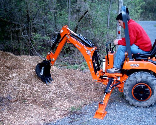

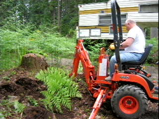

Would someone take a picture of themselves running the BX22/23 hoe or the BX2200/2230 with the Woods hoe so we can all see how the ROPS interference issue is or isn't an issue.
In specific: I would like to see a body sitting on a tractor while operating the Hoe. Also a couple of detail pics on how the 22/23 ROPS is different from the 2200/2230.

Here is one of My brother in-law running my BX23.

Thank you, Steve! Just what I was looking for. /forums/images/graemlins/smile.gif

Heres one of me on my BX23. /forums/images/graemlins/grin.gif I'm 5'10 180.

I started to think about the hight of the ROPS on the BX22/23 and I believe that it is high like that to protect you in the event of a roll over. My quick guess is that it might have something to do with the hight of the hoe when it is fully compressed and pinned. Just a thought, but it can be confirmed by comparing the BX hoe and ROPS with some of the other Kubota hoe models and there ROPS. My bet is that there is a ratio effect that they need to maintain for safety.

I don't have any pictures of myself on the tractor under the ROPS on my BX23 but the pics the other posters put up gives a pretty good representation of the operator position to ROPS height. What they don't show however is that the ROPS on the BX23 is also tall enough that you can stand up in the backhoe operators seat and still not hit your head on the ROPS. I have thought a few times myself that the ROPS is too tall - mostly because I keep thinking about adding a canopy to my tractor, and I think a canopy on the BX23 will look goofy because it will so far above the tractor. But as far as giving a nice operators station for the backhoe the BX23 ROPS is pretty good.

I'm 5'10" and clear fine (2"-3") Previously I posted about the distance from the seat back corner to the ROPS on the BX2230 during the installation. Look at the pics of that incredibly handsome man... I mean tractor.
