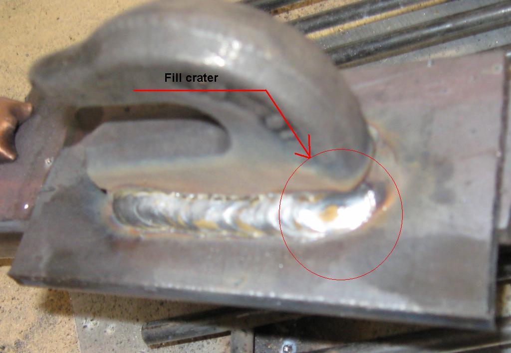

Getting ready to start welding things on the bucket of the tractor, but I haven't really welded anything in a couple years. I'm going to weld a length of 3/16" angle on the back of the bucket lip, then weld hooks and clevis mounts to that.
Before I screw up my bucket I figured it would be smart to do some practice runs.
I got some scrap pieces of 3/16 to keep everything the same and a couple extra hooks for a practice run. Running a Hobart HH187 with solid .35 wire and argon/co2 mix.
According to the chart (it's a tap machine so voltage/speed are machine settings), for 3/16 with AR/CO2 and .35 wire, the wire speed should be set at 50 and the voltage at 6 (out of 7). I kinda figured out the wire speed to the tap setting using simple math. The machine has settings from 10 to 100 for wire speed. The minimum speed on the unit is 40 IPM and max is 700 IPM, so hopefully my math was correct.

Eventually I took a shot at welding one of the hooks to a flat piece of 3/16 scrap.
Finally I took one of the hooks that are going on the bucket. This one is going on the back of the bucket just above the heel so I can lift with the bucket back if need be. The hook was welded to a 1/4" plate that I got from Ken's Bolt-on's.
This is the 1"X2" shackle mount that's going inside the bucket lip top. Also welded to one of Ken's plates.
Am I close enough for government work? Any comments, suggestions, advice or criticism is welcome and requested!

Actually not bad at all!
The first few fillets welds, looks like you need to turn your wire speed down a little bit. But first thing I would do is speed up your travel speed. The welds are just a touch lumpy.
Now those welds on the hooks, and shackle mount are all most picture perfect. I would fill the crater a little more. What I would do is turn the gun 90-degrees to the plate, close the arc length up a touch, and back up 1/4, 3/8 to 1/2-inch to let the crater fill. You are well on your way! :thumbsup:

The welds should hold up fine.I've seen better and much worse.The weld on the hooks and shackle looks a bit cold and undersized.The leg length of a fillet weld should be equal to,or greater than,the thickness of the thinner piece of metal.I don't think it would hurt to add a couple of more passes to them but that is just my opinion.It would have been better to do all the welding at once as the first pass would have preheated the pieces.Good luck with the project.

When you talk about filling the crater, do you mean the section under the edge of the hook where the bevel is? Also, turning the gun to 90 degrees, do you mean essentially perpendicular to the hook then angle it about 45 degrees? I was holding the gun at about a 20 degree or so angle to the hook and 45 degrees or so between the hook and the plate and pushed the weld. If I understand correctly, I should put the gun at 90 degree left/right to the hook so the wire goes straight in to where the bevel meets the plate.
Yes!
Now remember with a tapped machine, you'll have to make your adjustments with your wire speed. Now you can change the voltage by lengthening the arc length to a degree. With Mig I run about 3/8-inch stick out, if I want a little hotter puddle I will open the arc length up to 1/2-inch. If you go too far the puddle will cool right down, and most likely loose the arc all together! I position the gas nozzle flush with the contact tip, or have the contact tip sticking out from the gas nozzle a little bit. With Mig welding, or stick welding fillets I use an up and down motion. I want to be sure the weld is tyeing in on the toes!
Here is your picture with lack of fill in the crater. This is about the weakest spot of a weld! Now with Mig welding sometimes the start of the weld isn't all that good either. When I'm doing something really important, I'll grind my starts out, before bringing the next weld into it.
