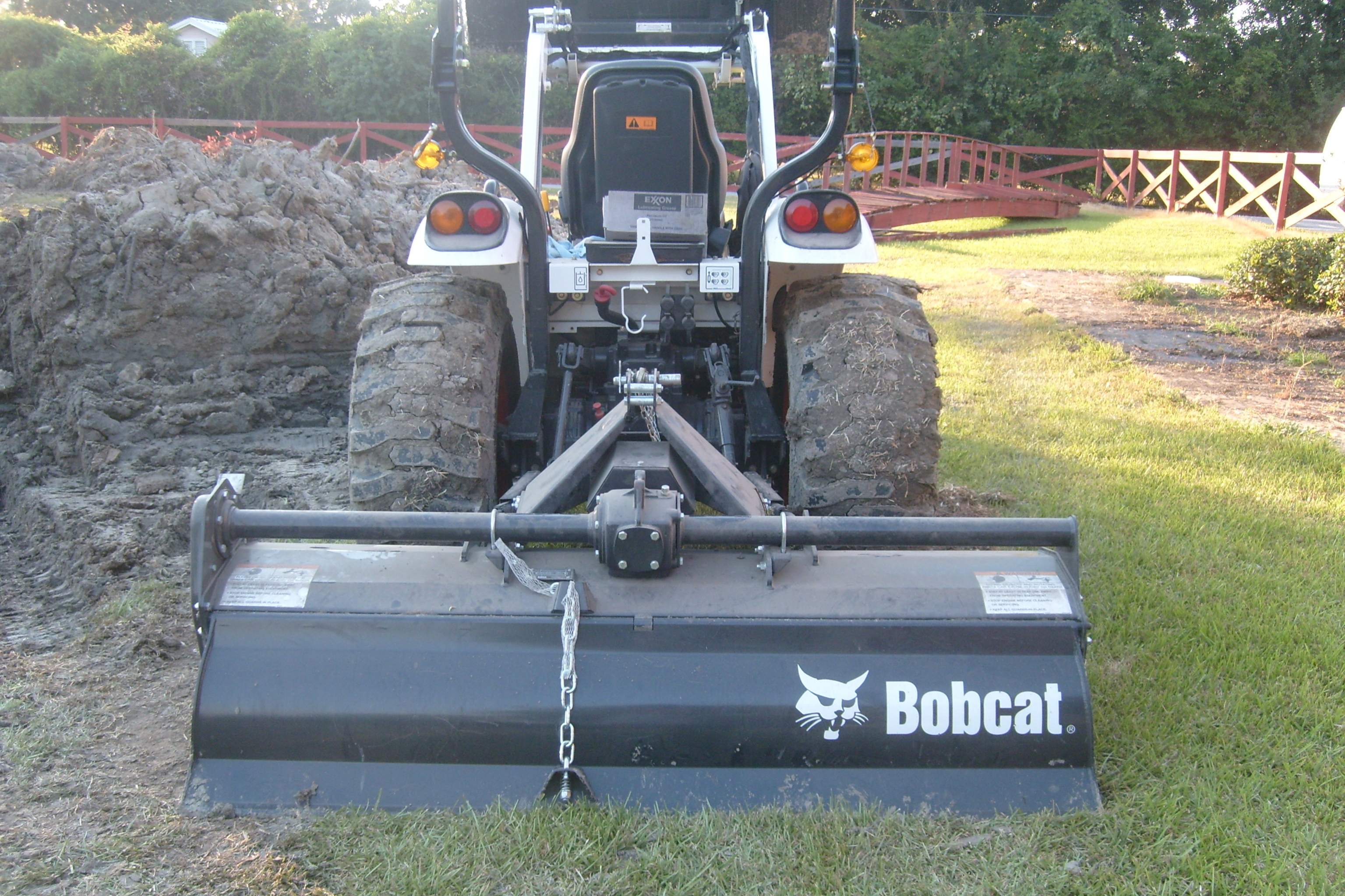

I spent the afternoon before the game cleaning out a stream bed that had silted over badly, and was now constently running over the banks, plus I got a lot of good soil mined from it for other projects
:D
   / please advise
#32
lilranch the little machine in pic couldn't reach middle of pond so as soon as that dirt is gone i'll have to rent one with more reach and dig middle out probably as much or more, thing is I could still be in shorts and tank at christmas doing this where I am :)

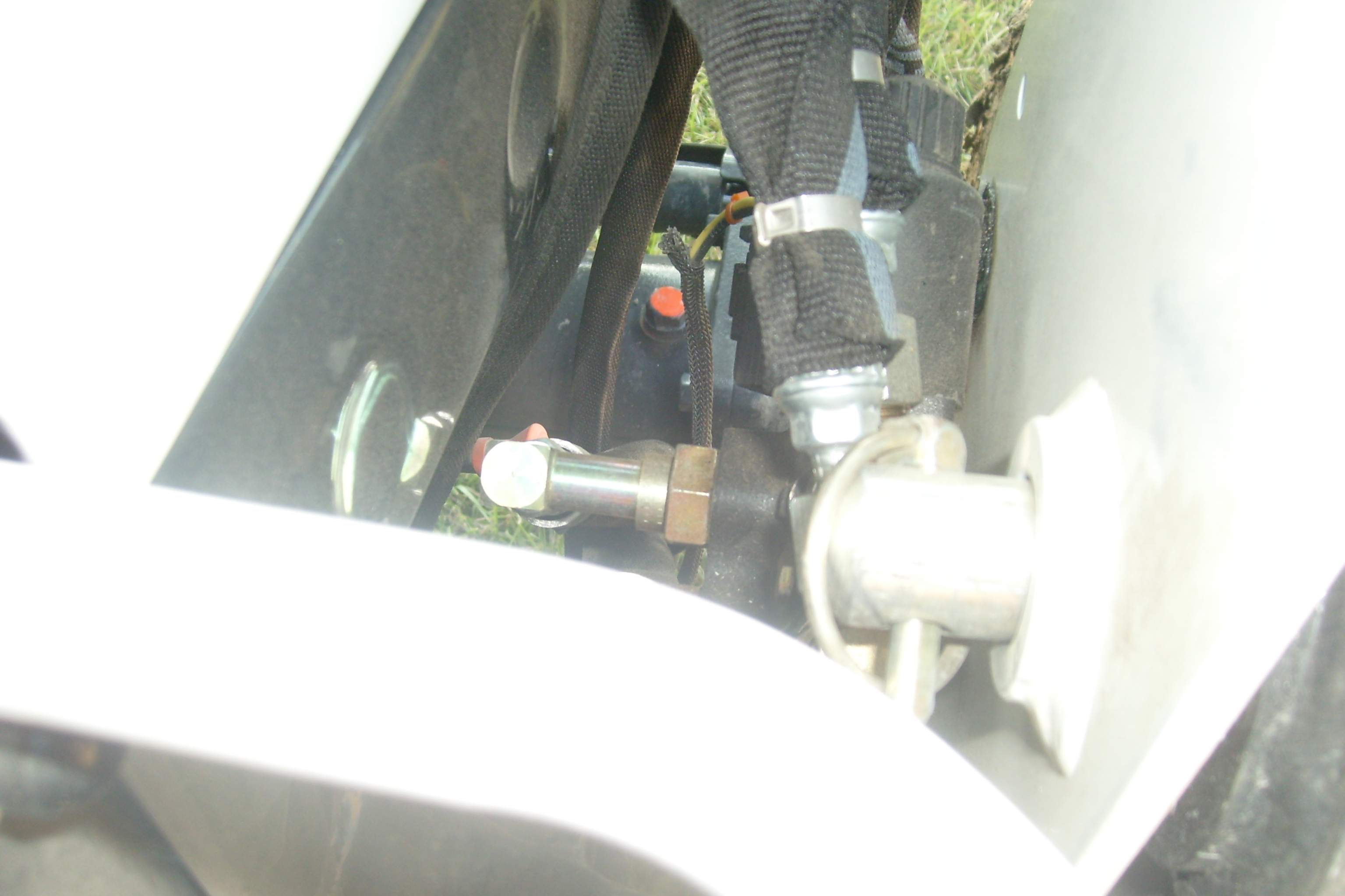

here is a couple of pics on the front aux
Thanks for posting the pics on the front aux. I'm a bit puzzled on how the quick coupler mounting bracket is attached on the left side of the FEL. It appears that the stock grease pin was removed and a new longer one installed with the bracket welded to it?
Any chance you could add a few pictures on how the hoses are routed from the rear AUX to the FEL? I'm thinking of doing something similar.
Steve
   / please advise #36
Steve
I wonder if it's a part for the CT335 factory front aux.

guy's I am on an out of town job this week will be back friday and will take pictures of plumbing . the front does come from pump not rear aux

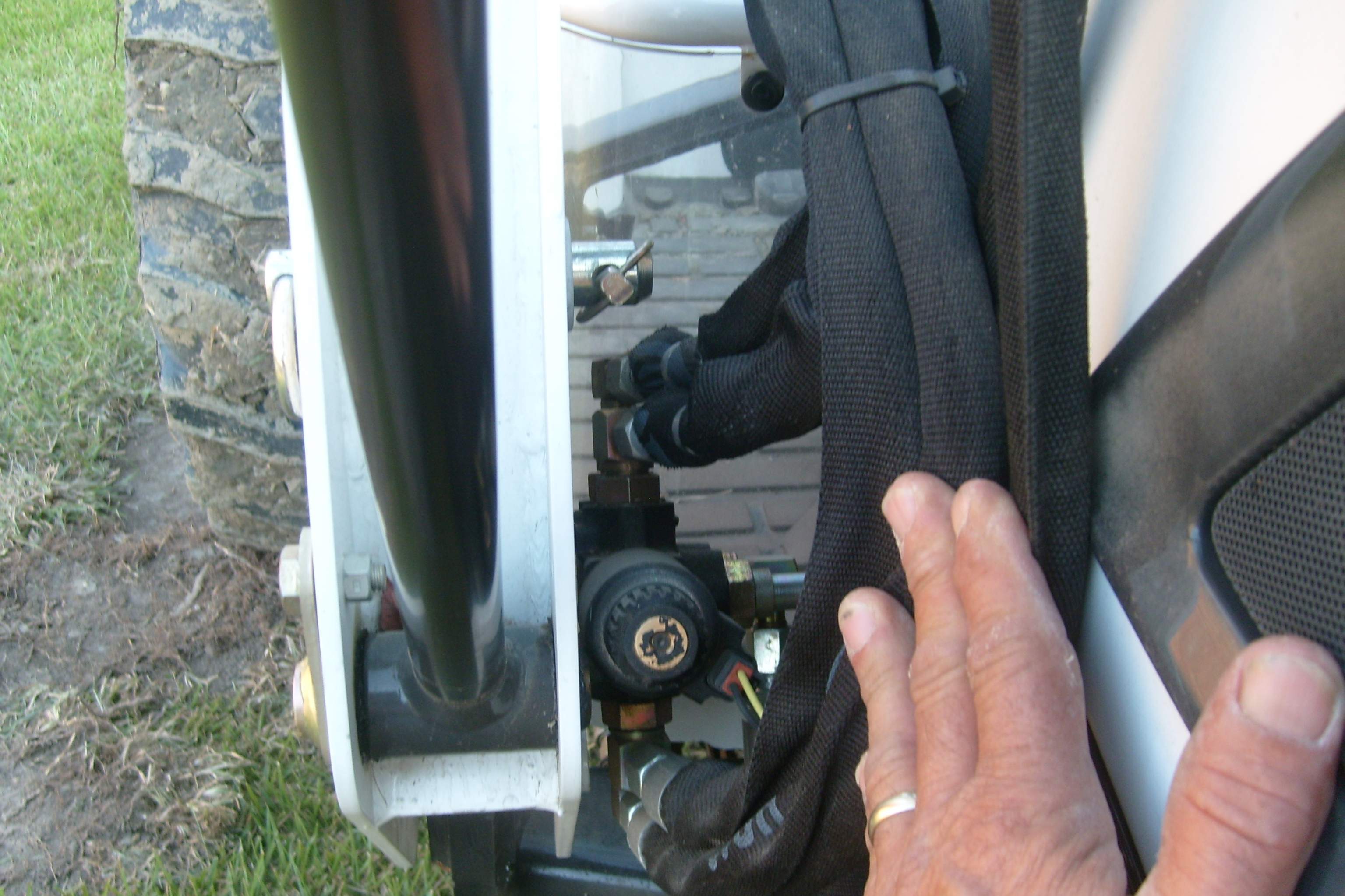

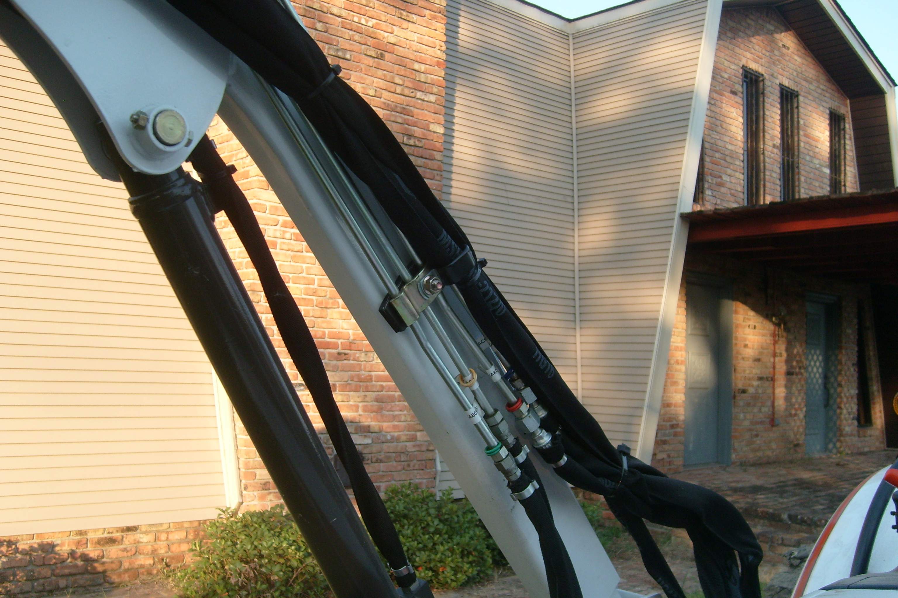

Here are a couple more pics on hoses from front aux the connections are on right side above the quick connects for fel on loader arm pretty neat, added one pic of the dirty tractor as well. had a fun day with it :)
dang, guess it help if I attach pics :confused2:

Thanks for posting the additional pics. Though I must admit I'm even a little more confused. Is the front remote actually a third function instead of an Aux? It seems likes it might be given the wiring and solenoid attached to the FEL. Is there a button/switch used to activate it? Also what is the source for the hydraulic fluid? It looks like it might be in common with the curl function? It would be interesting if it was plumbed as a power beyond type configuration, although I'm not sure if the Bobcat FEL joystick spool supports that.
