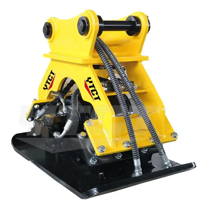

I work as an inspector on water and sewer line projects also a few road projects here and there. The last project I was on, the contractor was using a plate compactor that was attached to a backhoe. It ran off the backhoe hydraulics. It was very effective in compacting the back fill in the 2' wide by 5' deep ditch lines. Something like this may work for you if you can find one. I have run a plate compactor, no fun at all.
