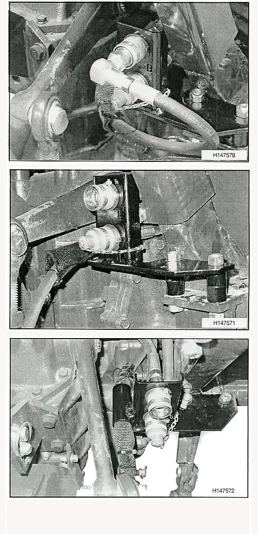

Has any one made a backing plate so that you could make connections to the back hoe on a 2310 easyier???
Pull back push forward with a small quick disconet is not that easy to do.

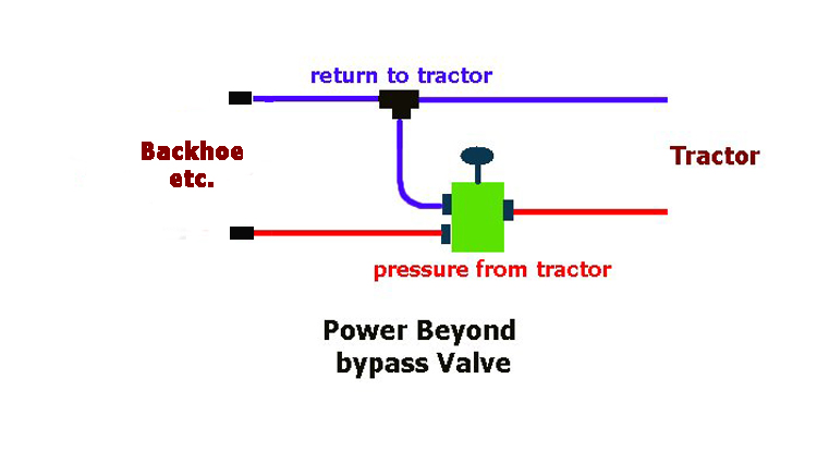

This is intriguing, but I have 2 thoughts:
1. There is no place I can think of to mount the plate.
2. These lines have to be connected together when not attached to the BH,
further exacerbating problem 1. (A simple loop hose would have to be completely clear of the 3pt. hitch at all times.)
Perhaps a diverter valve of some sort could be used for problem 2?

I don't know if it will help any or not, but here are some pictures of the factory PBY bracket that MF uses on larger compacts. If there is any place to mount it, you might be able to order one to use. I'm sure that there would be some amount of modification that would have to be done.

I have installed a diverter to be used like that before. Here is how I did it and the type of valve that I used.
Surplus Center Item Detail

I think this would work all that would be need would be a 12in long hyd line to be used when the back hoe was NOT on the tractor ....

I put a hook on the opposite side axle housing and loop the hoses around it and it keeps the hoses out of harm way. It cost me $1.50 for the hook from the hardware store.
